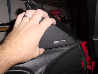

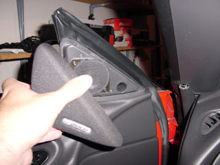

First Step is to remove the tweeter cover from the tweeter enclosure. To do this simply pull on the cover (not the tweeter box), it may require a little force but it will come off. If you’re stuck and the cover won’t come loose it is probably due to the original glue having adhered itself to the tweeter enclosure, so carefully pry it off using a flathead screwdriver.

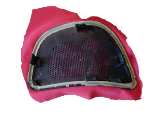

Next, go inside or where ever you have set up shop and carefully remove the original mesh from the inside of the cover.

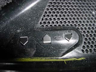

After you have separated the original mesh from the hardened glue remove the MACH 460 Emblem by prying the three prongs (like how you open one of those large manila envelopes). Make sure to keep the Emblem in a safe place.
Now remove the original mesh from the cover. It is held on by a tacky adhesive, make sure not to touch the adhesive because we want to reuse it to apply our new cloth later.
What I did to make things easier was to lay the fabric I bought over the exposed cover and smooth out the front lines before I cut the fabric.
After you have cut the fabric to fit around the cover go back and make sure there are no creases or bubbles. Apply the adhesive to the back of the cover along the edges that was used to glue the original mesh and simply fold over your excess fabric. Make sure as you fold the fabric that you don’t get adhesive on the front of the new mesh and that you continuously pull and tug at the edges to get all of the creases out (the fabric should stretch enough to allow you to mold it around the corners). If you are using the 3M Adhesive I mentioned earlier it will dry quickly, but you will have enough time to reposition the mesh if you make a mistake. Let the cover dry for about 5-10 minutes then reattach the MACH 460 Emblem using a knife to cut out the mesh covering the original holes for mounting the emblem.

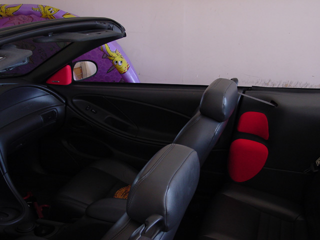

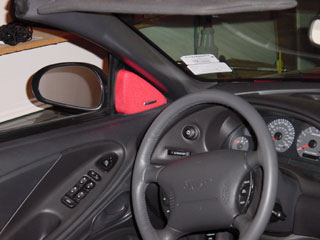

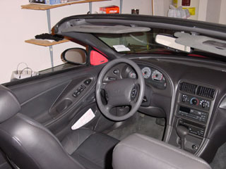

Last thing to do is reinstall your covers and show them off to all of your fellow stangers!
If you own a Convertible Like I do you can also do the same thing to the rear speaker covers. Click Here scroll down to the bottom of the screen and follow the instructions for removing the rear seat and side moldings. Pop out the top and bottom covers and repeat the instructions for each. I found the rear cover far easier to do than the front ones.
