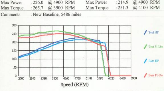

In our never ending quest to raise the caliber of Bullitt #2580, we turned to popular bolt-ons to see how the car responded. In stock trim with only a conical K&N, on Detroit Speedworks MD-1750 dyno, the car put down 226HP/265.7 ft-lbs torque to the rear wheels (baseline vehicle simulation test mode).

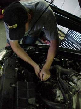

The installation is very straightforward. For each cylinder, simply loosen the single bolt holding it in place using a 9/32 socket (I found that using drive with a swivel and 6-9′ extension works best), and remove the COP (Coil-On-Plug) module. The bolt and module can be set aside for reinstallation after the new plug is in. Remove the stock plugs using a 5/8′ spark plug socket. Before installing the new plugs, there are a few things you should remember;

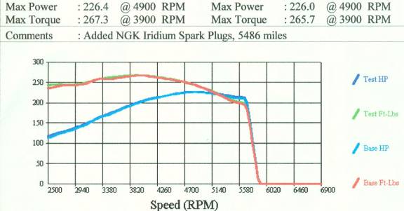

Reading the stock Motorcraft plugs (AWS32P)showed that the engine was in good condition as expected and running evenly cylinder to cylinder. As everything was as expected the NGK plugs were installed. The car was run again on the dyno and showed a .4HP and 1.6 ftlbs gain. The magnified power curve showed that the car was running more consistently throughout the RPM range indicating a more thorough air/fuel burn. These weren,t the gains expected, but still not bad for a set of plugs on a stock car.

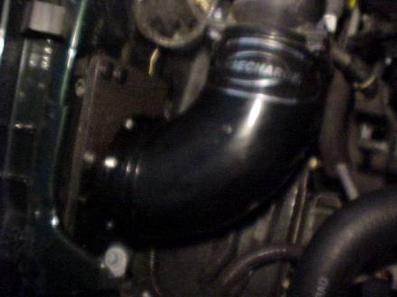

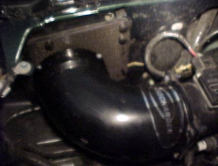

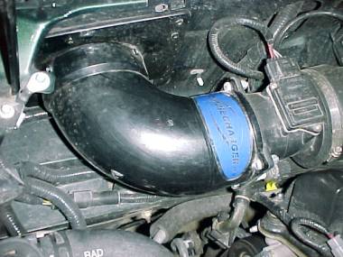

Next went on the Tunable Induction 100mm system. The idea behind the system is simple; more air in equals more power. The system is made up of black ABS plastic to help keep heat of of the intake air. The kit consists of the ductwork necessary to relocate the air filter into the fenderwell in one of two positions, and the ductwork needed to connect the filter to the MAF meter. The installation takes about 10 minutes and can be done with a screwdriver and two wrenches for the MAF flange bolts. The elbow that passes through the fenderwell has a cover plate that gets secured to the fenderwell with 3 sheet metal screws. Drilling pilot holes for these to pass through (see arrows below) take about half of the overall installation time. (For a complete .PDF format installation guide, click here)

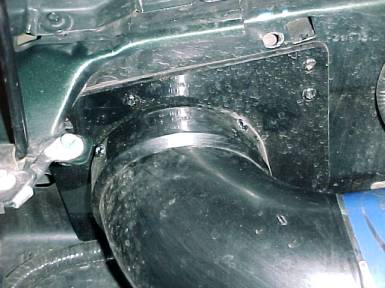

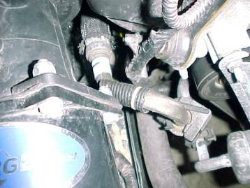

The instructions call out watching for clearance of the flange. In this car, the clearance looked good, but I installed the supplied protective cover anyway (see blue arrow at left).I knew going in that modifications like this were hard to test on the dyno. Ram air and cold air systems that relocate the air filter really need the car to be moving to show their full benefits. While sitting on the dyno, I didn’t know what to expect. The car was started and cycled a few times on the rollers to allow the computer to adjust. On the next run, I couldn’t believe that it was my car on the dyno still as the new sounds coming from the engine compartment above 4,000RPM were incredible!
The car gained 2.4HP and the torque peak moved from 3900 to 4100 RPM, but remained unchanged. We unstrapped the car and I decided to get some street time on the mods before going any further. Over the next few days is were things really got interesting. After about 3 days, the car felt like it woke up from a nap. Power felt up and the car was much more responsive. Could we get any of this power to show on the dyno though? After cycling the car several times and doing a few more pulls, the results were the same. The dyno peaks refused to climb.

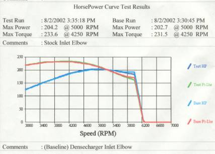

Back on the dyno, a new baseline was established before adding any new parts. Given the above gains, I was expecting around 229HP. As the wheels turned the rollers, the dyno only read 202.7 HP. The car was down 27HP! Since my dyno time was limited I decided to continue on anyway.

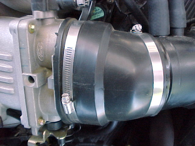

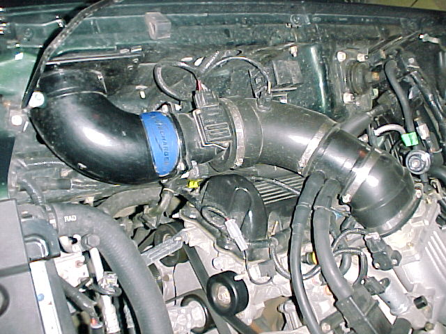

The next part to be added was the TunableInduction throttle body tube. The tube is the same 100mm throughout as the rest of the TunableInduction system. As you can see on the stock TB tube, there is a restriction to allow for clearance for a strut tower brace. The early SN-95 cars had one, but the Ford penny pinchers decided that better handling and chassis strength weren’t worth the extra $5 a car they probably paid for it. The ‘dent’ in the TB tube remains today so Ford doesn’t have to pay to have a new tube mold made. So, what is the HP cost of the dent?
To find out we started installing the Tunable Induction tube. The install is fairly straight forward, with only hose clamps holding in the stocker and the Tunable Induction tube.
The vacuum lines attached to the stock tube may need to be trimmed slightly to fit the new fittings. The stock air charge temp sensor can be swapped directly over to the newtube. See the install notes below for some tips to help you along.

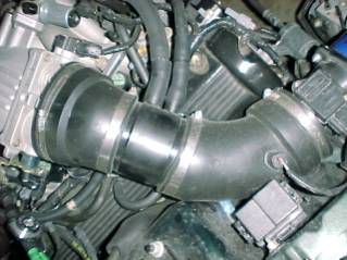

Watch the tube to strut tower clearance. If not adjusted properly, it could rub and create a loud squeakBe sure to re-check the MAF flange clearance to the A/C line after installing the TB tube. It may have shifted slightly when pushing the TB tube on.
Also, check the tube flange (at the MAF meter) clearance to the cam cover

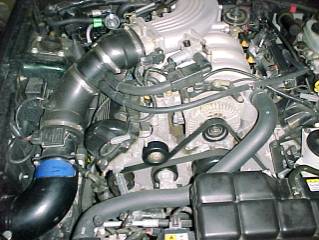

The tube when installed should look like this.

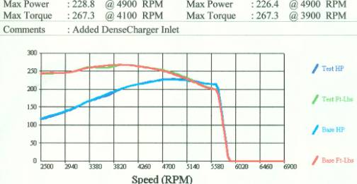

Once the tube was on and adjusted properly, the car was running again. The tube added 1.5 HP and 2.1 ftlbs peak to peak. As you can see in the graph above, the curves are almost identical with the TunableInduction bettering the stocker more as the RPM’s climb. At 6000 RPM there is an 8HP difference. The G-tech results were 228HP in this configuration averaged over 4 runs.

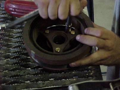

The March crank pulley is a piggy-back design. What this means if that the stock pulley/damper setup, once removed from the crank is bolted onto the front of the new pulley. March does off an aluminum damper which allows complete removal of the stock set-up and frees up some rotating weight.
The pulley kit comes with all new hardware needed for the swap. The installation is actually quite simple. After the belt is removed by loosening the tensioner, the stock pulleys can be removed. I recommend doing the crank pulley first, as it takes the longest. Once the stock crank pulleys bolt is removed, throw it away. Not only will the stock bolt be too short to re-use, it is a torque to yield bolt that is unreliable when reused. March supplies a new longer bolt. After the bolt is removed, you’ll need a pulley puller to remove the stock pulley. Once it’s off, you can begin the assembly of the new 2-piece set-up.
The instructions are quite clear on how to do this, and as you can see at the left, it is just a matter of bolting the stock pulley to the face of the new crank pulley. The only thing to watch is to make sure the keyways are lined up on the two pulleys. Once they are assembled, use a bit of silicon on the keyways to help seal it against leakage and reinstall the assembly.The water pump pulley is only held on be four bolts. It’s a simple matter of removing those and installing the new pulley.

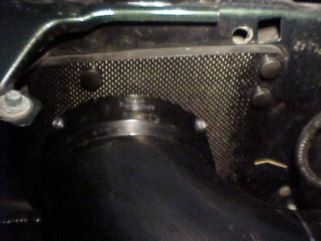

TunableInduction now also offers an appearance upgrade kit that comes with the fender plate made out of carbon fiber, covers for the plate screws, a strip of carbon fiber for the pipe. With this dress-up kit installed, the kit is in a league of it’s own. See pictures below:
