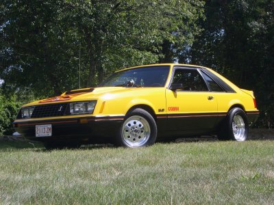

Home arrow Featured Rides arrow Pete's 1979 Cobra
Pete's 1979 Cobra PDF Print E-mail
User Rating: / 12
PoorBest
MODS
Engine:
1988 302 block, internally balanced, bored .30 over and decked to create a 10:8:1 compressioned 306
Keith Black hypereutectic domed pistons
Elgin Pro Stock solid lifter cam 248 INT/258 EXH @ .50, .536 INT/.560 EXH lift
AFR 185 aluminum cylinder heads (58 cc?s)
Competition Cams roller rockers
Screw in studs, guide plates, hardened pushrods
Edelbrock aluminum dual quad intake manifold
Two Edelbrock 500 cfm carburetors
Edelbrock chrome air cleaner
Summit Racing aluminum valve covers
March under drive pulleys
Fluidyne harmonic balancer
Horsepower: 307 rear wheel horsepower/278 rear wheel torque
Performance: 12.40?s-12.80?s @ 107-110 mph (Best is a 12.42 @ 109 with a 1.64 60?)
Ignition:
MSD 6AL Ignition with soft touch rev control
MSD Blaster Coil
MSD Billet Distributor
Exhaust:
Mac 1-?? Long tube Headers
Mac 2-?? Off road H-Pipe
Mac 2-?? Cat-Back Exhaust with chrome tips
Transmission:
Tremec 3550
Pro 5.0 Shifter with stock original ?79 shifter boot and stock ?90LX shift knob
Centerforce Dual Friction Clutch
Steeda 3-piece adjustable clutch kit (cable, quadrant and firewall adjuster)
Ford Motorsport aluminum driveshaft
Rearend:
1990 Mustang LX 8.8
Ford Motorsport 4.30 gears
Detroit Locker No-Spin unit
Superior 31-spline axles
Suspension:
1986 Mustang GT K-Member
Energy Suspension polyurethane engine mounts and transmission mount
PST polyurethane bushing kit for the entire front cross member section and sway bars
Competition Engineering 90/10 front drag struts and 50/50 rear drag shocks
Ford Motorsport ?B? springs
Air Lift rear airbag kit
Southside Machine lower control arms
Steeda adjustable upper control arms
Kenny Brown sub frame connectors
Braking:
1986 Mustang GT braking components (10? front rotors vs. the original 9? units)
Cooling:
Ford Motorsport 3-core radiator
Interior:
Factory Black interior
Autometer 5? tachometer
Autogage 2? oil pressure, voltmeter and water temperature guages in custom fabricated guage panel
Grant Carbon Fiber steering wheel with billet aluminum spokes
Sony X-Plod in dash CD player
Exterior:
2001 Nissan X-Terra Yellow (PPG urethane Basecoat/Clearcoat painted by Scott Lockhart of East Bridgewater, Massachusetts)
2001 Satin Black
Original type decals reproduced by www.Phoenix Graphix.com
Awards:
2004 Awards
April 2004-(2nd place) at the Shelby Mustang Meet, Mustangs Unlimited, Manchester, Connecticut
June 2004-(Most Popular) at the MCCNE Spring Round Up, Mustangs Unlimited, Manchester, Connecticut
August 2004-(Editor's choice from MM&FF Magazine/Saturday) at Fun Ford Weekend, New England Dragway, Epping New Hampshire
August 2004-(Top 25/Sunday) at Fun Ford Weekend, New England Dragway, Epping, New Hampshire
September 2004-(1st place) at the Wheels of Time annual car show, Brockton Fairgrounds, Brockton, Massachusetts
2005 Awards
April 2005-(1st Place) at the Shelby Mustang Meet, Mustangs Unlimited, Manchester, Connecticut
July 2005-(1st Place) at the Mustang Car Club of New England's annual summer show, Rodman Ford, Foxboro, Massachusetts.
August 2005-Muscle Mustangs & Fast Fords Magazine feature page 170-173.
December 2005-Modified Mustang Magazine page 147. Small picture of burnout and small paragraph.
December 2005-Four Eyed Pride's 2006 calendar (June 2006).
2006 Awards
July 2006-(1st Place) at Tasca Fords annual summer show, Tasca Ford, Cranston, Rhode Island.
This car was built by my twin brother Paul Slaney and myself during a 4 year period (2000-2004).
