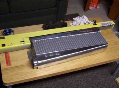

    The intercooler – For this project I used a Treadstone Performance BMV25-O Intercooler.  I used the vertical style intercooler because my research told me that these type intercoolers flow air better and loose less boost.  I was extremely pleased at the cost and performance.  I lost less than 1 lb of boost and the cost was more than easy on the pocket.  I spent roughly $350 and feel it’s the best bang for your buck.  I actually purchased an Ebay intercooler and it was poorly built, dented, and the customer service was not up to par.  I have spoken to Treadstone Performance and still communicate via email with them about the intercooler.  They are very easy to work with, which goes a long way.

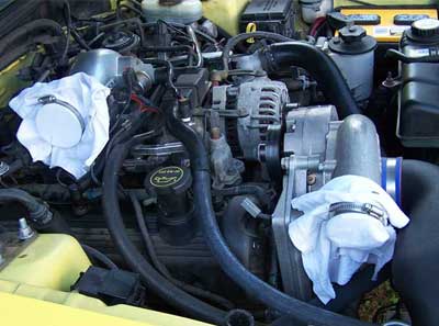

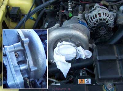

4.    To re-clock the supercharger, you need a shortened Allen-wrench.  I found the correct size and used my Dremel to cut down the insert end, leaving about ¾” left.
5.    Using the newly cut wrench, unscrew all the bolts from the supercharger and remove the brackets that the bolts were holding.  This should free up the unit and it should turn freely
6.    Turn the supercharger unit counter-clockwise until facing towards the bottom right of the engine bay.
 Vortech Intercooler install Ford Mustang
7.    Re-install the brackets and bolts, leaving the bolts loose so the unit can move freely during mock fabrication.

9.    I wanted a clean installation of my intercooler.  Besides, you want to show of what you did right?  With the bumper support in my basement, I help up the intercooler to the bumper support and used a market to outline my cuts.  Using my Dremel, I cut the area that I marked with my market.  It took roughly 20 blades to cut the steel so do not be worried that your blades wear quickly.
(Caution:  Use eye goggles and mask.  Metal fragments will be in the air during cutting and the fumes will make you pass out quickly.)

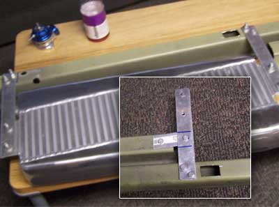

10.    I went to Home Depot and pick up some thick bolts and nuts, along with some aluminum bars to use as supports.

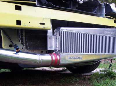

11.    I cut the aluminum bars to bolt on to the intercooler, and bolt on to the support beam.  Using a drill, I drilled the marked holes and bolted the intercooler to the bumper support.
12.    I found after installing the intercooler that the aluminum was flexing and allowing the intercooler to sway.  I cut a horizontal piece of aluminum and bolted that to the support beam to prevent flex.
(Note: Depending on your installation of your intercooler, you may need to cut down your bolts to allow the support to be bolted on to the car.)

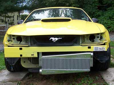

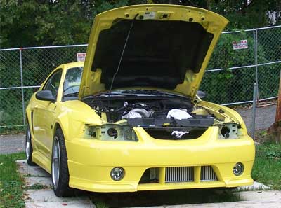

13.    Mount the intercooler in place.  Put the bumper back on to make sure you have enough space to route pipes, along with making sure the intercooler is level attractive.  I had to lower my one end about 1” to make it level so it may take a few tries.
(Note: Drill multiple holes in your aluminum to allow for various heights.  That way lining up your intercooler with your bumper is a matter of moving the bolts down or up a hole.)

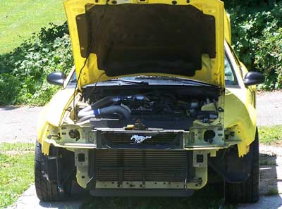

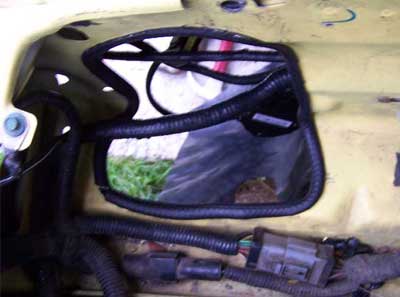

14.    With the intercooler in place, take the bumper back off and start to eye up where you want your pipes to run.  I ended up opening the area where the air intake is to allow for more pipe.  I felt I would rather keep the pipes straight, than use a lot of 90 degree bends to fit everything.  I used a 3” hole saw to cut the new area.  Then I used a Dremel to make everything nice and pretty
15.    Get some ¾” fuel line and slice the one side, insert it in the area you just cut.  This will allow you to lay pipes on it without cutting the surface of the pipes.  Trust me, if you want to paint your pipes you’ll thank me.  If those pipes move on the freshly cut metal, you’ll be re-painting it again

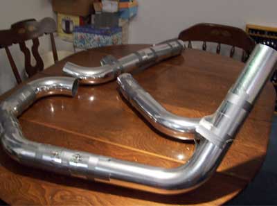

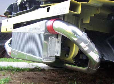

16.    Carefully cut sections of tubes and mock up your lines.  Start from the supercharger and work to the intercooler, then from the intercooler to the throttle body.  Remember everything is based on angles.  If your supercharger is pointing 70 degrees down, and your intercooler is level at 0 degrees, you will need a 30 degree bend to make it level with your intercooler, than two 90 degree bends.  The rest is just cutting your straight pipes to make it fit.  If you think it that way, your fabrication will go a lot easier.
17.    Using duct tape and a black marker, secure your pipes and make 2 lines for each pipe.  Then reinstall your pipes to confirm your fitting is correct.

21.    Double check all your connections, and fittings, and take it to get TIG welded.  The welding will ensure you don’t loose boost because of crappy connectors, and will look a lot better.  Ask your welder to make a lip, or dimple the ends of each pipe so they stay in the pipes under high boost.

24.    Double check all your connections and start the car up.  It may idle a bit funny so don’t be worried.  Check for boost leaks or bad connections.
(Alert:  Do not get overly excited and rev the car.  The car should never see boost until it is tuned)
25.    Take the car to the tuner to get tuned.  Have them double check all your connections, and installation.
