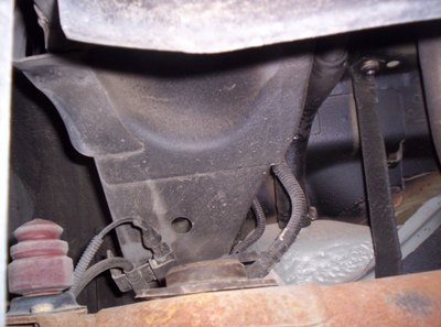

Step 3. I chose to start with the rear, as no special tools or steps are required. Remove the brake line bolt found in front of the axle, attached to the inner wheelhouse using a 10 mm socket. See the picture below for exact location.

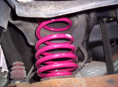

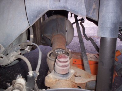

Step 7. Pull down on the axle housing while pushing up on the spring. It may be easier if you use your body weight to pull on the axle, while pushing the spring up and out. You need to lift the spring, so it will clear the lower spring perch. Pull the spring out. Below are two different angles of the spring perch.
S197 Ford Mustang Lowering Spring Install

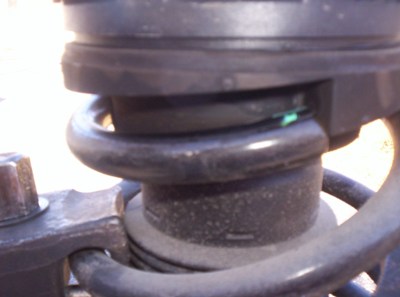

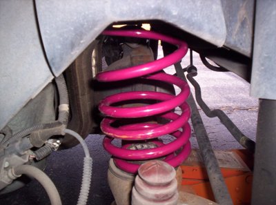

Step 8. Make sure the rubber coil spring isolator is still on the axle spring perch. Using the same method as removal, install the new springs into the perch. It is easier to put the top of the spring in first, and then try the bottom. Make sure you clear the upper spring perch, as shown in the pictures below.

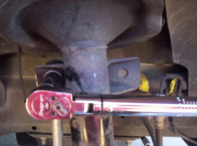

Step 11. Reinstall the shock and brake line bolts. Torque them to the factory specs. Step 12. Moving to the front, remove the brake line bolt located at the lower inboard of the strut, using a 10mm socket. Remove the nut for the swap bar stabilizer link, using a 18mm socket. This is located just below the spring. Also, unclip the wiring from the lower rear of the strut. It is just a Christmas tree style clip and pulls straight out.

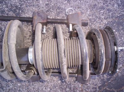

Step 16. Install the spring compressors on the coils of the spring as close to the top and bottom as you can. This allows the spring top compress enough to remove the spring. If you put the compressor in the middle of the springs, you wont be able to compress the spring enough to relieve the tension. They should be installed on opposite sides of the spring, to evenly compress the spring. Failure to do this can cause the spring to come out of the tool, causing injury or damage.

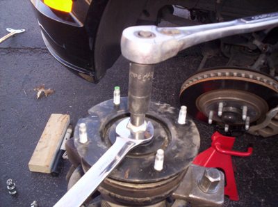

Step 18. Compress the new spring, making sure you have enough room to remove the tool after you install it on the strut. If you are too wide, you wont be able to remove the tool from the strut assembly. Once the spring is compressed, install it on the strut, along with the dust shield and upper mounting flange. Tighten the upper nut. You will most likely need to use a wrench on the nut, and also hold the stud to keep it from spinning while you tighten the nut. Make sure you installed the upper mounting flange the same way it came out. Check the arrow and the notch.

Step 21. Reinstall the stabilizer link and nut, the brake line bolt, and clip the wiring into place. Torque the fasteners to the factory specs. Don’t forget to torque the upper strut mounting nuts in the engine compartment as well. Remember, torque values should be read at ride height, with a loaded suspension.
