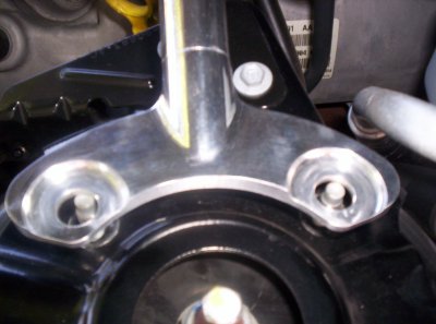

Driver's side fitment:
S197 Strut Tower Brace installation

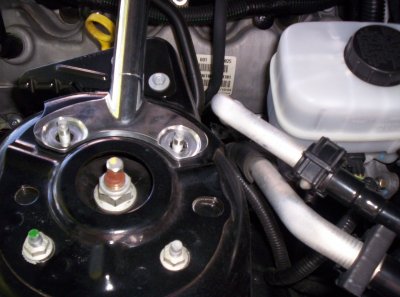

Washers in place:

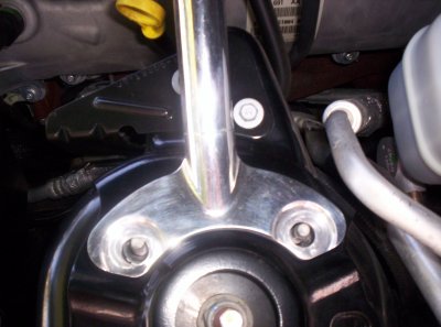

Passenger side fitment:
Passenger side installation:

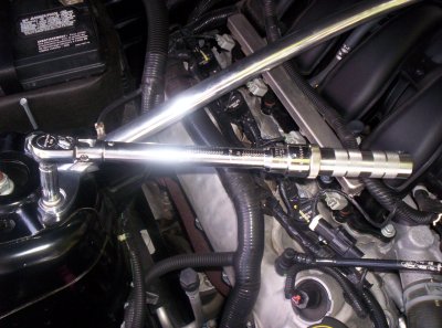

Applying torque (25 lb-ft) to the nuts:
