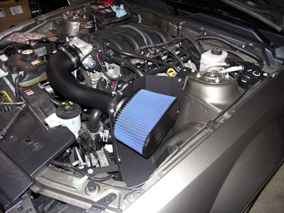

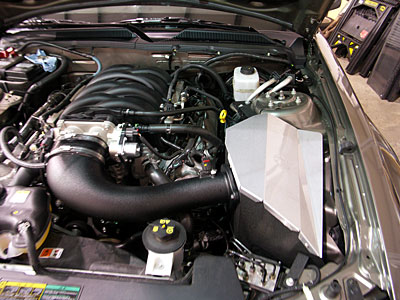

We then placed the powder coated air filter housing in the engine bay. Not only does the housing look great but also it serves as a shield blocking hot air from the engine. The housing is secured using the factory rubber bushings and screws. The specially rotomolded air intake tube bolts into the housing and connects to the urethane coupler. We then transferred the MAF sensor to the intake tube, installed the provided spacers, and tightened up all of the bolts.? The aFe tube is specifically designed with all the correct parameters and placement for the MAF sensor so that the computer is not effected and no codes are thrown and drivability remains true.
The pre-oiled air filter was then installed into the housing. The filter is reusable and washable.
After the filter had been installed and tightened properly we bolted the brushed aluminum housing into place. Once we had finished installing the aFe kit we checked all of the bolts and electrical connections to ensure that they were installed correctly. With the aFe kit installed it was time for some real world testing.
