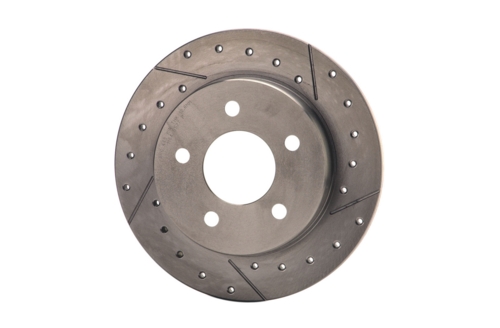

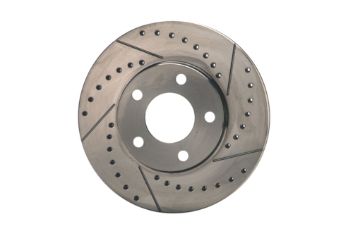

FRPP offers some for 99-04 Mustangs
Front M-1125-A:
Click the image to open in full size.
Rear M-2026-A:

I think the rotors I posted from FRPP are safe they are probably cast. I would not use eBay drilled rotors myself. Also, as was said, these fancy rotors are for looks only pretty much. If you are looking for max braking and durability then the ones like rjstaff posted are the way to go.
