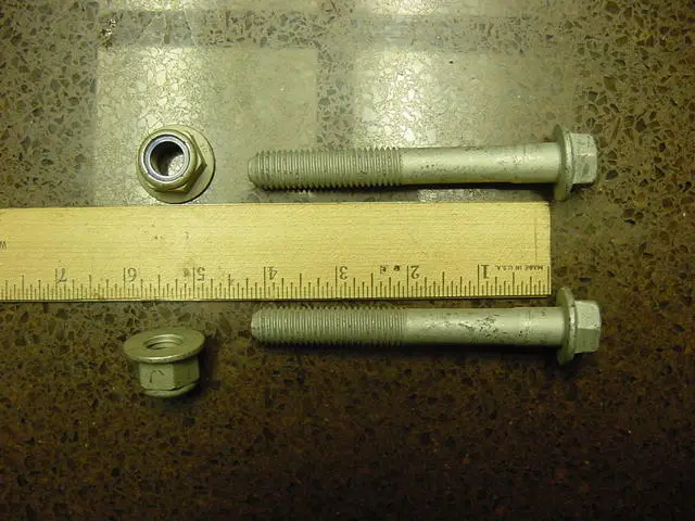

    FYI, Here is a pic of these (2 of them) $18.00 bolts/Nuts. They are 10.9 grade, I assume that is what the 10.9 on the head means...
    John
