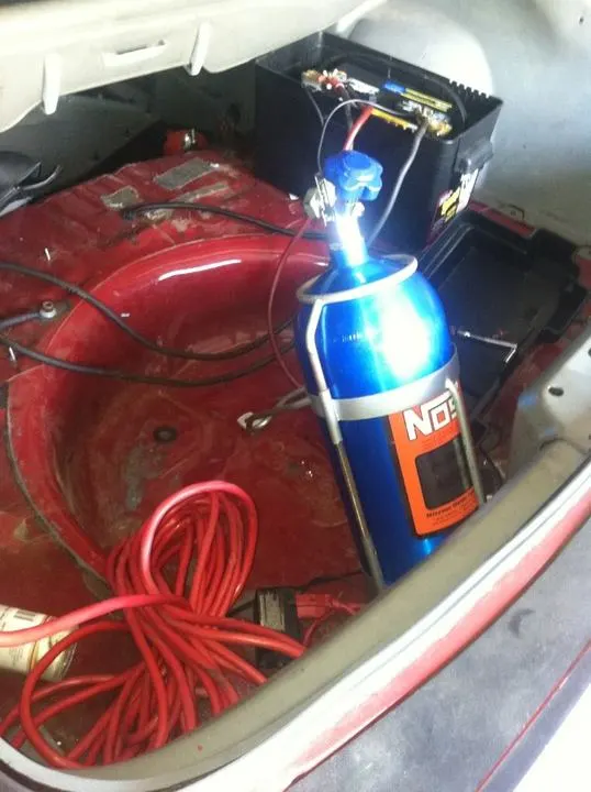

  3. Bottle mount

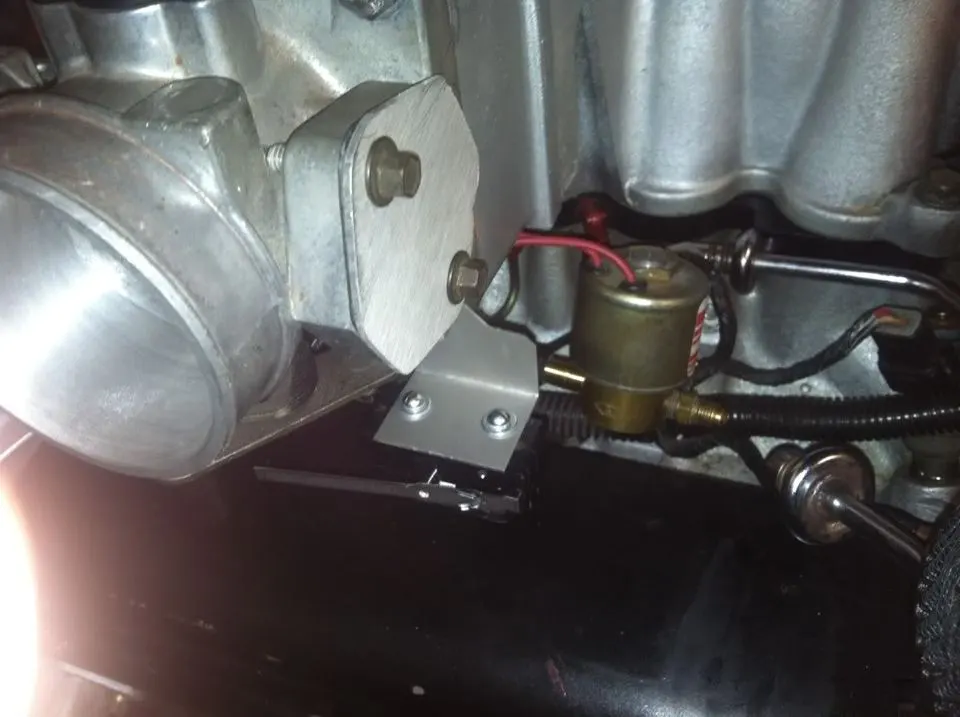

    Started on the mock up. Really can't go to far with this till I get the purge solenoid
    Working on bottle placement still. Think I'm going to make a seat bracket that bolts in place of the passenger seat and put the bottle there

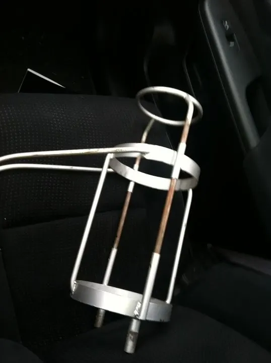

  7. Is that a homemade bottle bracket? Kinda neat.
    Joe
  8. Not sure... It's the old one out of the race car. I'm not a fan of the standard mount.

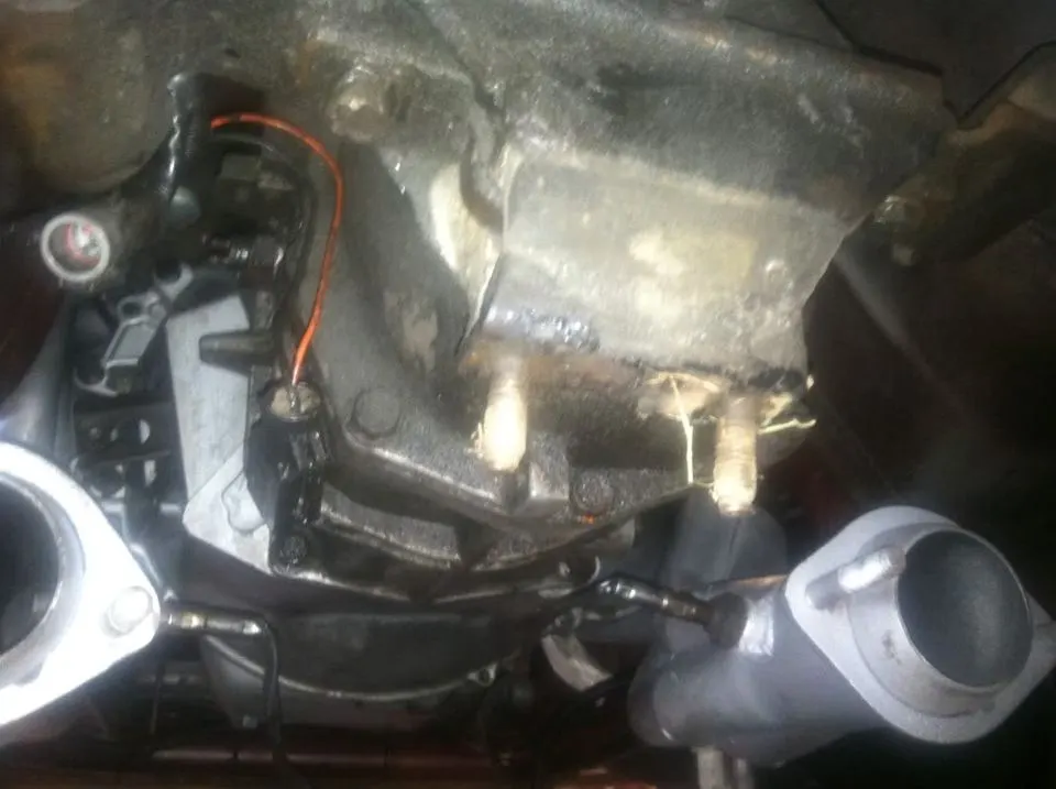

    Was going to clean up the case but I didn't have any brake clean left and I'm sure it's going to be coming out soon. Wanted to take it out for a test spin but I seem to have missed placed the shifter bushing
