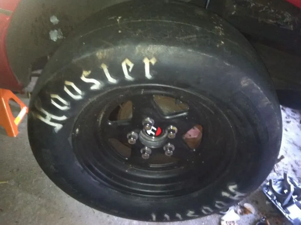

    Welds and slicks are bolted up! She will be off the jack stands tomorrow to do some tweaking

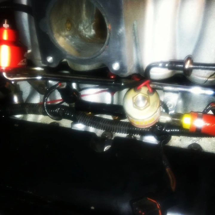

    well i got the stalling fixed... the IAC is back on the car. has a slight stumble at part throttle to work on. started putting the nitrous stuff on it friday night and broke the front upper intake tab off it. going to work on getting that fixed now. i believe the lines to the plate kit are keeping the intake from sitting flat.

    Wonder what that black plate does???

    Porting the SN95 MAF without enlarging the "sampling tube" will cause the engine to run leaner and that could be the reason for the stalling issues.

    think it was just causing it to go lean and the idle raised up. but its gone now.... i did the same thing with my 95 when i had it and never had any issue. oh well
  18. Cobra912

    those painted or powdercoated wheels?

    plastidip... they were done before i got them. not a huge fan of it but it can stay for now
