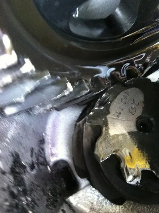

    haha you and i both. we broke the ring and pinion friday in the race car so we've been at the shop ditching the drop out 12 bolt center section for a true 9" center section. should have some time tonight and thursday morning to work on my car. it starts and runs fine i just need a free night to finish all the nitrous panel install and the purge line. basicly a ton of wire to run and a line to glue in

    Who's gear set? Was it lightened?

    richmond pro gears lighten spool strange ultra case ceramic bearings... all that good stuff. had gun drilled star flanges 40 spline axles already.

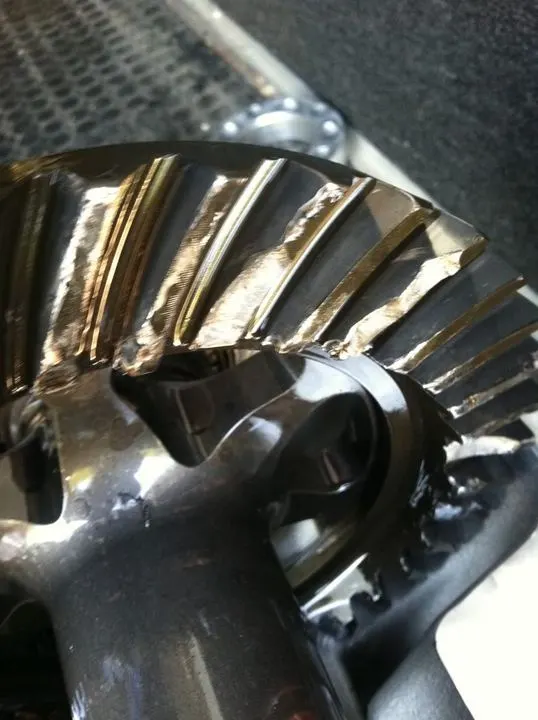

    the broken ring and pinion

    what would cause that? I would think if you had something go bad back there that all the teeth would be affected your pics look like its only a few here and there.

    not really sure if they were street gears or pro gears. if they were street gears they are a harder material and they just crack when hit with that kind of power. if it was a pro gear it was just over powered. they were 12 bolt gears
