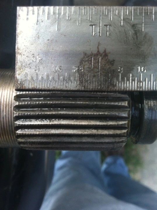

  13. Just pulled the diff out the one cone is completely trashed. So it's getting welded this week. Should be back to track soon
    hopefully i can get 2-3 more passes out of these
    the passanger side that has been spinning from the burnt diff the splines are perfect!
    i have 4 more axles in the garage but i cant run the radials with them since it will have the rear back to SVO width. so i could drive it just not race it.

  17. Me??? Never... Yea stock ranger axles
