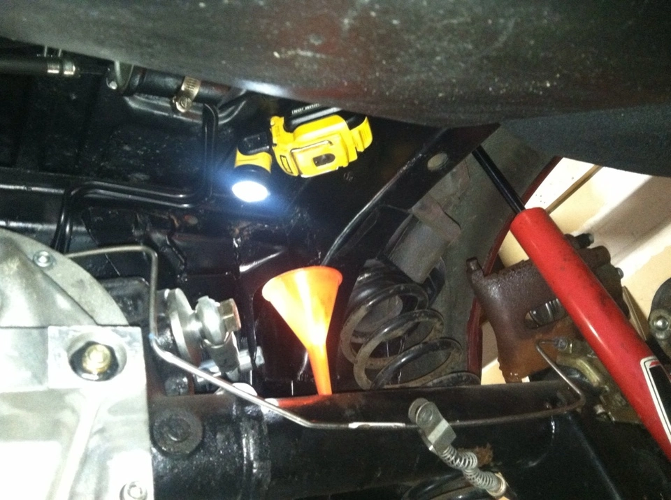

My rear won't hang low enough for some reason to fill using fill hole in girdle
Three words: fluid hand pump.
do not use the fill hole in the girdle, use the fill hole in the housing. the fill hole in the girdle overfills it and gear oil will be coming out every orifice of that **** if the vent doesnt blow it all over the underside of the car first.

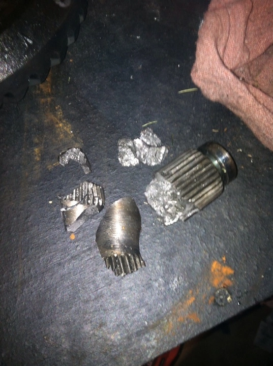

Did it yank to one side when it let go?
Im scared Ill share the same fate when I go in a couple weeks.
