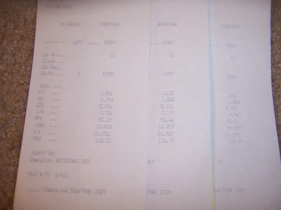

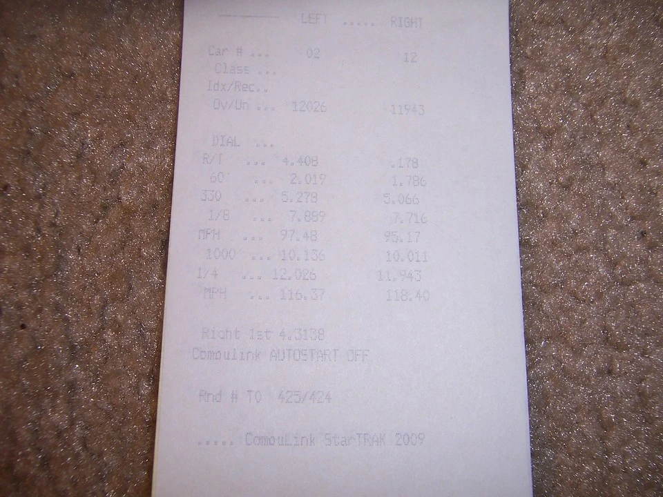

11.94 @ 118.40 mph with a 1.78 60'!!!!! I'll be happy for the next month!
And a few more to back it up:
Track: Rockingham Dragway
DA: -700 feet
Mods: PI motor, SVO blower with 3.3" pulley (8 psi), MHS stage II NPI blower cams, AIS methanol injection, K&N drop-in filter, 75 mm throttle body, offroad Prochamber, 2-chamber Flowmaster catback. Done on Nitto 555R drag radials at 28 psi, on a Bullitt suspension.
And most importantly, a kick-ass tune from Eric at Piedmont Custom Motorsports! This is the same tune that made '335' rwhp when he tuned it. Once again, the SVO blower strikes at the track where it actually matters!
Oh, and this was on the stock auto transmission (minus J-mod), stock converter, stock 3.27 rear gears, and very little weight reduction (spare tire, jack, and passenger seat).
