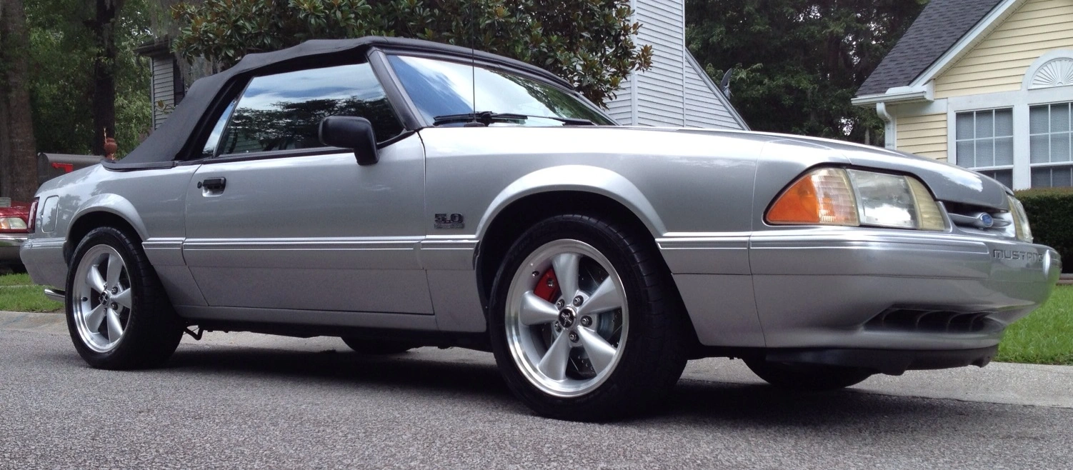

    I'm running 17X8 bullits on my 91 vert with no issues. I have 98 Gt Spindles and Cobra brakes. It did rub in the front but I installed the limiters and fixed the problem. I've been running them for over a year with no issues. It does shrink your turning radius but I can live with that much better than rubbing. Cost is pretty cheap and installation is a snap. Takes longer to jack the car up than it does to install them. Good luck. MUSTANG-7-27-13_2.JPG
