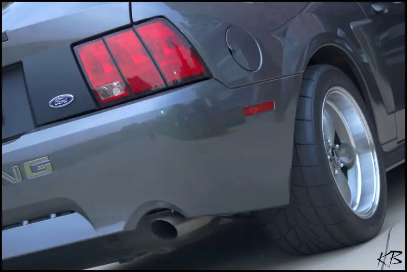

Where did you find 18X10.5's? I thought they were all 18X10. Anyways, it isn't the backspacing that is pushing the wheels out it is the offset. You need to find out what the backspacing on those wheels is. I bet they are around 22-24mm. If that is what they are, that is why they are sticking out. For an 18X10 or 18X10.5 wheel, you need them to be more than 22-24mm. The larger the offset, the more the wheels will sit in.
AFS makes them i believe the the numbers are: +27mm offset with 6.9 backspacing. Those numbers are from there website and I'm not 100% sure they are AFS since I'm going by what the local seller told me, how do I measure them to make sure?.

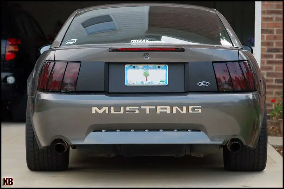

So I bought some 18 inch Cobra wheels (fronts are 18x9 and rear are 18x10.5). On the front I have 265/35/18 and they look good so no problem there.
On the back I have some 335/30/18 tires. They fit fine with no rubbing however I thought they would flush with the fender and they don't like I had seen in some pics). Its not the tires since it looks the the wheel sticks outs no matter what. I thought that 10.5 wheels would flush . Is my only choice to do downgrade to a size 9 inch wheel?
Also i figure 18 inch wheels would cover my gap more but they don't (see pic) ..Currently running eiback pro sport.
Here are some Picks.
