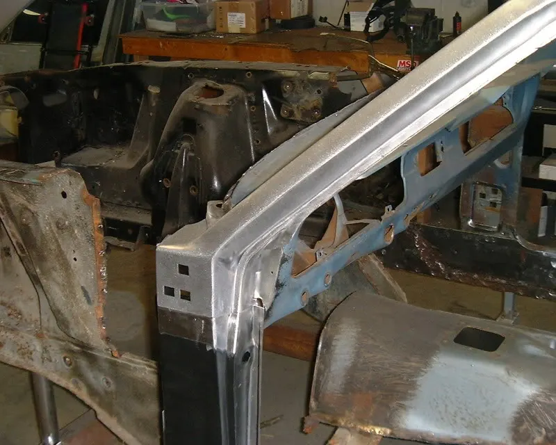

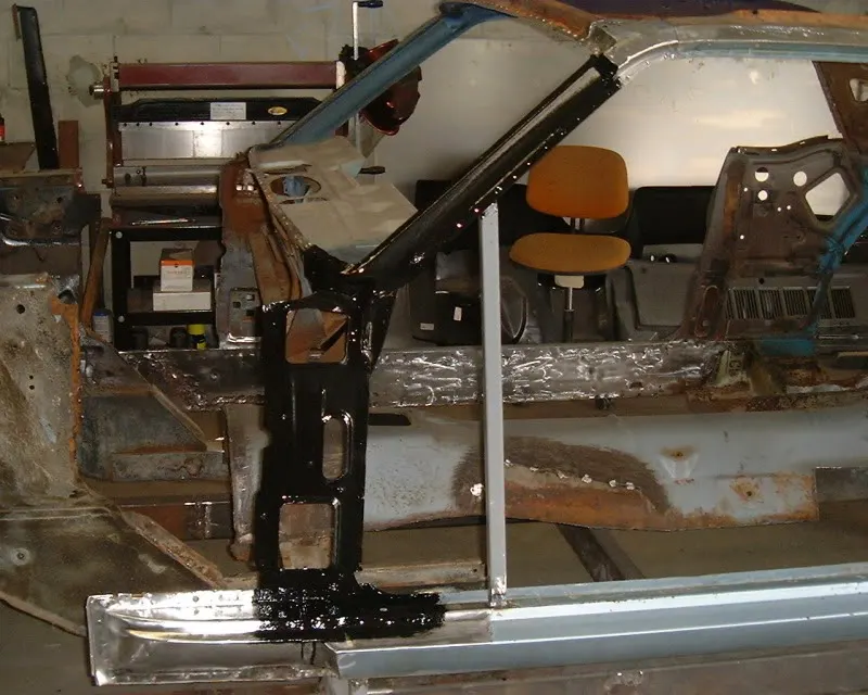

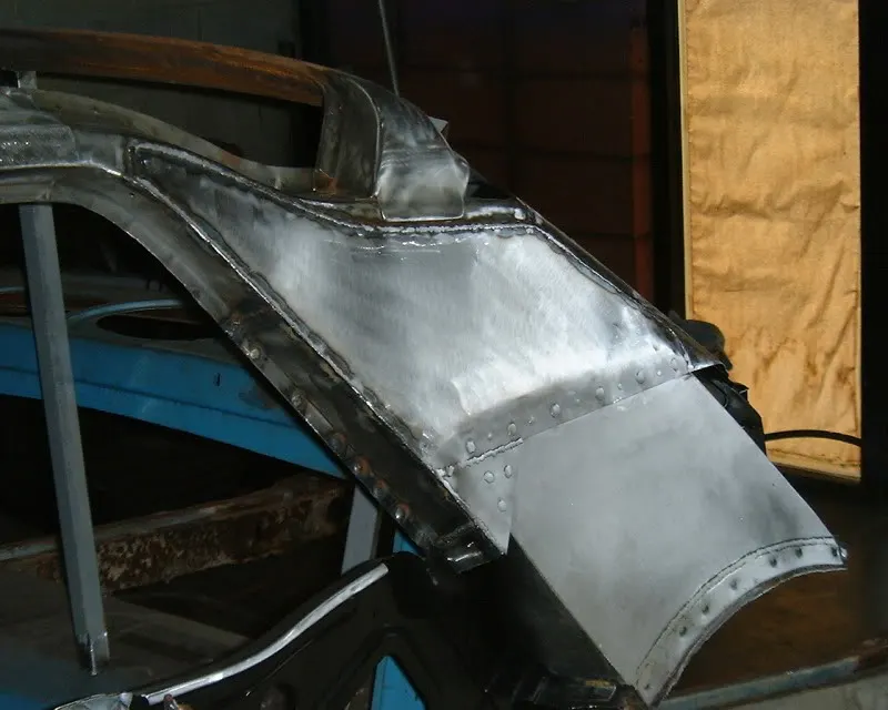

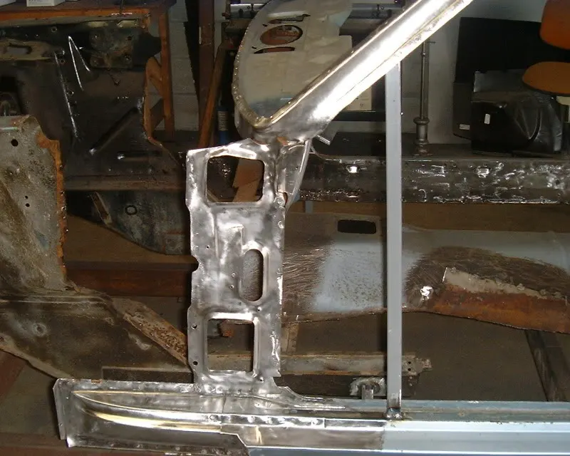

    Brian removed the outer A pillar sheetmetal than sanded and epoxy primed
    The first new metal welded to the A pillar

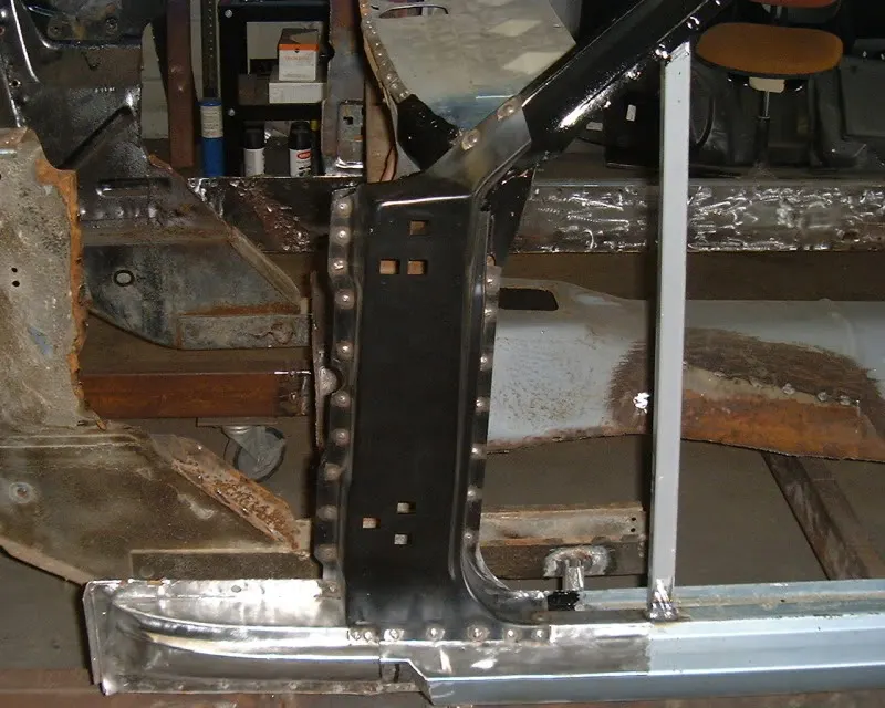

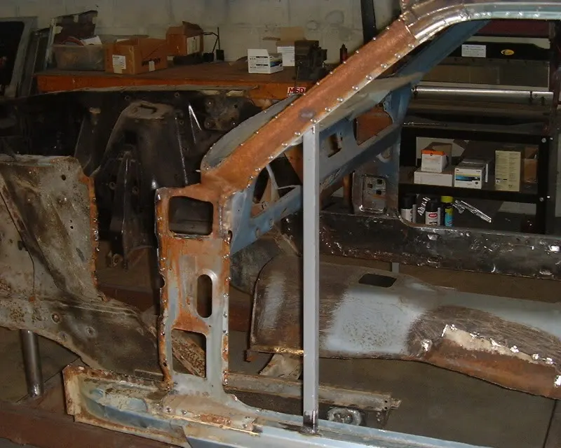

    Brian finished making patches on the windshield post

    Hey fellas great work saving these rustangs. I got a quick question regarding epoxy on the interior of the pillars. When you are welding the new outers do you remove the epoxy where the spot welds are, or melt through it?
    Thanx, and Keep it up

    Yes he cleans up the area before he welds

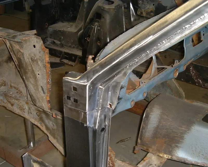

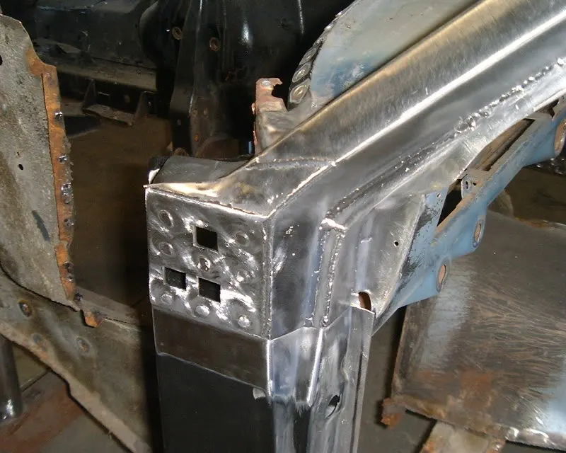

    Brian cleaned up his welds on the windshield post

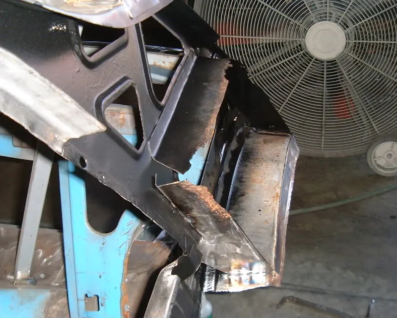

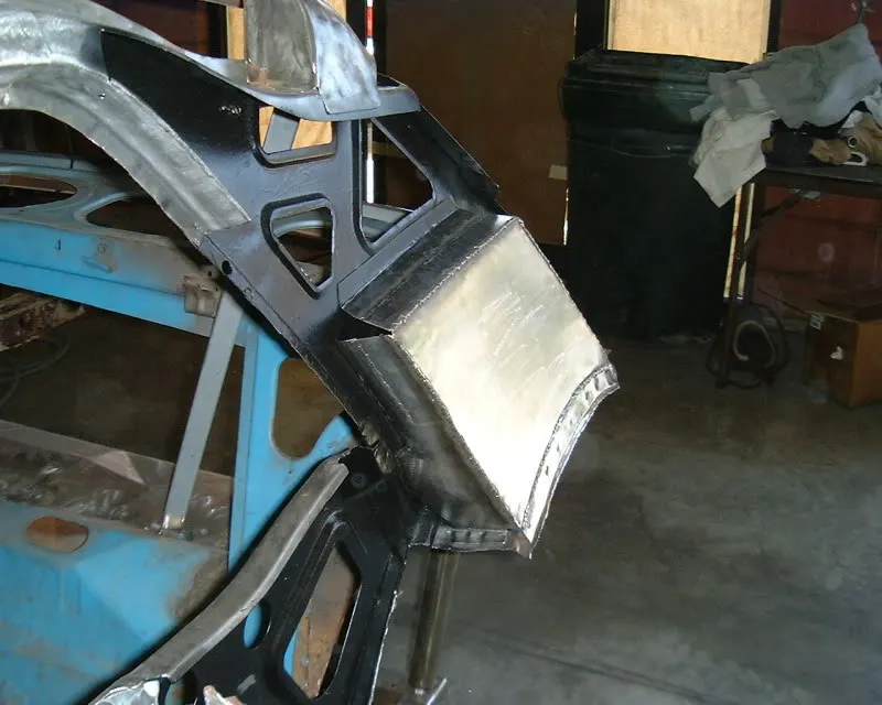

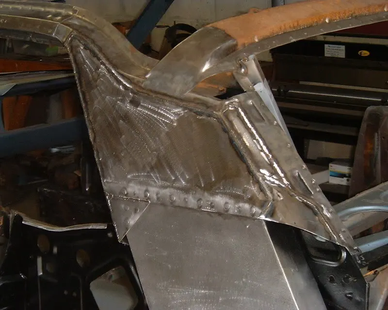

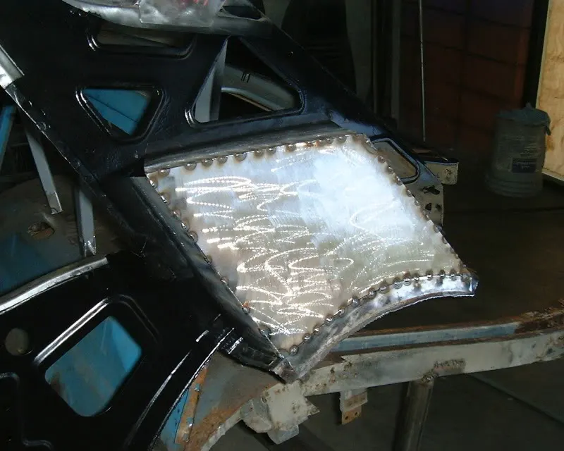

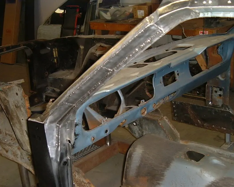

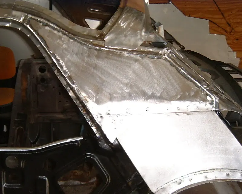

    Brian is rebuilding the inner sail panel structure.
    He started by reattaching the old pieces
    He cut out the rust areas than fabricated new pieces before he added the cover to the box

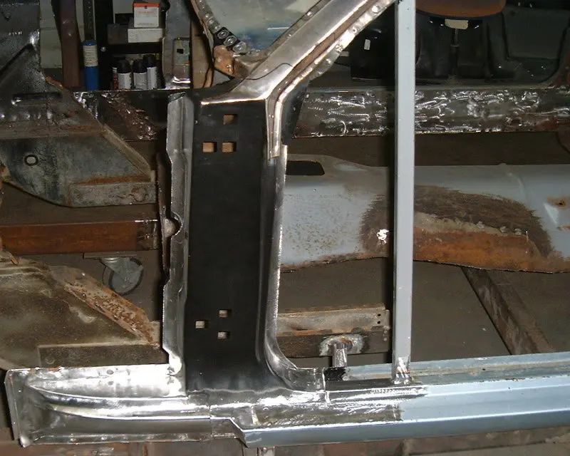

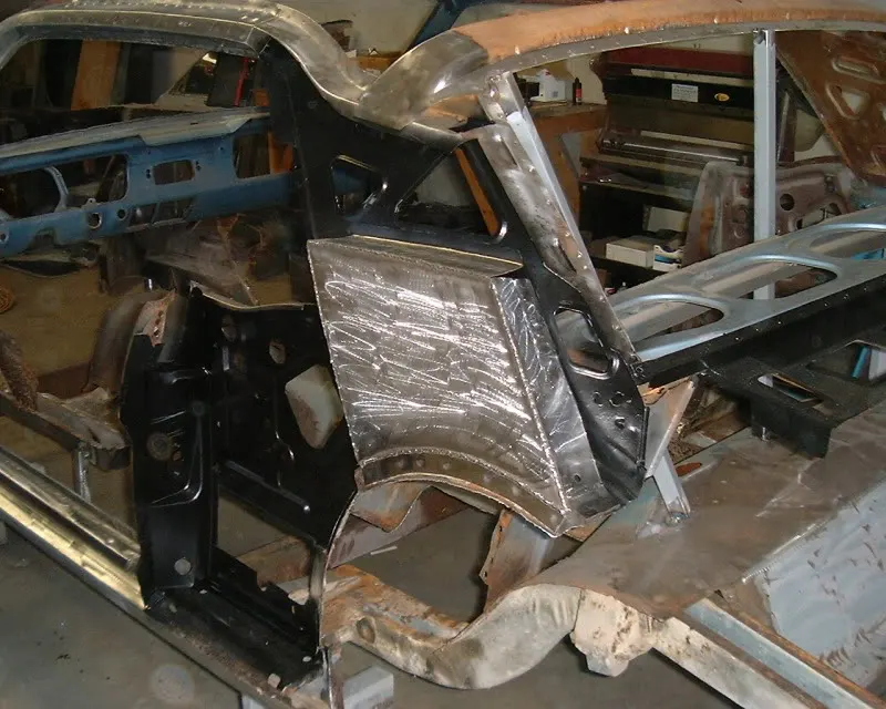

    Brian finished the sail panel inner structure just needs to clean up the welds.

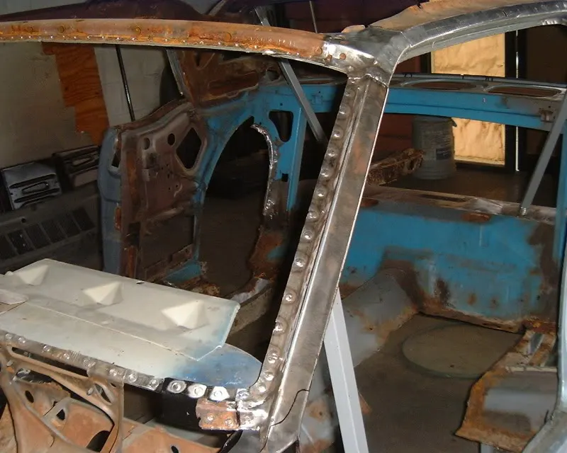

    Since you are working in the area, do you do anything special to reinforce the quarter panel where it tends to tear just behind the quarter window?

    I will have to give that some thought.

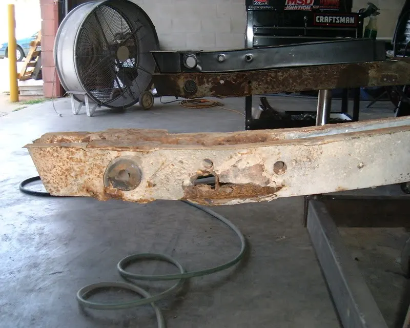

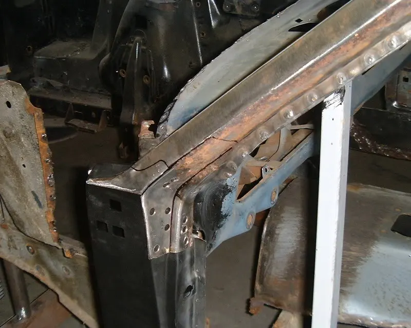

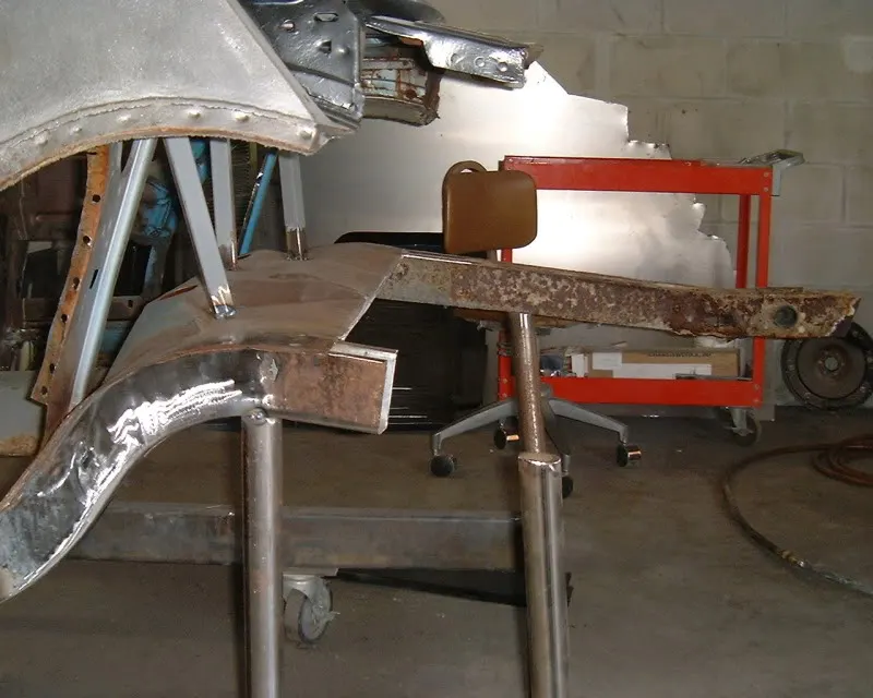

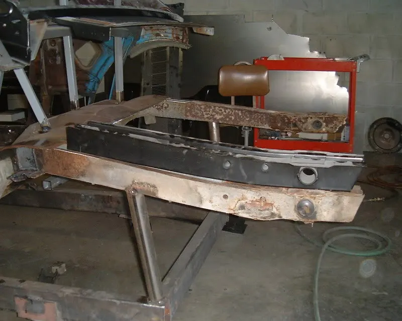

    The first thing you see when you walk in the shop are the rusted out rear frame rails so Brian decide today to start the repair

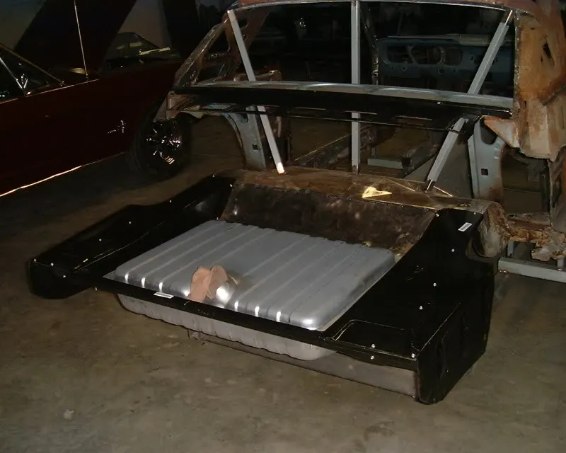

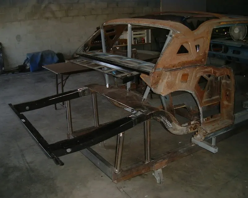

    Brian replaced the right rear frame rail and test fit the rear crossmember which fit perfect

    Lining up the trunk floor and gas tank
