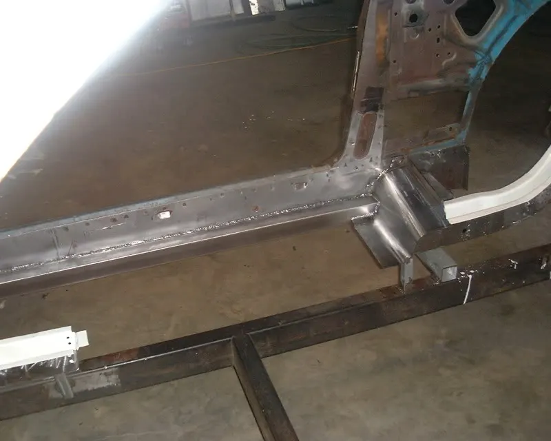

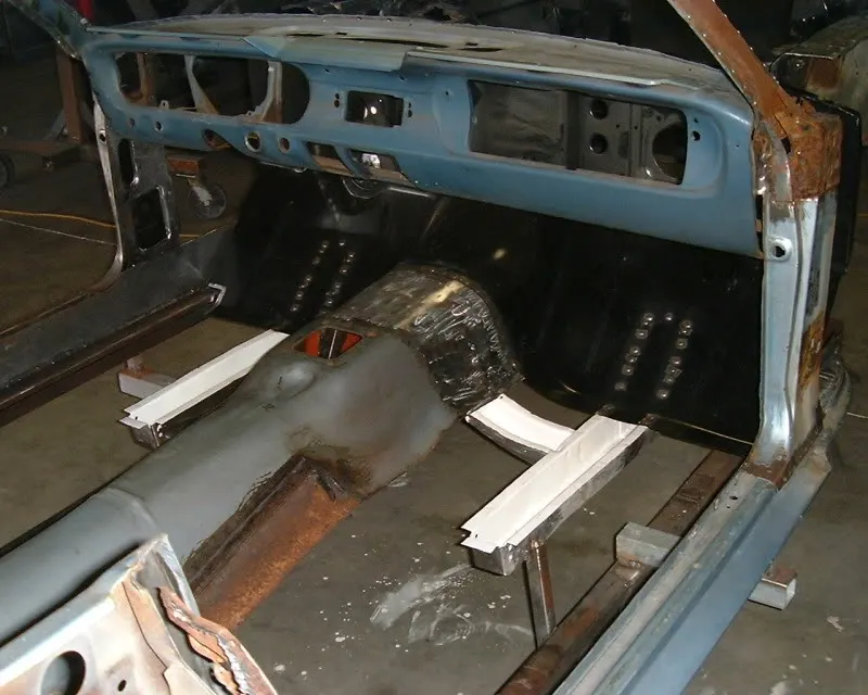

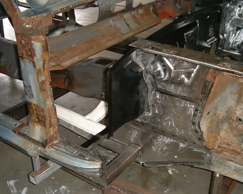

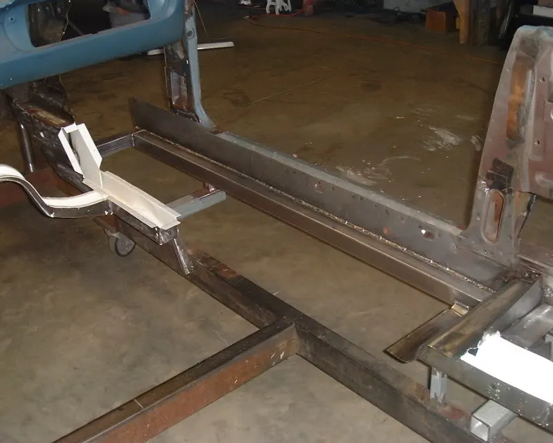

  1. Brian finished welding the subframe connectors

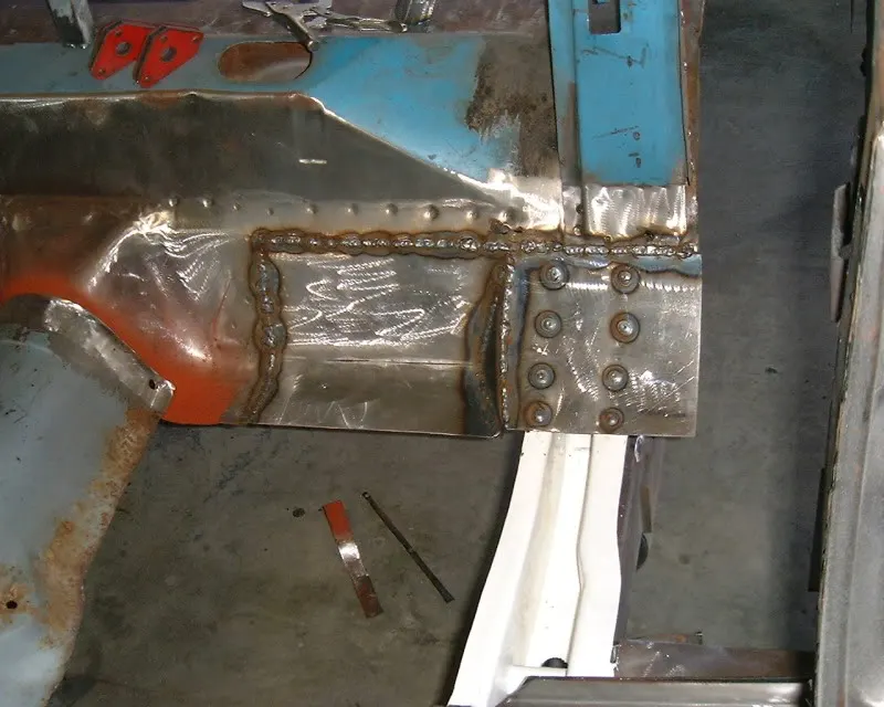

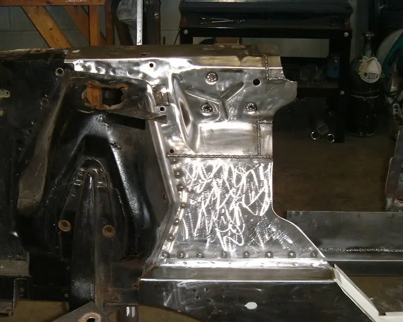

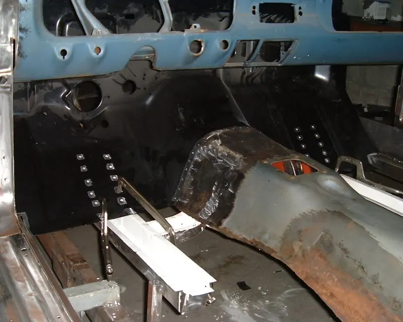

  2. Brian wanted to keep the original fender aprons so he would have something to line up the new firewall and cowl. Most of the rust was on the bottom and the very top edge. He replaced the bottom and made a few small patches on the right side but still has one small area outlined in black to repair.

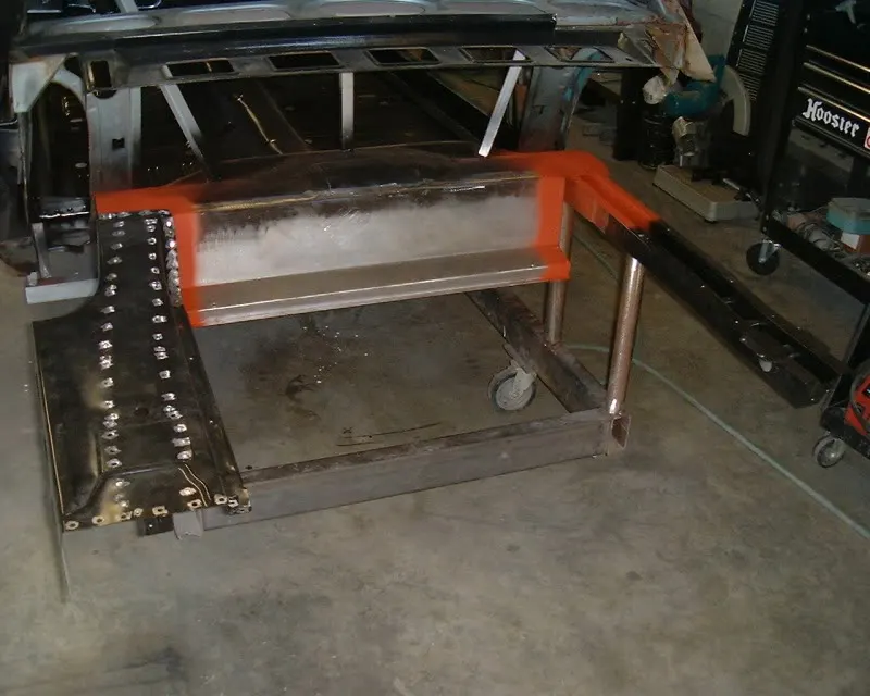

    Rebelgd likes this.

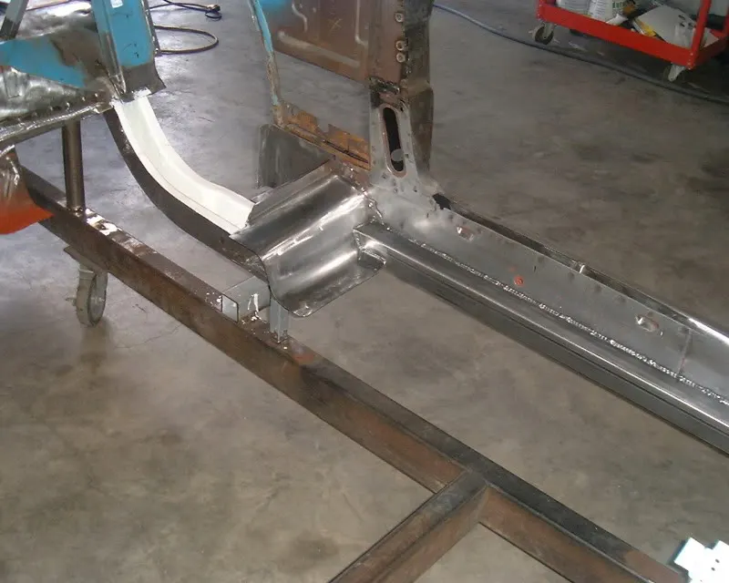

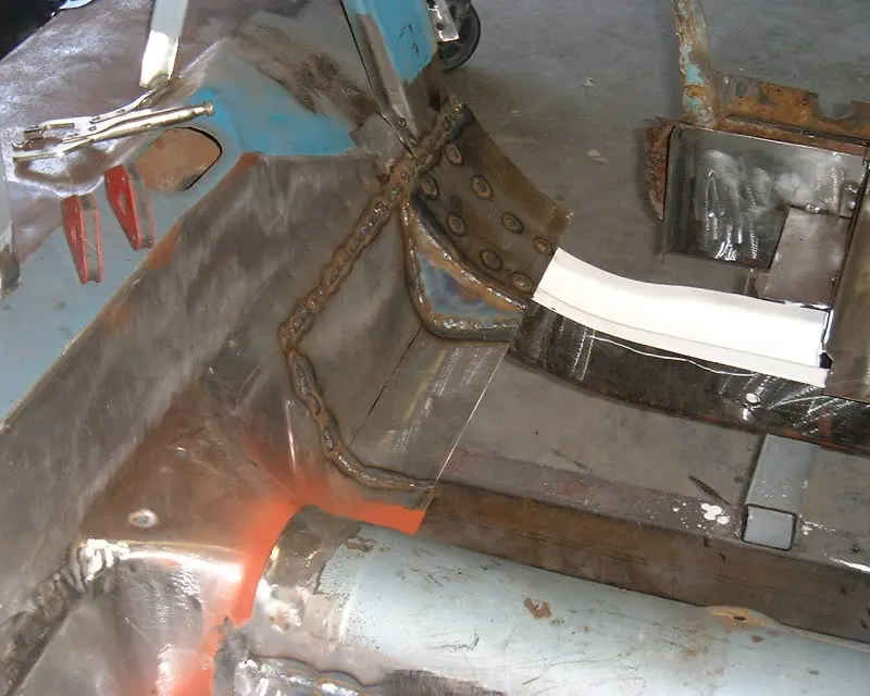

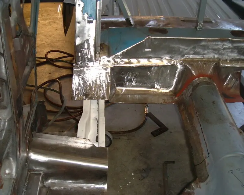

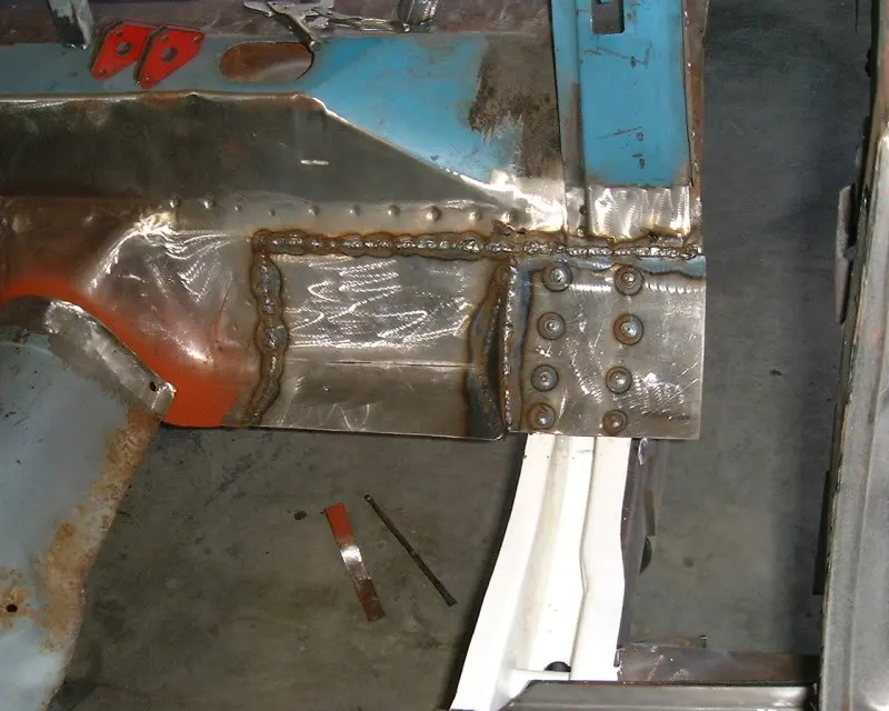

  3. Brian test fit the firewall. Marked where the holes where than removed it to grind down that area to bare metal. He also used sheetmetal screws to get a good tight fit before welding.
  4. I noticed in other pics the trans/driveshaft tunnel was removed. Are you just using it now for fitment?
    Also, using sheet metal screws is a real good idea. Not only do they pull things together tightly, when you pull them out and rosette weld the panel to the frame it ensures good penetration.

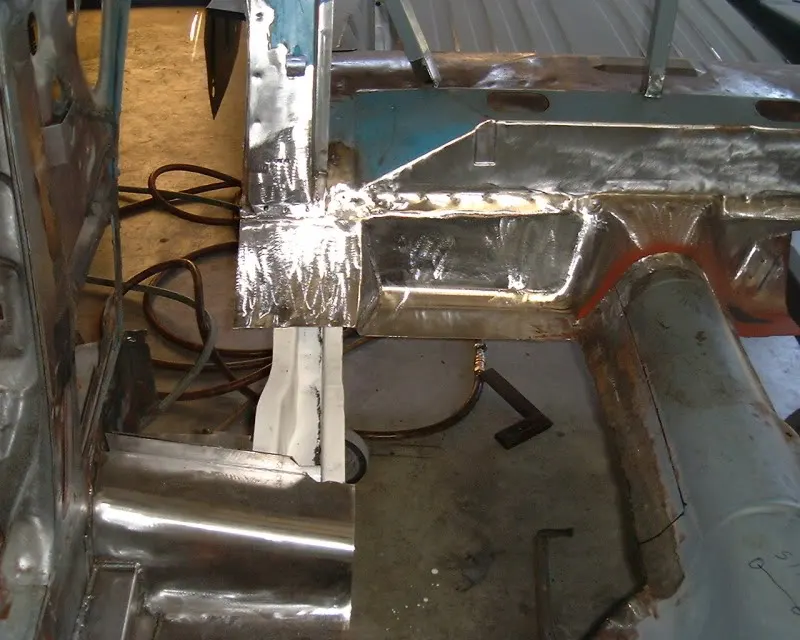

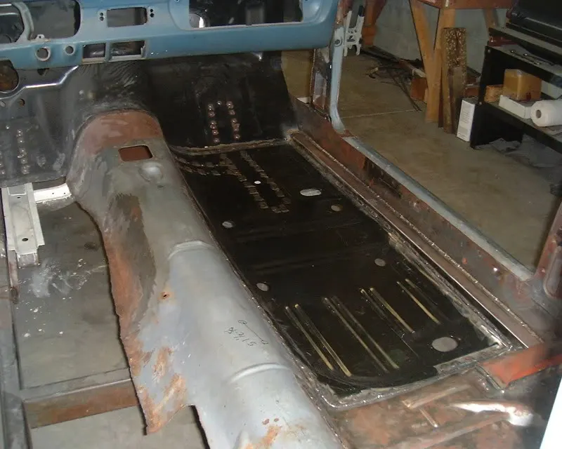

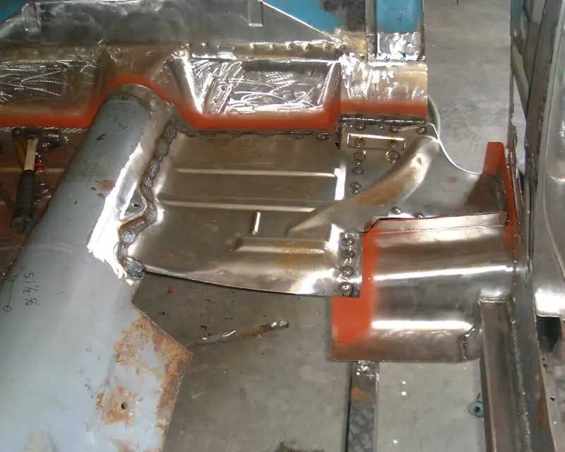

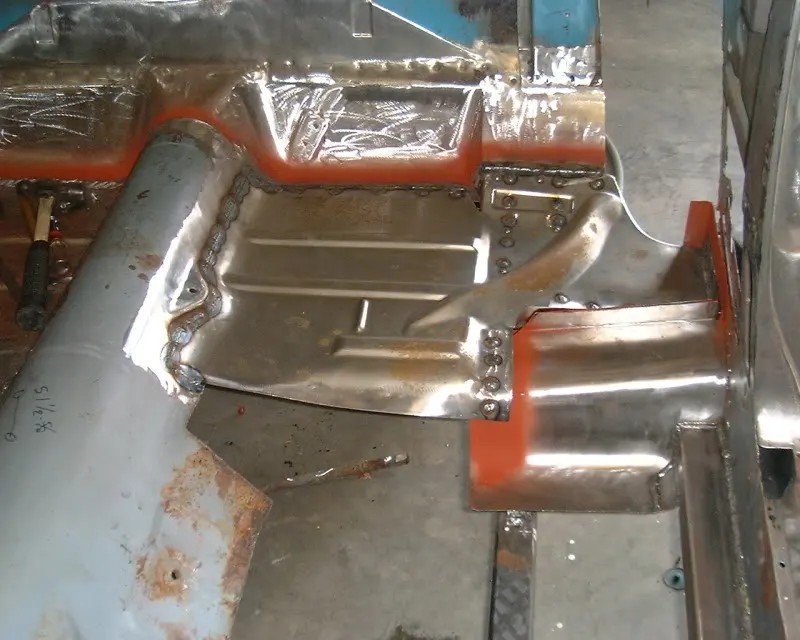

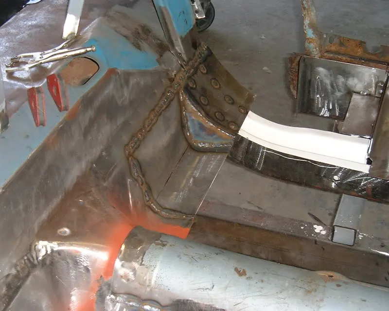

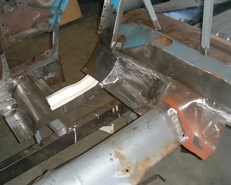

  5. We have been working on another project but Brian had a little time this afternoon and started patching the rear floor.
      File size:

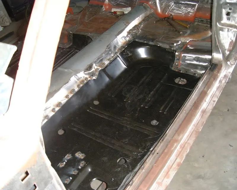

      93.7 KB
      Views:
      105
      File size:
      100.2 KB
      Views:
      90
      File size:
      86.4 KB
      Views:
      640
  6. It's all comining together really nice!
    What will it have for a powertrain?
  7. She had the stock 6 cyl rebuilt with Clifford headers before we started on it.
  8. Be a good candidate for a 5 bolt V8 axle and suspension then.

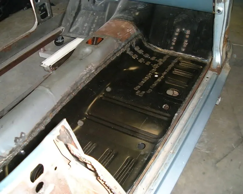

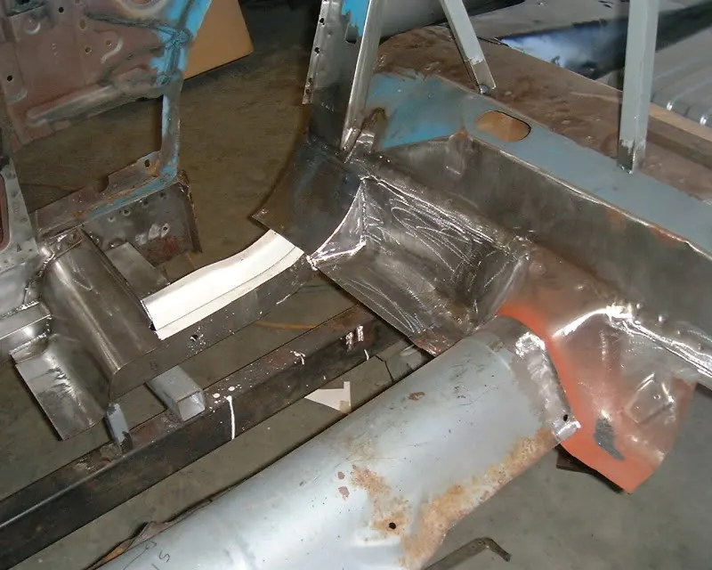

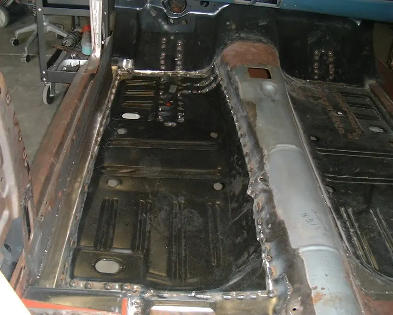

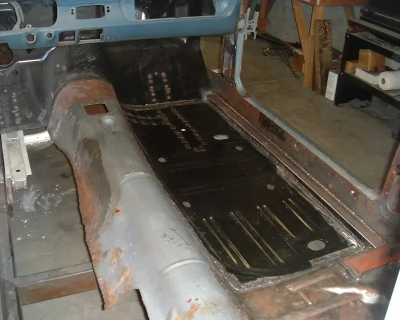

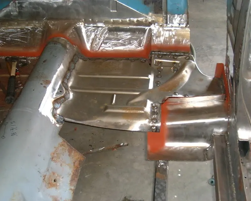

  9. Brian has the floor pan installed in the passenger side
      File size:
      92.4 KB
      Views:
      914
      File size:
      87.8 KB
      Views:
      249

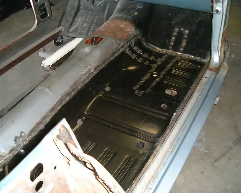

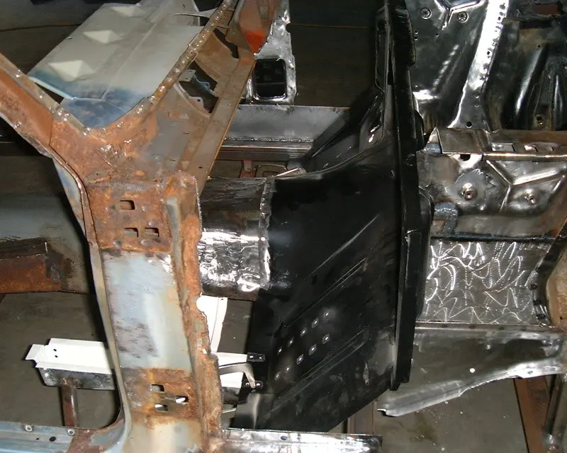

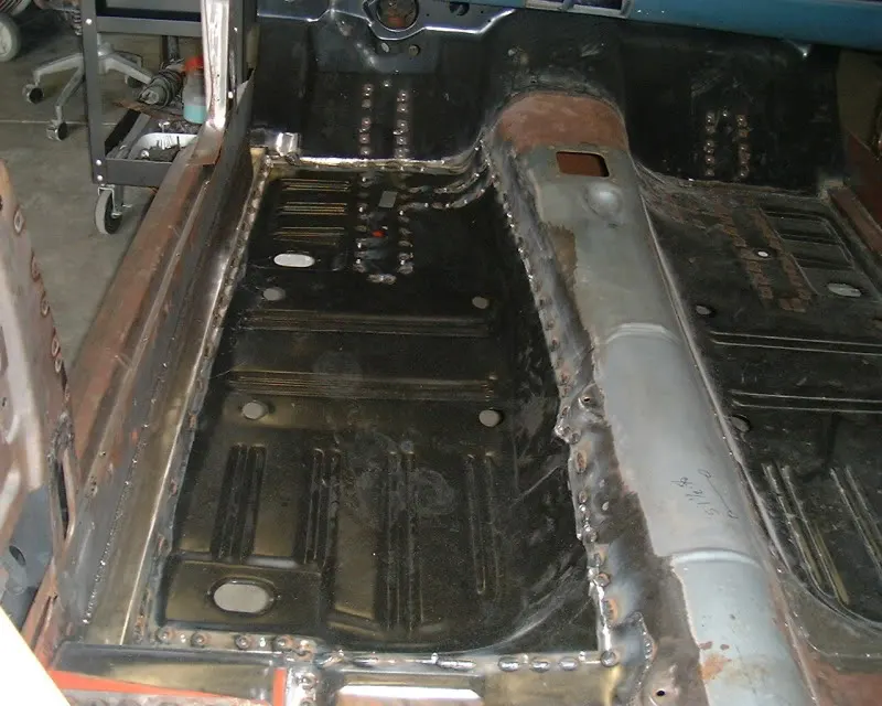

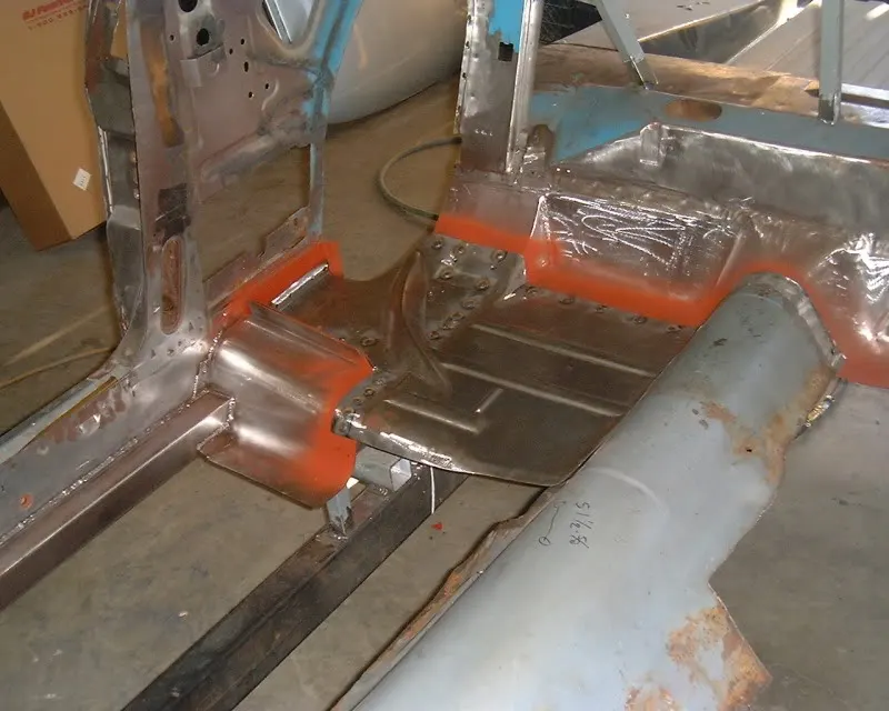

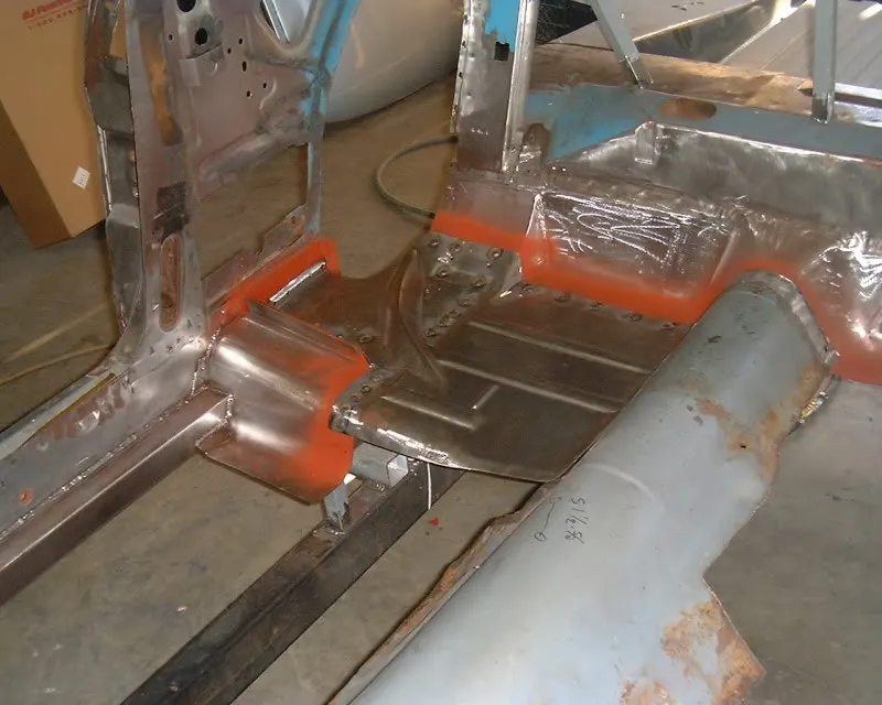

  10. Brian starting rebuilding the drivers side

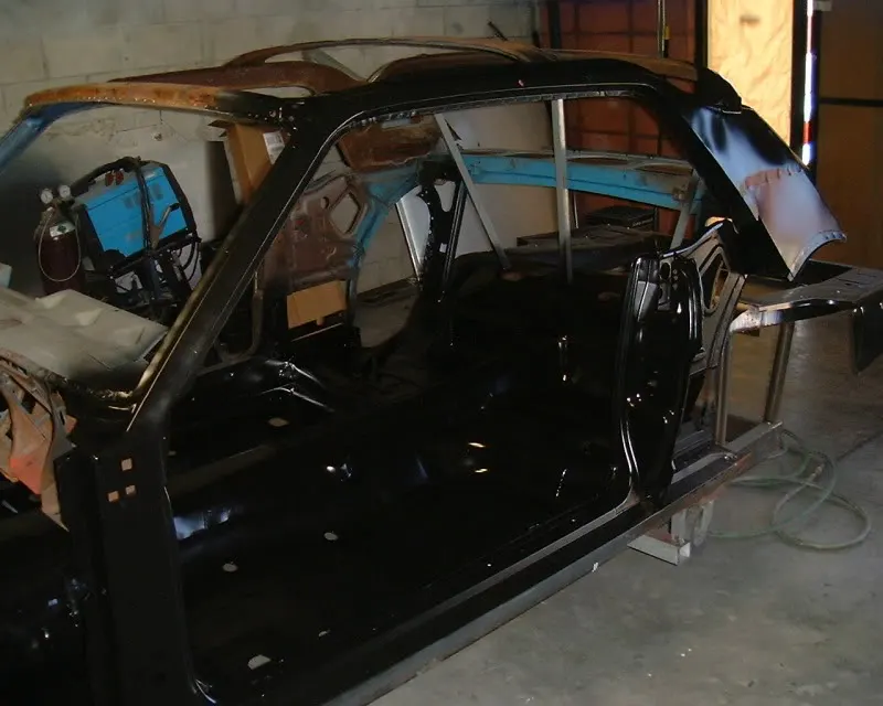

  11. After this point, can you share what you do to the metal to prevent rust before painting? I see slight surface rust on the new patch - do you sand it down completely, wipe off with wax & degreaser, and then epoxy prime?
      File size:
      89.7 KB
      Views:
      86
  12. Yes it is so humid here in Florida right now there is surface rust the next day

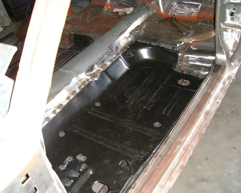

      Views:

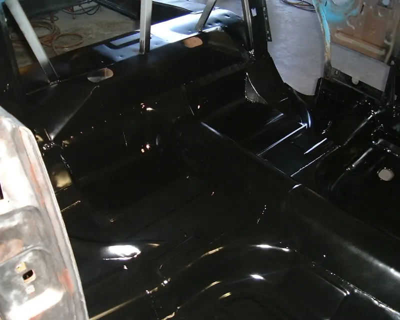

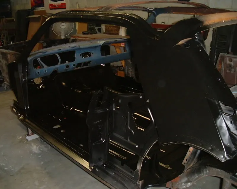

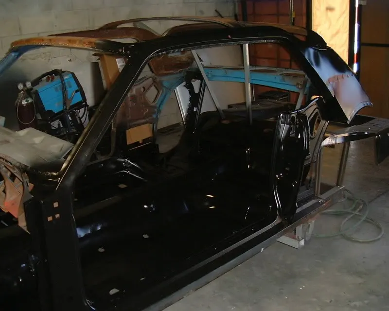

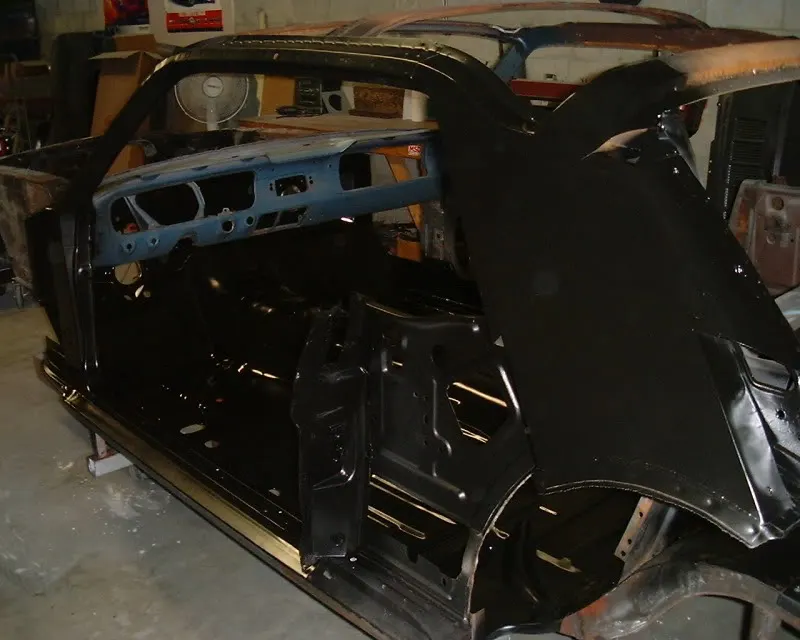

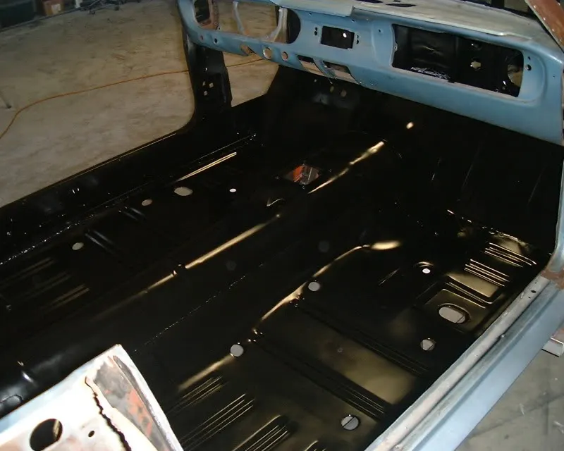

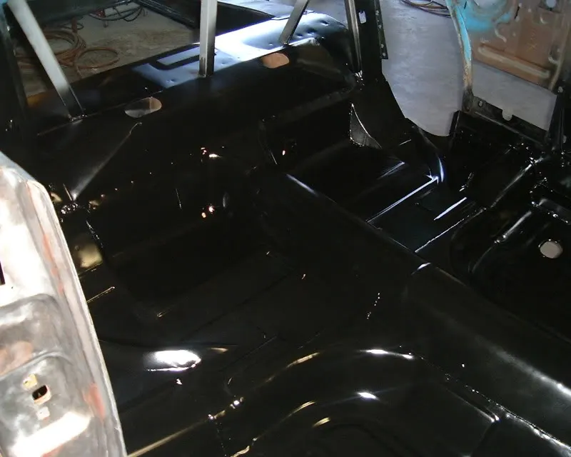

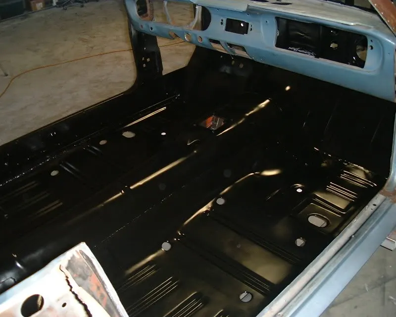

  18. The floor and the area on the drivers side that Brian repaired is now black epoxy.
      File size:
      73 KB
      Views:
      98
      File size:
      66.3 KB
      Views:
      101
      File size:
      75.3 KB
      Views:
      103
      File size:
      74.4 KB
      Views:
      83
  19. Talk about a new lease on life... Ive said it before, you guys do outstanding work thanks for sharing:nice:

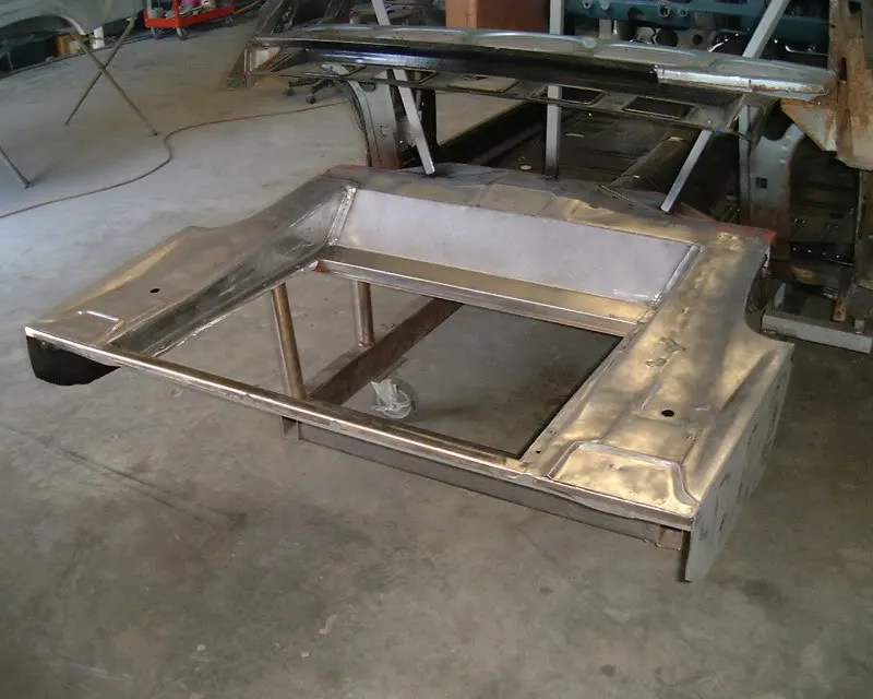

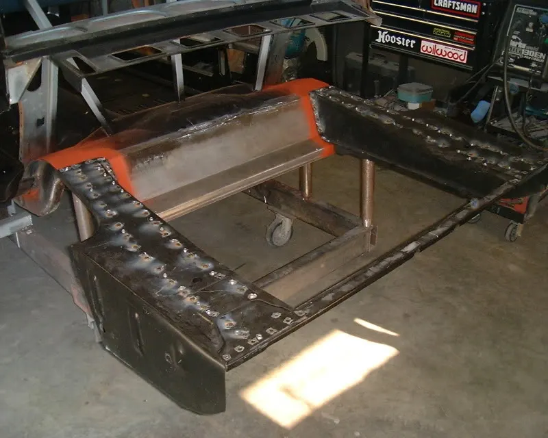

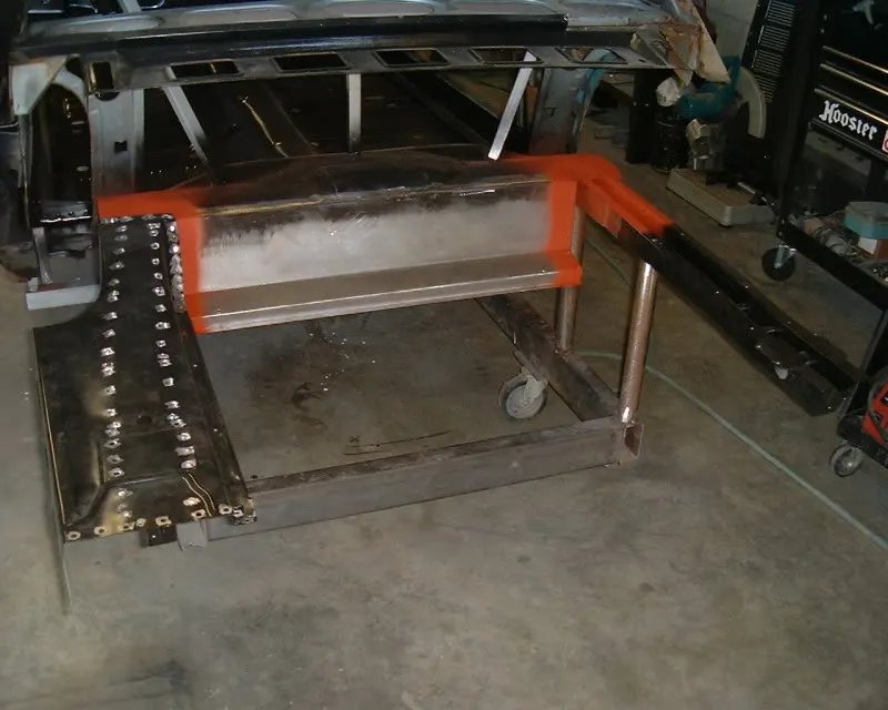

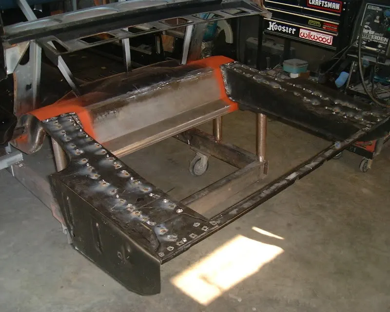

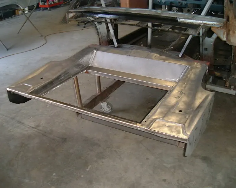

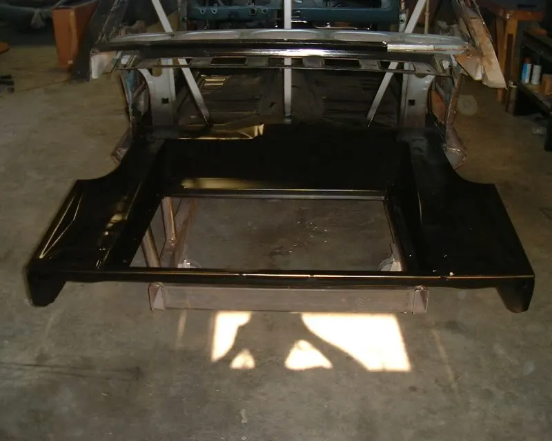

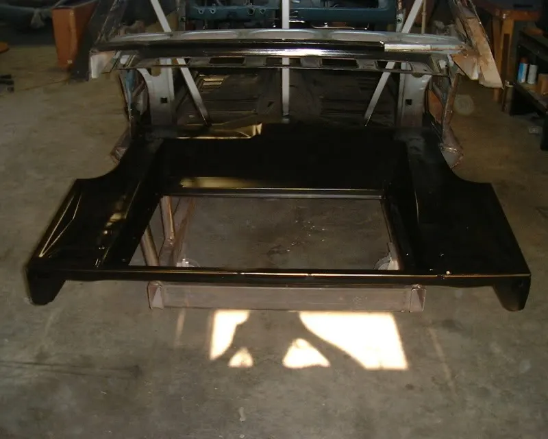

  20. We have a couple of other projects we need to work on but Brian wanted to finish the trunk area before we stopped.
    Brian started by marking the outline of the frame rail on the back side than drilled his holes for the plug welds
    Started plug welding but still has the sheet metal screws that will come out and holes welded.
    Finished welding, grinding and sanding
    Sprayed SPI epoxy to keep it from rusting
      File size:
      82.2 KB
      Views:
      153
      File size:
      91.1 KB
      Views:
      114
      File size:
      80.8 KB
      Views:
      87
      File size:
      66.3 KB
      Views:
