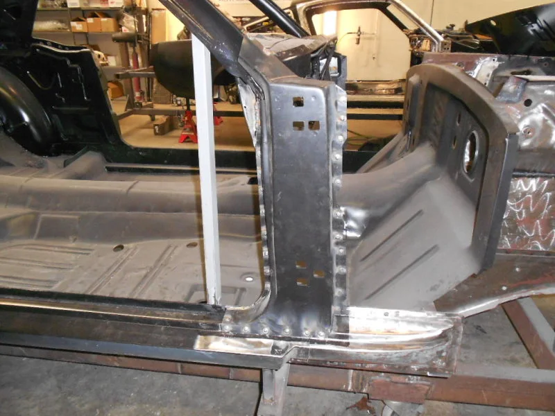

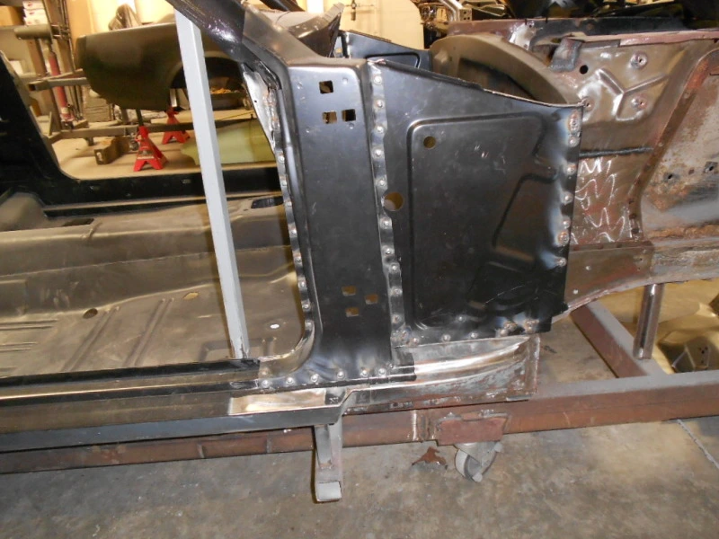

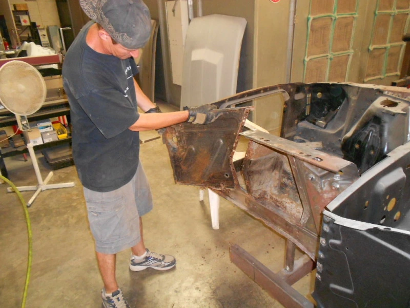

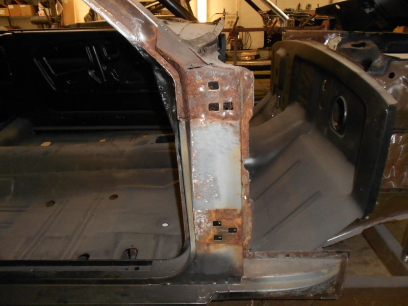

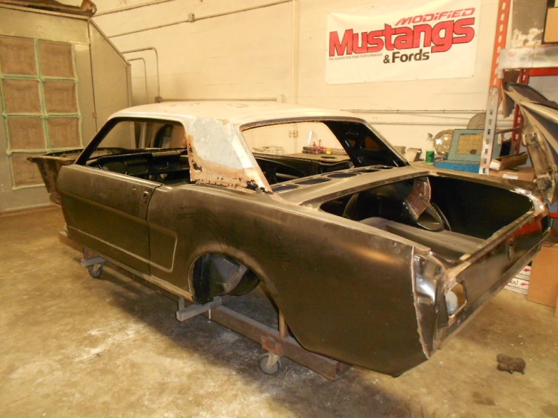

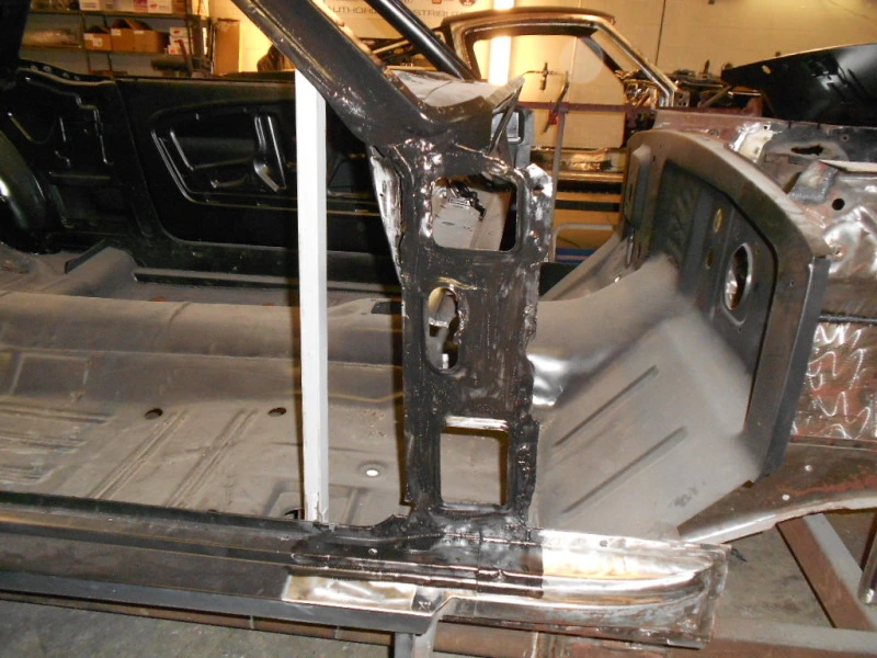

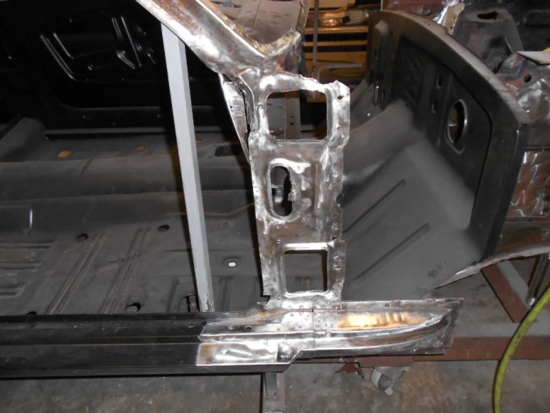

    We brought this back into the shop to start working on it again.
    Brian removed the outer A pillar than sanded to bare metal and brushed some epoxy before replacing.

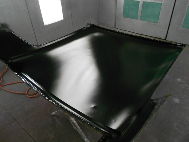

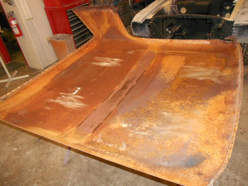

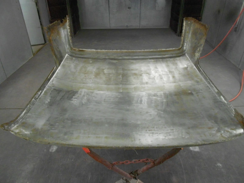

    I sanded the roof than sprayed 2 coats of SPI black epoxy primer

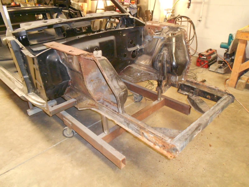

    Brian is starting the rust repair on the front frame rails.

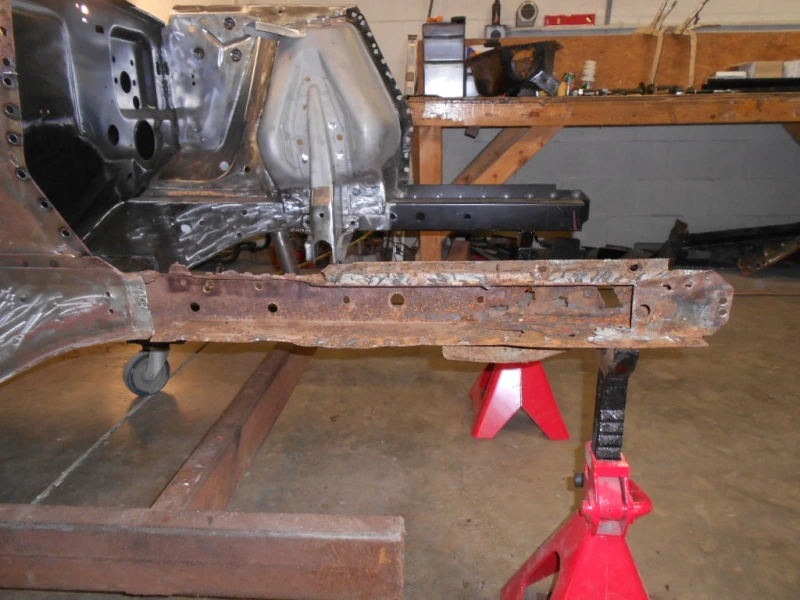

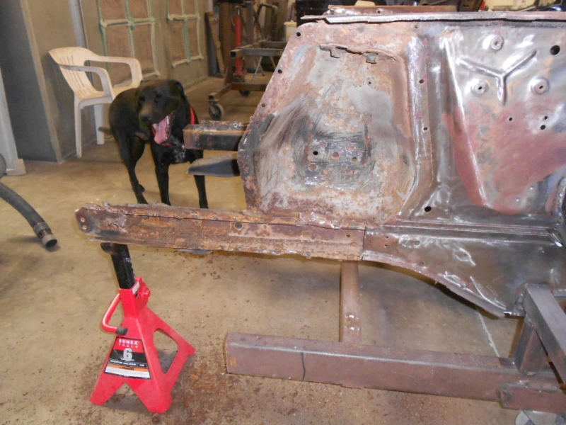

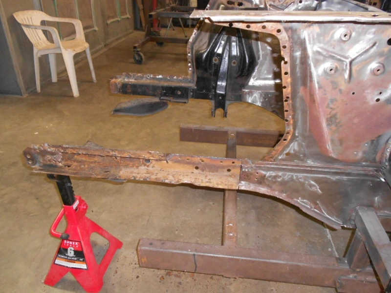

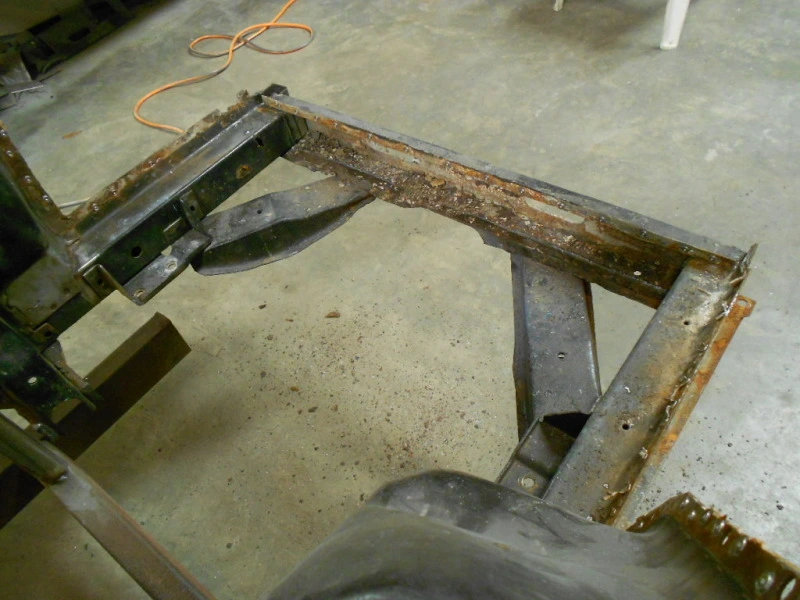

    Buddy doesn't like all the rust he sees in the front frame rails.
    #130

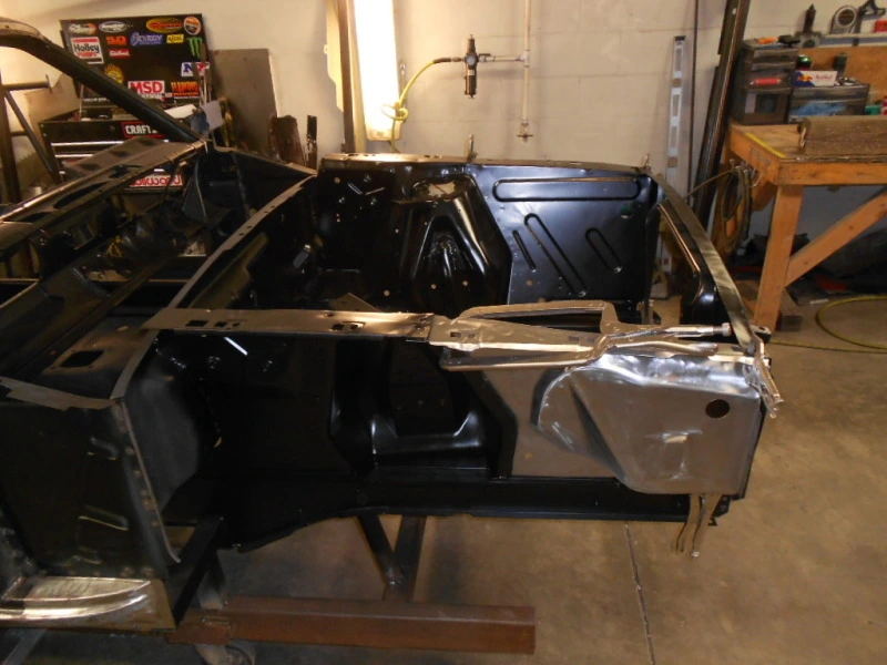

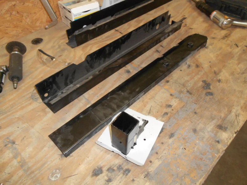

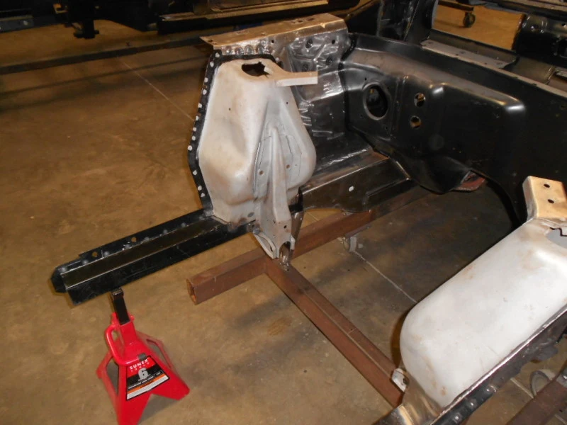

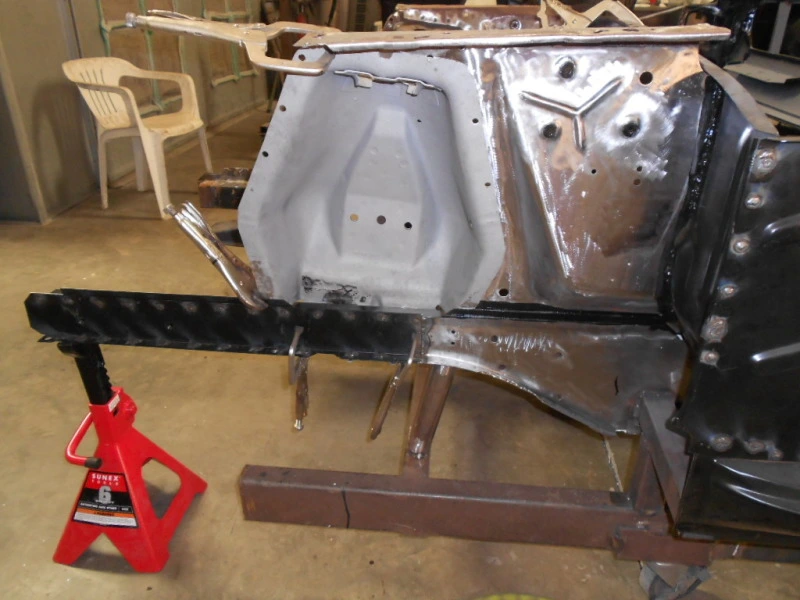

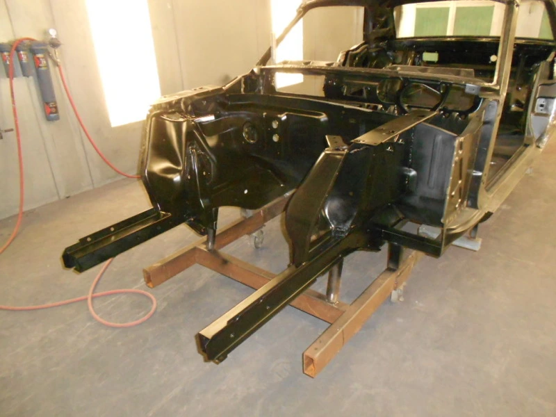

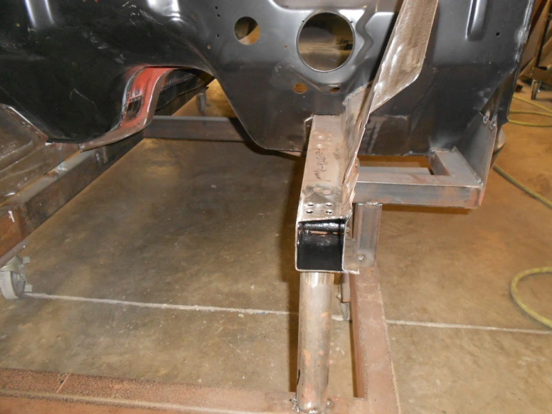

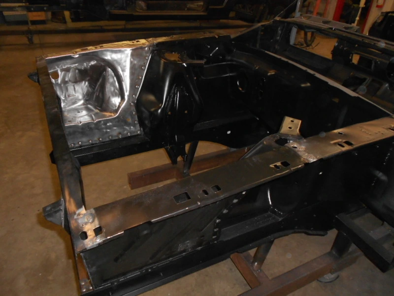

    To replace the front of the frame rail the shock tower had to be removed. Brian drilled out all the spot welds.
    He cut off the bad section than epoxy primed inside the frame rail and the new section
    Brian plug welded a small piece of 2 x 2 box tubing on the top side of the frame rail leaving enough room to weld a nut on the new frame rail section for the lower crossmember.

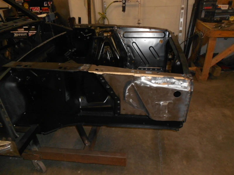

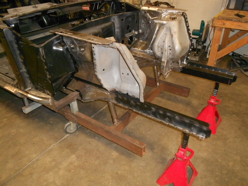

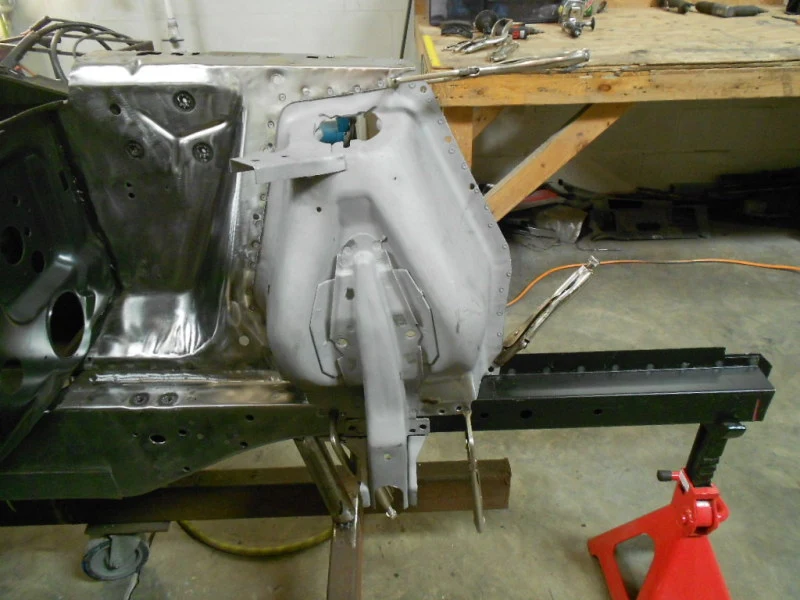

    Brian replaced the left frame rail section
    Lining up the shock tower using the original drilled out spot welds for an alignment guide.

  13. horse sence
    horse sence Please don't call me Mom
    SN Certified Technician
    Joined:
    Messages:
    4,982
    Likes Received:
    331
    Trophy Points:
    163
    Location:
    Wile Coyote's stunt double
    that same way i like to do towers use the bolt holes to line things up ,you can bolt it in place ,and using a montycarlo bar and an export brace you can easly square thing up and it holds every thing in place while you weld it up ,quick home made jig ,nice work guys

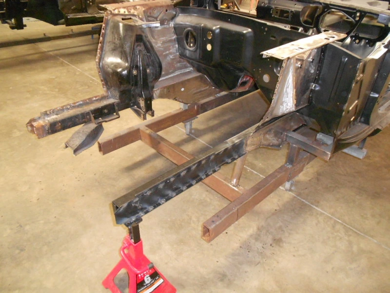

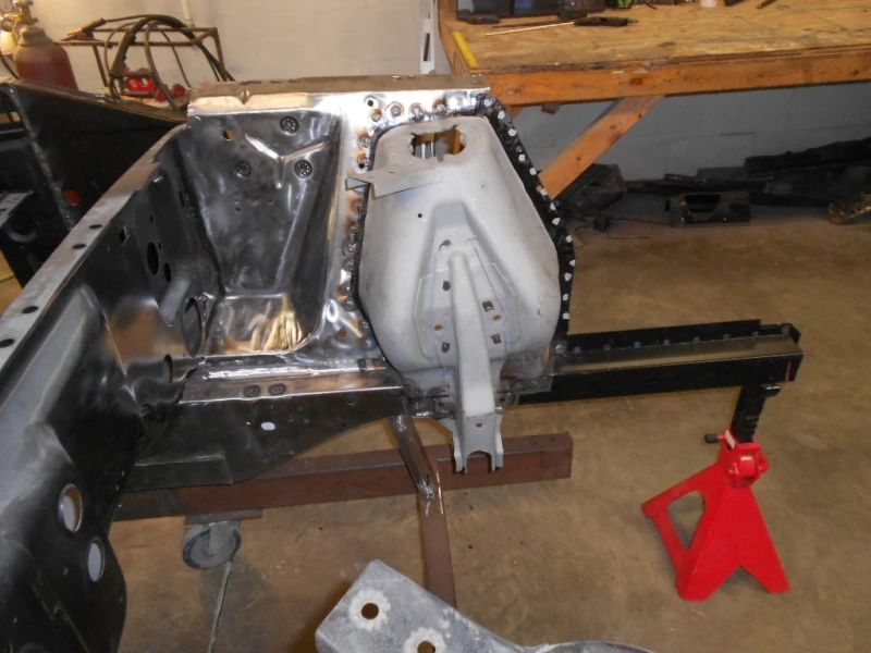

    Left side shock tower and frame rail back together

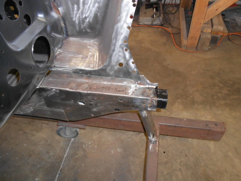

    The right front frame rail had a lot of rust
    Brian cut it off and repaired it the same way as the left side

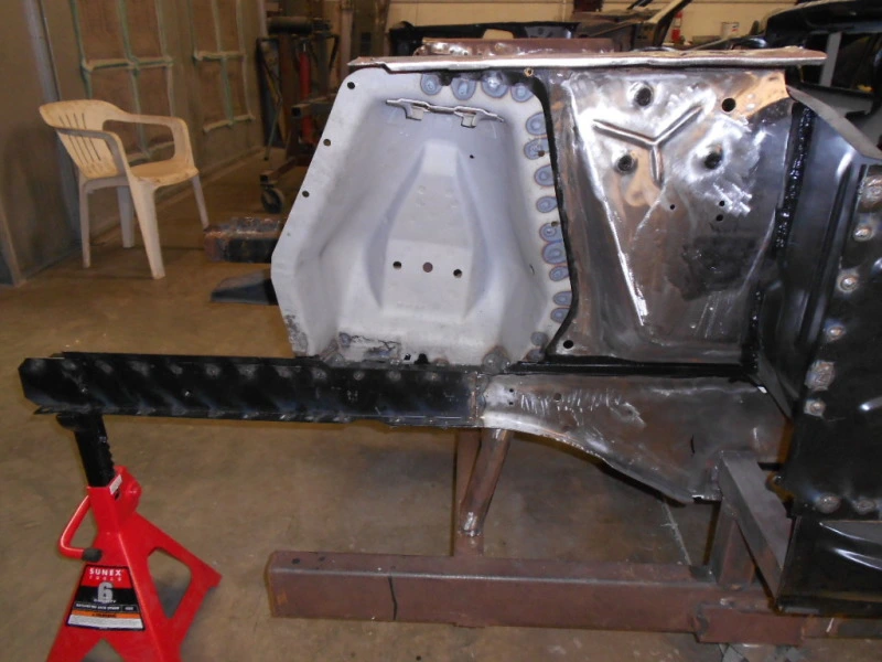

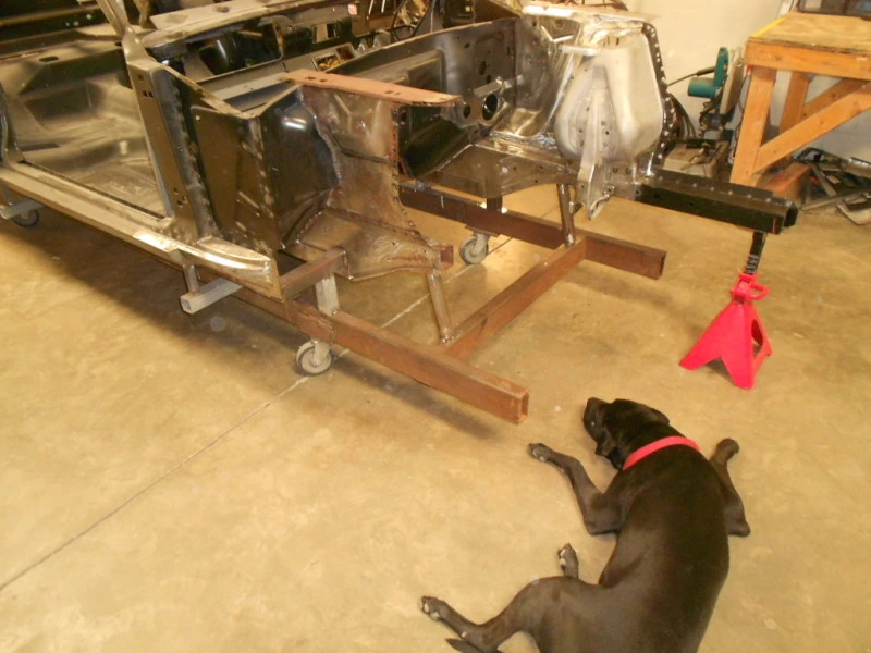

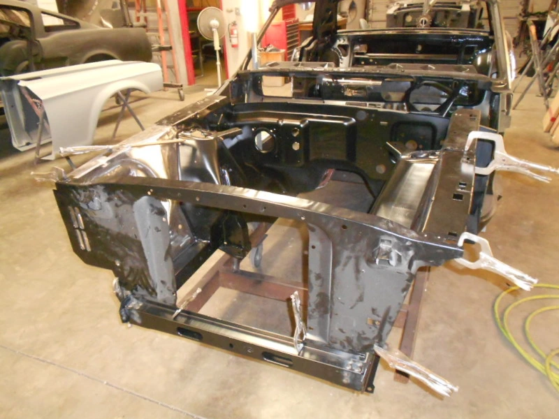

    I epoxy primed while I was waiting for the front crossmember and left fender apron.

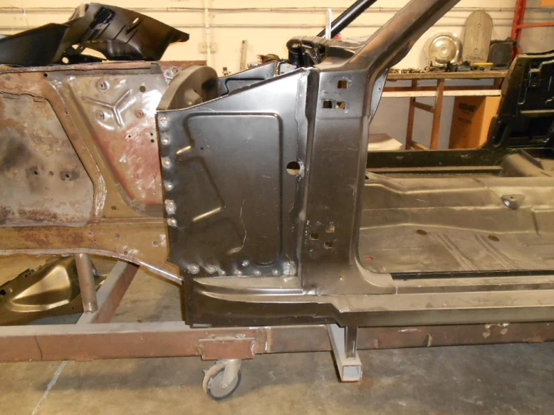

    Port Richey Fl

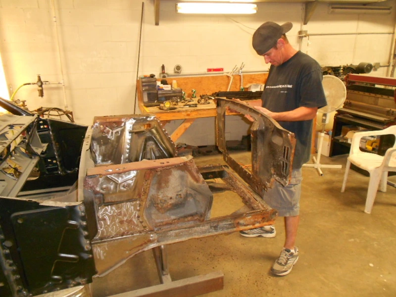

    Brian lining up the sheetmetal before welding.
    Welded in place
