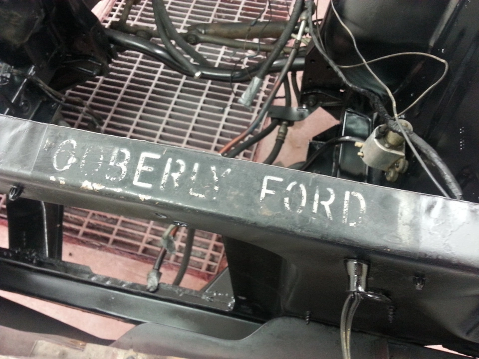

    Came across something cool. While prepping the engine compartment for the new engine, noticed some stenciling under the paint on the radiator support. Just a hint. So we spend a little bit of time with a razor blade carefully stripping the paint and found the stenciling for the original dealership when they prepped the car almost 50 years ago.
    So, we finished painting the engine compartment but left this section. Going to shoot a little clearcoat over it though to further protect it. Just a cool little piece of history.

    I restored a 65 coupe for my cousin with a vinyl top. He decided he didn't want the top so i striped it off and under the vinyl we found a big dent with some kind of rubberized putty troweled into it. beside the dent it said return to closest dealership for repairs . i think it was damaged on the transporter and repaired at a dealership and the vinyl top was added to cover it up.
    I like to see that writing and take pics of it when i find it ,some times the builders even wrote names in the quarters and left little notes .

    this car may have been a dealer reps . car . is the DSO on the door tag longer than two numbers ?
  17. rjpkrp
    rjpkrp Member
    Joined:
    Nov 5, 2013
    Messages:
    33
    Likes Received:
    Trophy Points:
    Location:
    Elkhart, Indiana
    Nah, the DSO is 71 (Los Angeles). From what I can tell, Coberly Ford was a Los Angeles dealer from the early 1900s until the mid to late 80s. It does, though, help to authenticate it being a California car (along with the Assembly Plant, DSO, and CA Black plates that came with the car).
