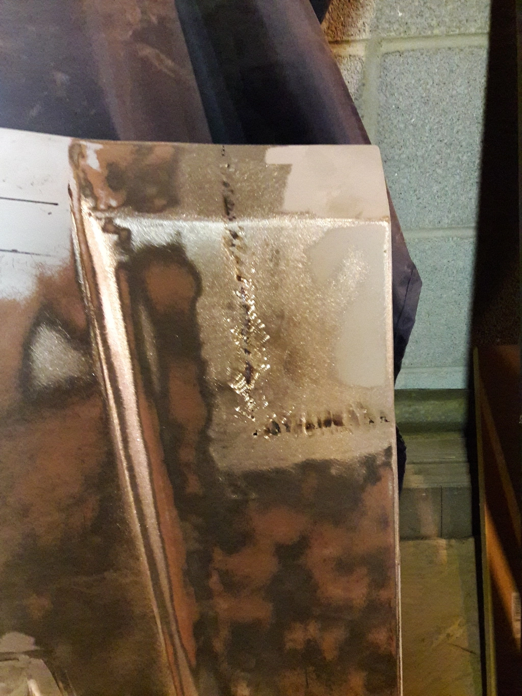

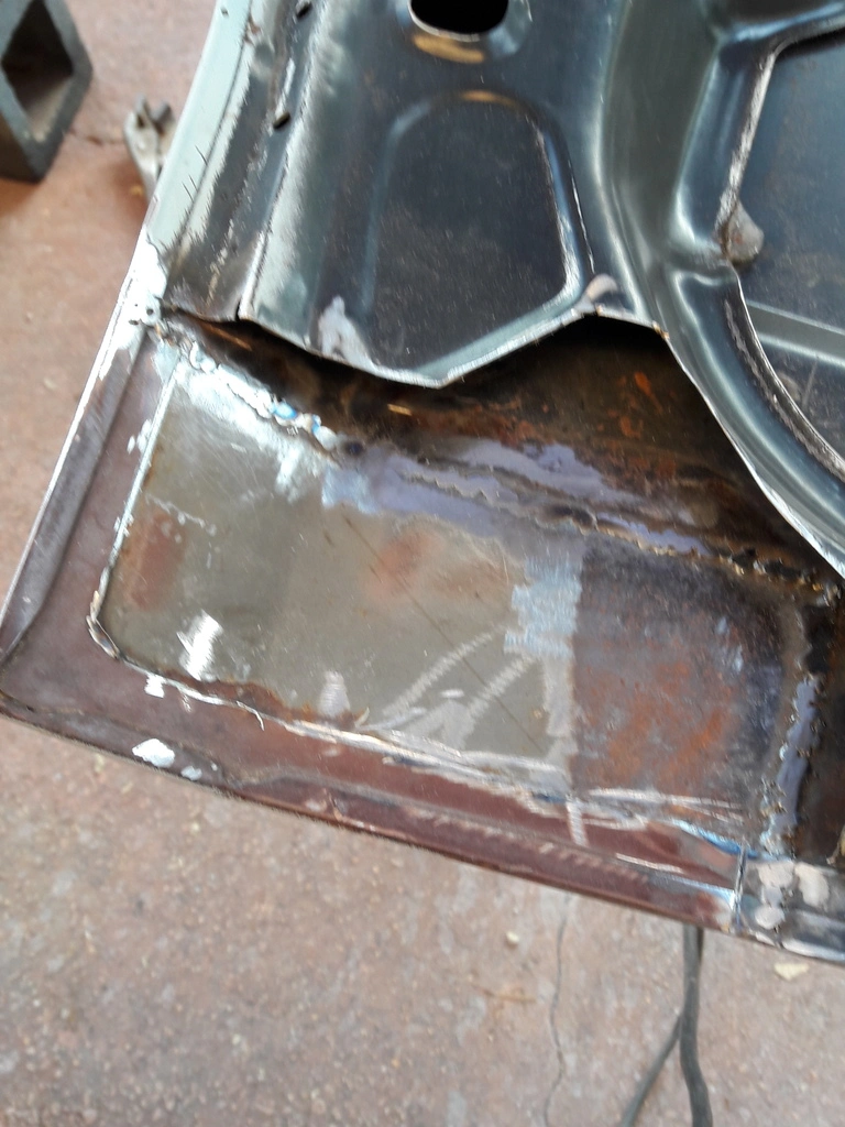

I start out sanding the thing to see what evil might lie beneath. Sure enough, It's rusted through in the RF corner Since I have a pefect donor I think NBD,....I'll just cut out the old and swap in the good piece.
Nope.
Different year Fairmont hoods have different sub-structure, The top skin is the same,.....not so underneath.
I go about welding in the piece nonetheless. Very slowly. The last thing I want is a tweaked RF corner on this hood.
I manage.

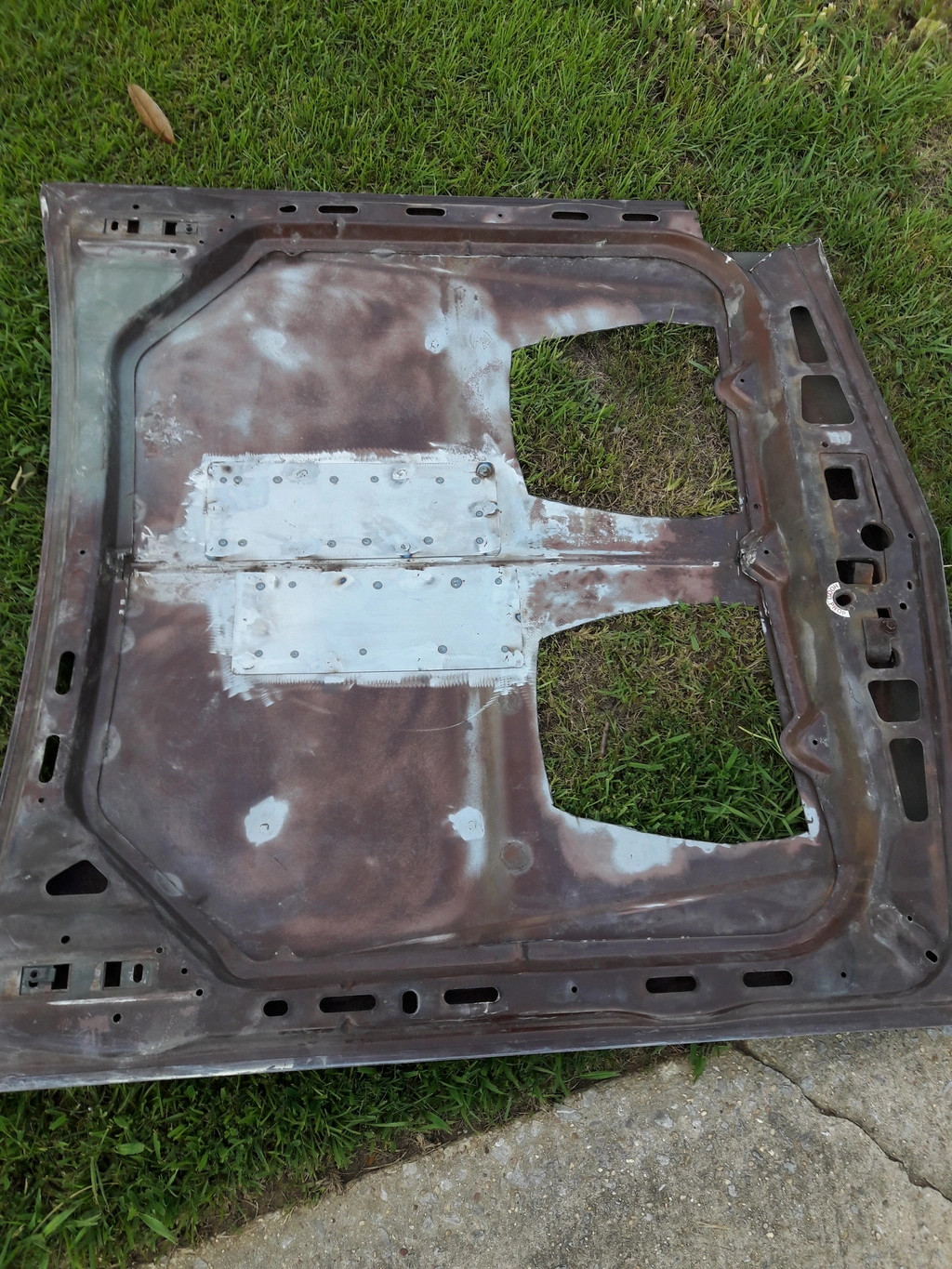

As for putting the sub structure back,...that's another story. The old one was eaten through, and what could be salvaged was badly pitted. The new structure doesn't line up properly as it's completely different underneath. Guess I'm fabricating junk on Sunday.

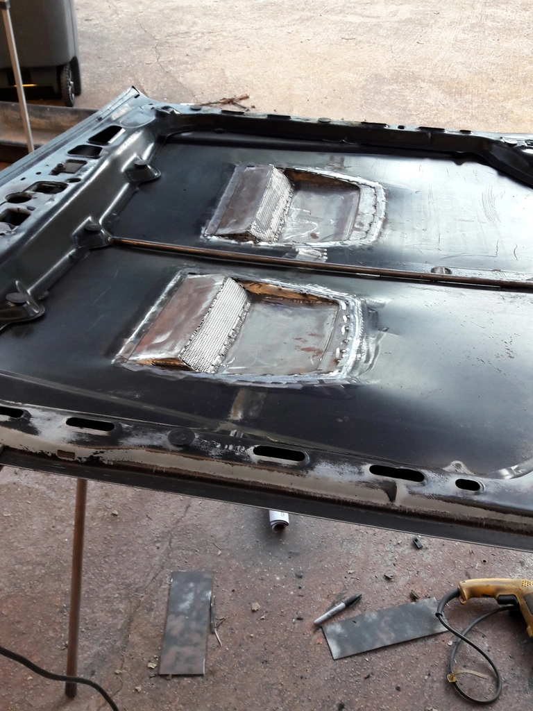

As for the G nostrils, I decided to move them back about 8". They seemed too far forward in retrospect, and by moving them I figured It'd add some rigidity to the flimsy assed top skin,...(Cause remember,....I have to cut that away to clear the turbo.) So, again, moving the Nostrils directly over the turbo effectively replaced the hood brace that spanned across the hood.
Did it keep the hood from going wonka-wonka when you push it?
Nope.
So I put back the metal bar that was on v2. That fixed it.

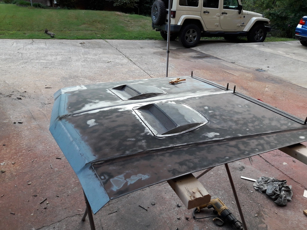

At the end of the day, I decided to add the G vents back. They were already made, and all I had to do was drill some holes and cut out the metal underneath.
I think I managed to get away without hurting the hood too bad w/ regard to warpage. I decided to create a flanged recess for the old scoop to sit in. The thinking again that having two layers of metal would make for a more rigid hood. Regardless, It is welded in place. Sunday, I'll hope to get it bodyworked and in prime.
