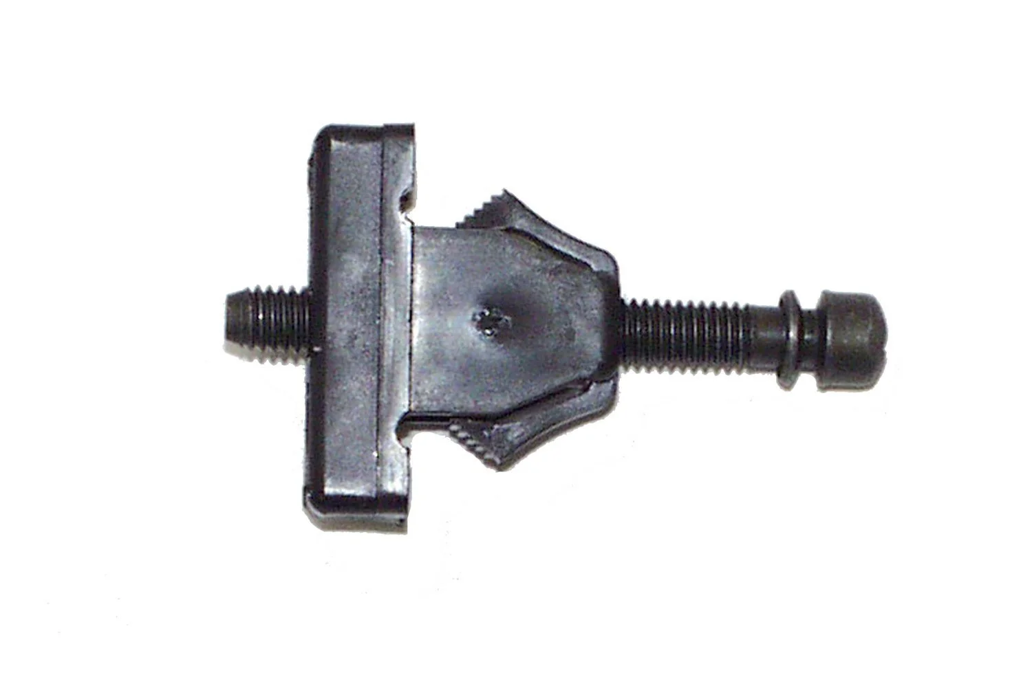

Found my headlight adjusting screw insert.....Apparently it happens enough that Dorman makes a replacement
So,.....yea,..no need to break out the JB weld.
