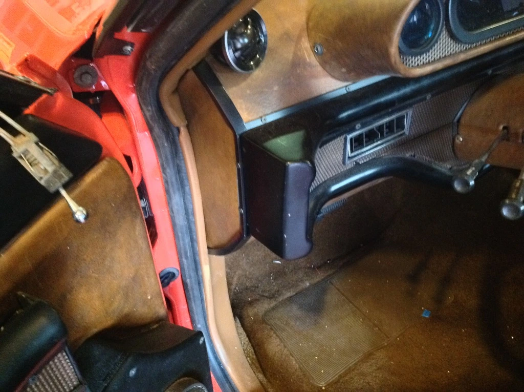

I finished one end cap for the dash.
That'll do pig,.......that'll do.

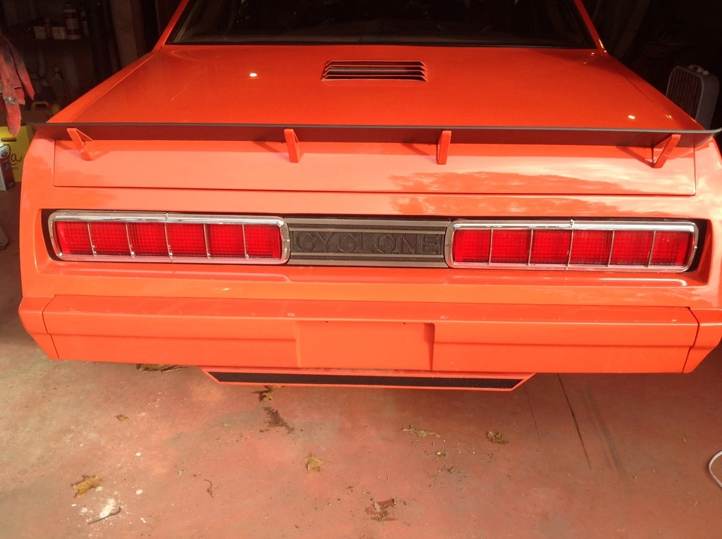

That center emblem on the rear of the car has proven to be more of a pain in the ass to illuminate it than it's worth. While driving downtown on Monday night, I noticed two glowing strips of light on top of a tanker truck. I thought "Why the hell are there lights that high up on back of that truck?" but soon enough the answer became apparent.
They weren't lights,....they were just your typical reflective tape,..making it seem like they were lit simply because my headlights were shining on them..
That's IT!....I'll put that reflective stuff behind the letters of the center emblem,..and they'll glow the same way when lights hit them from behind,..all w/o having to run one single bulb back there....
Brilliance I tell ya......It's a wonder my head isn't bigger than it is to hold my massive brain.

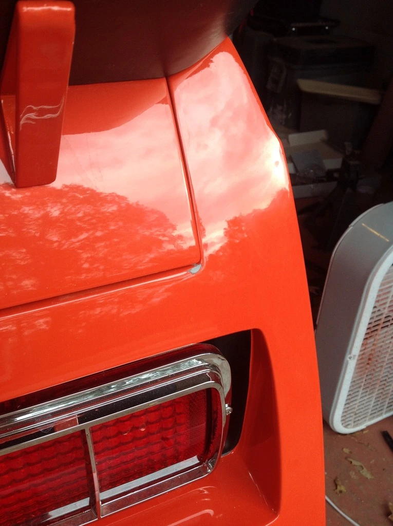

Dave wanted to see chip # 4...here it is in technocolor:
The angle makes it look like there isn't a gap,...there is. A perfect 1/4" one matter of fact. The trunk has been opened and closed numerous times by me w/o incident,....It just can't be slammed.

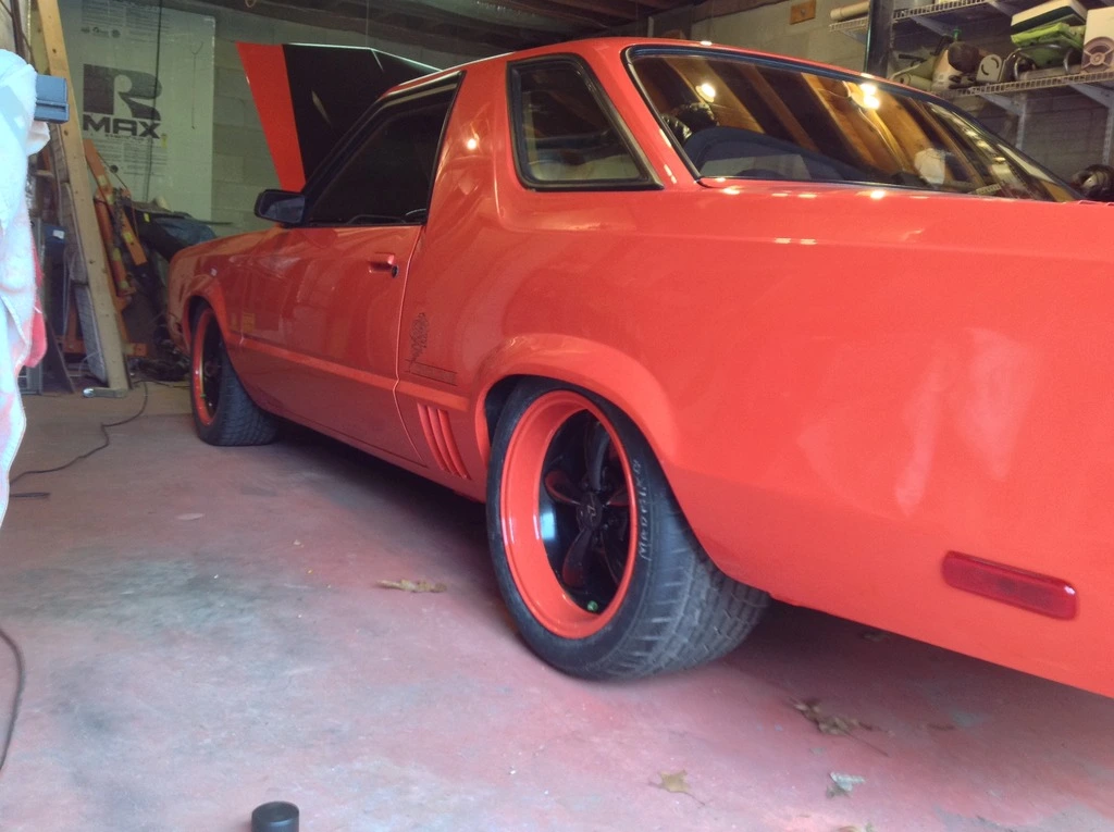

This pic won't show the ride height adjustment but I'll post it anyway.

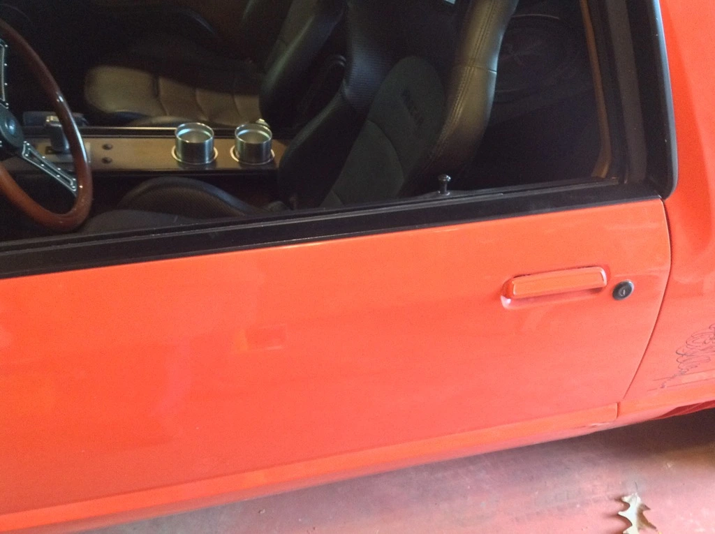

Then of course my solution to my obsolete top of door trim....
Just your average, everyday piece of 3/16 aluminum bar stock,...ran through the router to angle one edge and held on w/ 3M adhesive tape....BTW,.....The door lock button........**whispering**......Not a door lock....You push down on it to open the door from inside.

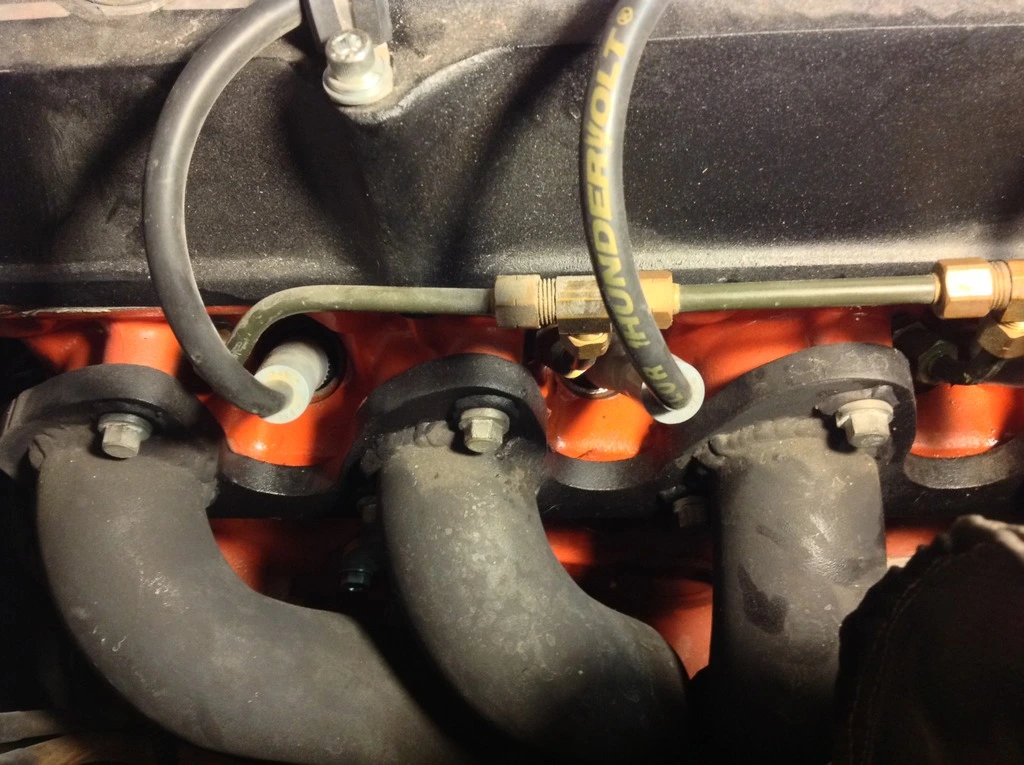

But then,...Smoke....in this case a good thing.
Because its coming from here..
There was so much oil here it was puddling. Those puddles of oil were the things that were smoking. I have since mopped it up,..but I'd have to say that what's happening here is that I gotta valve cover gasket leak. It was seeping past the header flange,..running down the side of the engine, and along the pan rail,..... eventually running down the back of the engine, and.........dripping....onto the floor.
Valve cover bolts were pretty loose. I tightened them up as tight as they'll go. Hopefully that will be the end of my damn engine oil leaking,...now I just got the freakin transmission to deal with.
