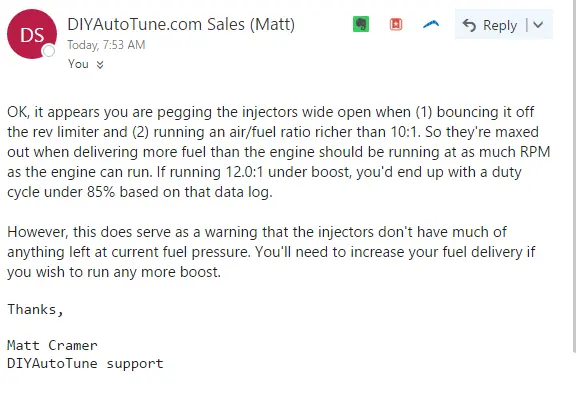

OK Mike here is the deal....On my datalog,..the injectors go to 112% duty cycle for about a second when the thing first hits 7 pounds, so that prompted me to take the laptop downstairs and see where the running fuel pressure was. Now I didn't start the car,..I just turned on the pump and looked at the pressure. It was around 50 p.s.i.
I wonder how much a running engine drops the cyclical fuel pressure at idle?
Nonetheless,..I adjusted it down to 43,5 in a non-running mode,...I'm sure that when I start it next that will be way too low. We'll see I guess.
The whole reason for me going down there to look at it was simply because the injectors go to 112%. When you look back at some of the other datalogs,....they've been there before....not 112%, but over 100%.
I don't have to be any kind of tuner to know that I can't run the injectors at that extreme.
So that is what prompted the look at the fuel pressure, and to wonder whether or not the regulator is doing what it's supposed to do when it starts seeing boost...
If fuel pressure is supposed to be static at 43.5 on a running, non loaded engine,...and each pound of boost gets another pound of fuel pressure, is that sufficient to call the injectors adequate for the engine?
These are 44 lb/hr injectors. Even when you target 450HP (which this engine will never make) and set an 85% max duty cycle into the calculator,..the recommendation for injector size comes back at 44lb/hr.
What are the factors that could be making the injectors bust their ass like this?
MS is a batch fire system ie. Non sequential.
This means that you will always have two banks of injectors alternating pulse events. Ie... Extra dead time event
Then we have the fact that we are using 2 pulses per cycle. This increases throttle response and smoothes idle with a batch fire system..... at the cost of another extra pulse event.....
So normally we size injectors with a single dead time event of 1ms.
But now you are sizing them with what is effectively a 4ms dead time.
At 7000 rpm it takes the crank 17ms to complete a revolution. (Roughly) that means with the MS you are spending a good portion of that time opening the injector.....
Most likely the 118% you see is not a true representation of the useable injector range. This is because eventually the injector will "peak and hold"......
I would instead look at the injector time. It is based in milliseconds.

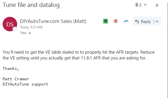

Let's put a hold on things here real quick I will answer the afr issue first.
You are being affected in 3 ways.
1.- actual enrichment from ve table
2.- all other static enrichment including warm up
3.- AE.... this one has not been tuned yet and is a likely culprit.
First things first.... if your out of wot afr is acceptable (within .2 of target) during warm up then it's not likely to be affecting the wot portion of the tune.
Then check.... AE we never did get to setting this in any way it is a roughed in table. The method is simple and will take 15 mins to complete. (One thing to remember you want to be about .5 richer than target.)
If not those 2 then....... the ve table in that area of the tune has not yet been adjusted, if the boost comes on sooner than before and holds..... then we have to retune the ve table like a sc....

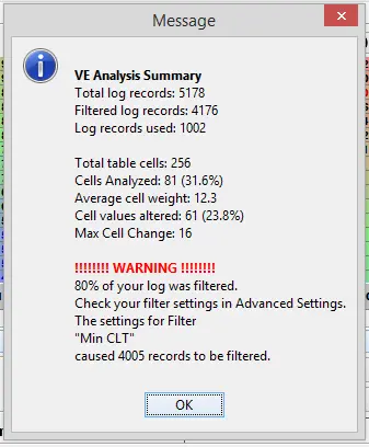

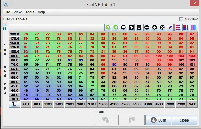

Ok,..so I did that...Now the VE map looks "unbalanced" I was basically in the same scenario that you used as an example. the areas that were tracking on the datalog were in the 100-109 area,....reading 9.7-10 AFR .Ve is based on the fuel amount needed to get 14.7 (stoic) afr.
This is directly affected by the required fuel AND afr table.
But none of that really matters in the grand scheme.... here are some key notes....
1.- the ve table is affected by the afr table from stoic.
2.- any number in the ve table is a representation of fuel, the actual number means nothing.
Example- I have a VE of 100 and my Afr table is set to 14.7 in the same area. If I change the AFR table to 13 the fuel will automatically be increased by 11.3%... but the ve table will still show 100.
Example 2- I have a VE of 100 my Afr is 10 but my Afr table says 12... I want to get the afr into target, so I need to change the ve number to get the right afr.
Right now it has too much fuel so I have to reduce the ve table numbers... but how much does it need to change? The answer is based in a percentage... this is because the ve and AFR table are tied together.
So I have 100ve
Afr of 10.... my target AFR is 12. Some simple math will need to be done. I will take my afr and divide it by my target.
10÷12= .83333
Now I need to multiply my VE by 83%
100×.83333= 83.3
the new VE of 83.3 will take my afr from 10 to 12. ....Now I'm on target with the AFR table and the afr of the engine being equal.
