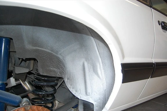

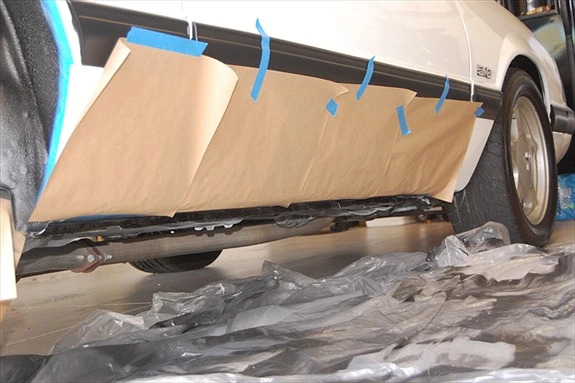

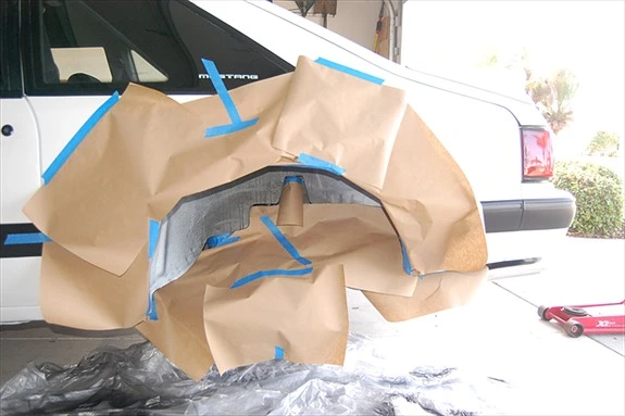

  1. I had some overspray in the rear wheel wells from getting the car painted. So I masked everything off, bought a cheap can of paint, and went to town.
    0_0_3e058a39195bcd23cf9f11793bba2d7d_1
    0_0_15e25fe727a939d13f5623e54aab689b_1

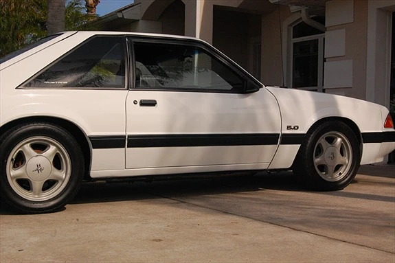

    My pinch welds have been f***** since I bought this car. Someone did a really poor job using a jack on this car. So, I straightened them back out and sprayed the face of them flat black. For some reason having the white strip of the pinch weld showing below the rocker panel of the car just looked off to me. I very carefully painted these.
    0_0_58149019dd11aacf23acaf06bef44955_1
    0_0_458624f2c1d463c8c4dfaf03fa2dd3ce_1
    No more white in the wheel wells and the pinch welds are no longer easily visible. Small work but for some reason it makes such a huge difference to me, especially when looking at a side profile view of the car.

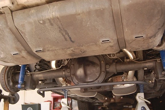

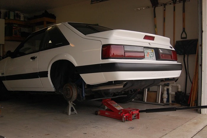

    Got the car up on jacks this morning and am starting to pull the rear end out. Going smoothly so far.

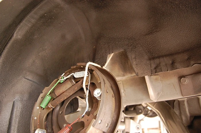

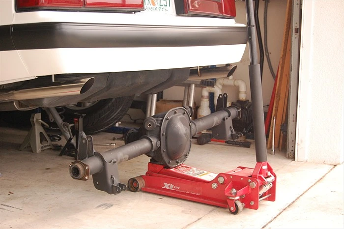

    I removed the backing plates from the axle housing so I could just tie the brakes up out of the way when I swapped axles. I used a piece of 3/8" rope wound through the hole for the shock.
    0_0_3e9d1d12a9544ee82d45d50ac72957b9_1

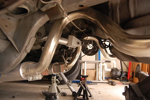

    Old one out
    0_0_a26a86c23dfd92a0040d926228e5bd10_1
    New one going in
    0_0_7b1dd050ad016bb473fd1187789e3e5f_1
    All bolted up
    0_0_fa9568a6745f964fbdf23628f4a4e083_1

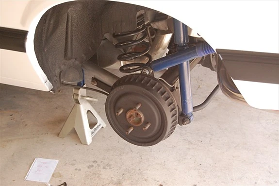

    Used some flat black implement paint to freshen up the drums and hopefully prevent them from rusting as fast

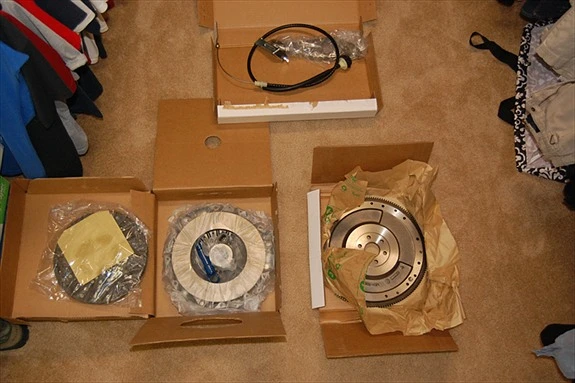

  18. I've still got a few boxes in my closet from Christmas that haven't made it on the car yet. I was waiting for a few things before I dropped the transmission (for a 3rd time) and installed these parts.
    0_0_54a1c9e5cef8bd47a7baaf10669d09dc_1
    FRPP Flywheel
    King Cobra Clutch
    Ford Racing OEM clutch cable and fork.
    I bought new ARP flywheel bolts along with a flywheel dowel and pressure plate bolt kit this morning. I also picked up a Flex-a-lite variable speed fan controller so I can install the Mercury Villager fan in the stock shroud sometime soon. I need to pick up a firewall adjuster for the clutch cable as well sometime. I've got some travel for work coming up next week so hopefully when I get back I can start working on this.

    Did you pick up a new clutch quadrant too? The factory plastic one sucks although it's a PITA to install but well worth it.
    Best deal although you already have your cable is on summit for cable, firewall adjuster and double hook quadrant
    http://www.summitracing.com/parts/sda-555-7041
  20. There is already a quadrant installed, so all I need is the firewall adjuster now. When I bought the car I remember the guy mentioning that he had a firewall adjuster installed...after I got the car home and started poking around I noticed it wasn't there anymore. I think he pulled it off while we were in negotiations over the car. Son of a *****.
