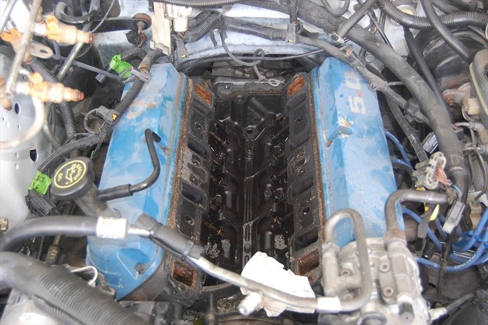

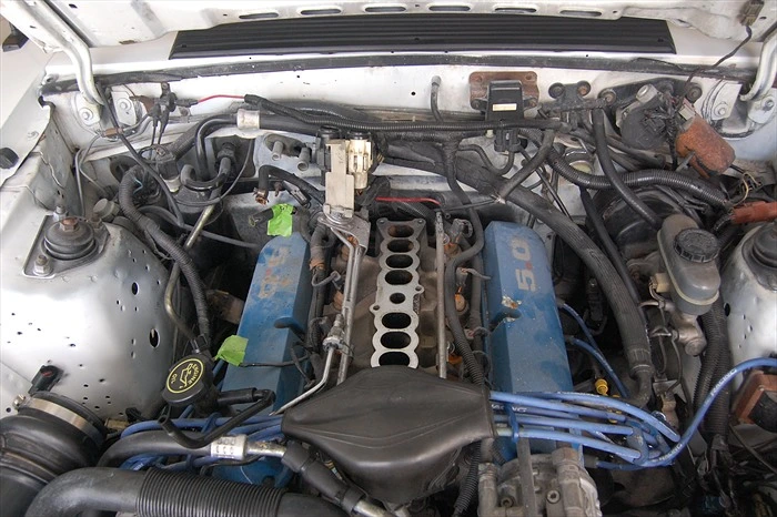

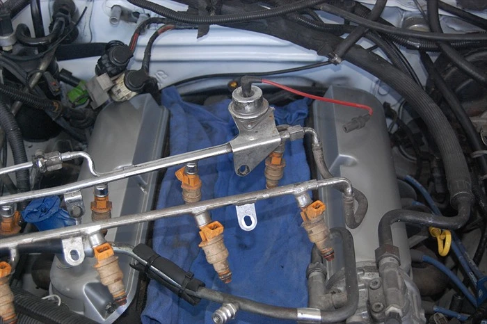

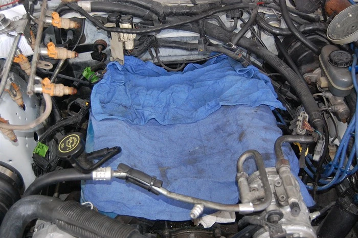

  1. Drove the car around the block this morning. Voltmeter was reading high, the battery light was dimly lit and the tach was acting really funny...very jumpy. Then I remembered re-painting the front half of my engine bay last week and decided I had to re-do a couple of my grounds. Grinded the contact points back down to bare metal with a dremel and everything is back to normal. Phew.
    Then, I started tearing stuff apart again.
    0_0_396ba9b911bc2d83fc4e7e07a535f573_1
    0_0_6f76cbfeae6e40550c57a1eb42118b78_1 0_0_923084d39c3e53468db2c7c95abf67fa_1
    Upper and lower intake manifolds have been removed. Lower was shipped off today to Tom Moss for porting. The upper will remain stock but will be stripped down and re-painted/cleared. Valve covers will also be removed while everything is off and stripped/re-painted/cleared. I'm thinking of just using a basic light/medium grey on the valve covers, similar to OEM. While the lower intake is off I'll also work on painting the rest of the engine bay, but judging from the amount of wire looms and hoses running back there it won't be easy.

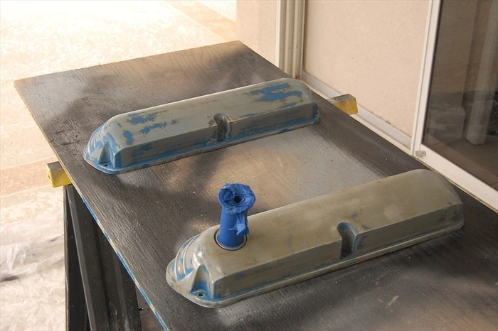

  15. I don't know where they came from, but they are no longer the same. The stencil work isn't very clear and the covers themselves are not very well painted. The paint is flaking off in many places and isn't consistent. Additionally, I just didn't like them.
    I painted them aluminum/silver yesterday and they're currently in the garage curing. I'll post up some pics of the paint process as well as after I get them re-installed.

  18. So I got the valve covers done and put back on the car.
    0_0_1dba38b27e279382bb845cd4ee63af43_1
    0_0_71792a31c671e7454cc8e891e96021e5_1

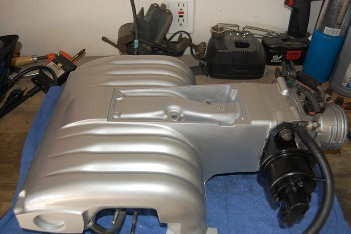

    I also got the intake manifold cleaned, sanded and painted. I put all the accessories back as well.
    0_0_aeafe57bc7346d6d91c20bdf22e1223f_1
    I have the intake cover plate, it's just not on since I need to re-install the upper manifold first. I tracked the lower manifold and it is scheduled for delivery on Friday, but I'm out of town for work next week Monday - Thursday so it will be next Friday, at the earliest, before I can start putting everything back together again.
