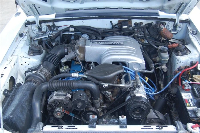

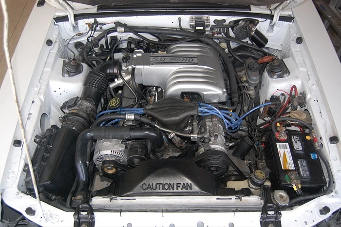

    Just for grins, here's a shot of the engine bay last March. The car had a short ram intake when I bought it, so the stock airbox was purchased and installed by me.
    0_0_918550dc0a0b8ba23e85c50490ca3627_1
    0_0_9348977060a33269730f02e8e56fd385_1

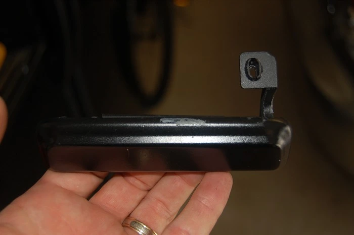

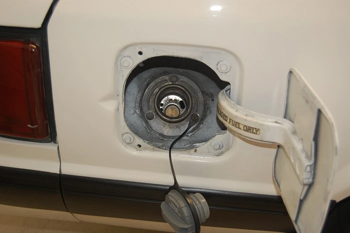

    More big changes today :D

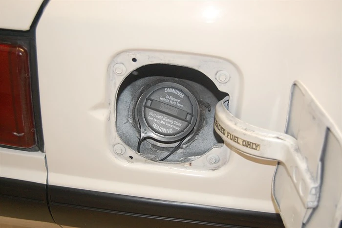

    Replacement gas cap from RockAuto with the attachment strap
    0_0_70559a0c5100a3e547da492da0d7d7db_1
    0_0_93c82034c421f47c8d7960f645b13b46_1

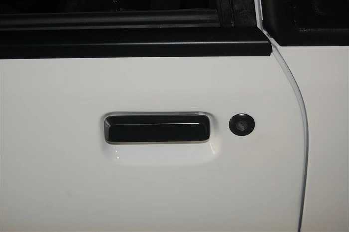

    I also replaced the driver's side door handle. The one I replaced it with a few months back never worked quite right and was always very loose; loose enough that the top of the handle was rubbing on the door itself. I went ahead and replaced the handle again, seems to be fine.
    0_0_5f019c285385b37c36824f7a670d60be_1
    0_0_045686fd8161c021b7efafd2fdf15635_1
    Big dollars here and lots of time...

    Did you rivet the new handle on or bolt it?
  7. boostfrk
    boostfrk Active Member
    Joined:
    Aug 30, 2011
    Messages:
    685
    Likes Received:
    58
    Trophy Points:
    29
    Location:
    Colorado
    Having a Dos Equis as a type.
    I bolted it. I used a bolt with a lock washer on the exterior and a nut with nylon insert (lock nut) on the inside of the door.

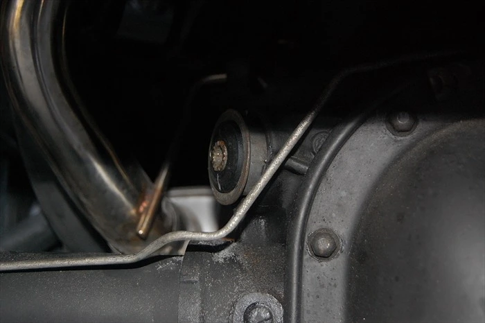

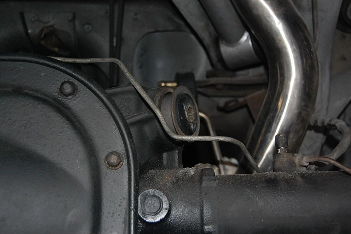

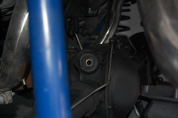

    Colorado

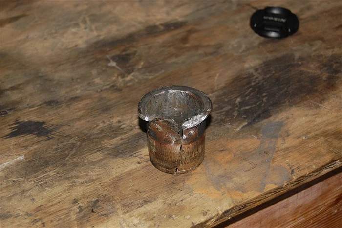

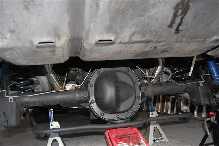

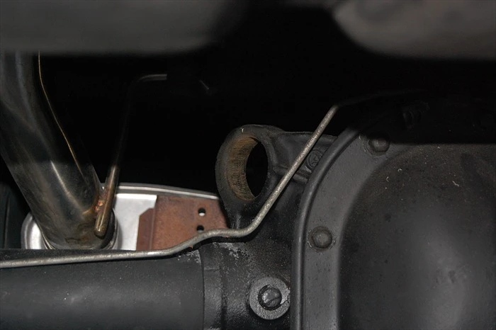

    So I replaced the upper axle housing bushings today with a set of OEM replacements (rubber). When I swapped rear ends the rear end I bought had poly bushings installed and I didn't bother changing them out before I installed the axle. I got some pretty decent axle noise in the cabin, so I hoped changing back to the rubber ones would reduce some of that transmitted noise. It appears to have worked.
    I used a balljoint press rented from Advance to remove and install the bushings and sleeve. I also used a hacksaw to cut a slot in the sleeve to aid in removal.
    Bushings ready to come out
    0_0_5918ed4bac4a47eb66bced6bf23c911b_1
    0_0_b80c3f7f44abdc00a5a16e1f73dd7df5_1
    One bushing sleeve removed from axle housing
    0_0_e78e17f38f53e064fb472a34eff21c58_1
    0_0_d07d6360d07aa70121ba34c20a5cca29_1
    New ones installed
    0_0_7f9ac2436c92d01e724bcff36b1a2060_1
    0_0_8f2adc110efa35d76e84bde580a55024_1

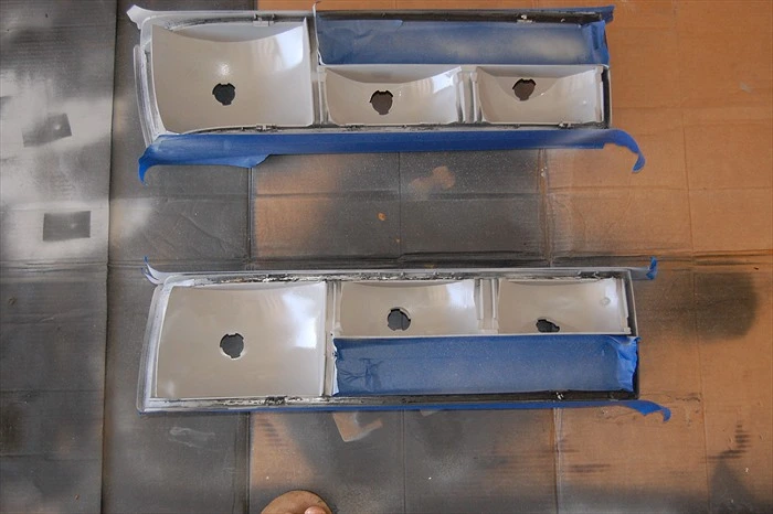

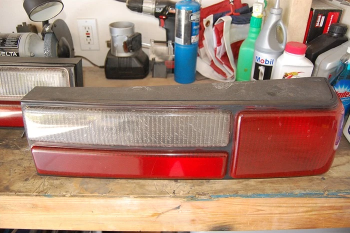

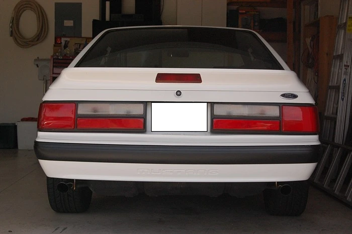

    I swapped out my existing taillight lenses for a set of refurbished LX ones. Mine were in OK shape, but not fantastic.
    Old light
    0_0_636a76ac30947fe080eacc5db63c1bc3_1

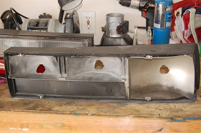

    Lens off; yes it's dirty.
    0_0_b7af53e3fe2b66d814e7ea1e0c6ee3cb_1

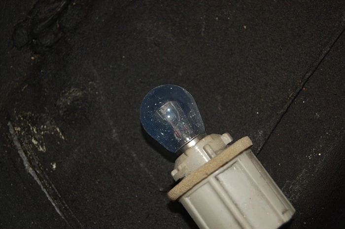

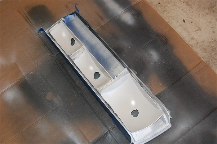

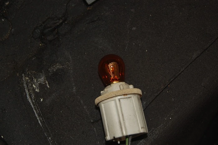

    I had read about a lot of older muscle car guys painting their housings white to give off the most amount of color from the bulb. Given the fact that my housings were kind of silver, but black on the bottom, a re-paint was definitely needed.
    0_0_4ea014e5cd4a3dd9326f2d6b94d13953_1
    0_0_41df3f19595311f4587f757e97ed933c_1
    Out with that super white/silverstar stuff and in with the OEM style orange bulbs
    0_0_e8b7d8d128ea99a8774989ba8929c920_1
    0_0_395e5fc77b5b027f10ba42c111458cad_1
    0_0_457bae65b383063611e14f5e6eee0648_1
    The right one seems a little cockeyed up at the license plate, but I've messed with it and messed with it and that's just how it sits.

    I think its your garage floor making the car sit unlevel making you think its the lens because that's what you just redid I think it looks alright but I've been told my head is a bit crooked.

  16. boostfrk

    I was comparing the trunk line to the line of the tail light. That's where it looks crooked.
    Either way, the car looks 100x better than when I bought it a year and a half ago.

    But seriously, yes the right tail light looks off (high on the inside and low on the outside). The lens probably isn't squared on the housing. Did you put new butyl tape on it?

    I know you were. New butyl tape was used and I've checked the lens on the housing, it's square. Things get squirrely when the housing is installed on the car.
    Again, I'm not too concerned about it.

    Maybe the lens needs to be installed on the housing crooked in order to appear "straight" with it's surroundings? American cars were notorious in the 80's and 90's for bad body lines and fender gaps so there was always "fudging" going on the get things to look correct.
    It would bug me. Good luck
