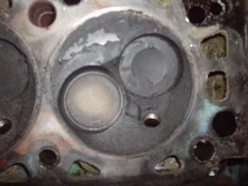

According to the shop manual the 87 NA 2.3 has a combustion chamber volume from 59.8cc to 62.8cc. According to the shop manual and AllData the Bore is 3.780/3.781, Stroke is 3.126 and Compression Ratio is 9.5:1. The post that I have seen here tends to suggest that 9.5 is incorrect.
My plan is to mill the head to reach around 10.5:1, however, I want to maintain the proper valve clearance without modifying the piston. I am also planning on changing the cam to one with a little higher lift. One post stated that for every .07 milled it would reduce the volume by 1cc. According to my figures I would need to mill about 0.49 from head. I’m pretty sure that I could take 0.60 and not have any problem with any cam, however, I don’t want to find out the hard way.
I have not CC’d my head (don’t have the tool) but would like to get a rough idea on how much to remove. I believe the volume on mine is around the 59.8cc range and doing the math would confirm this. (numbers.txt, chamber.jpg)
