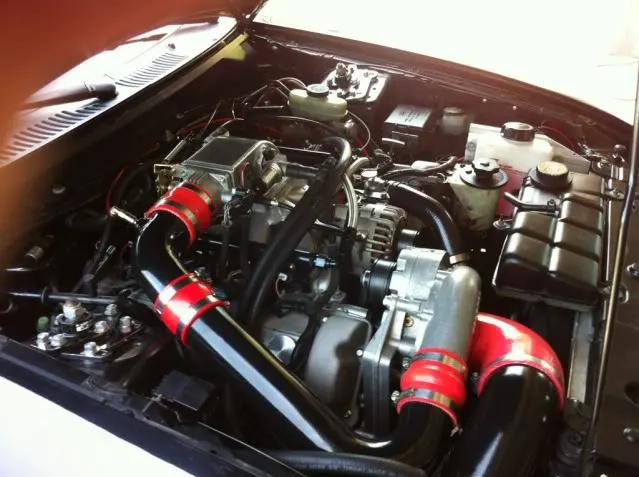

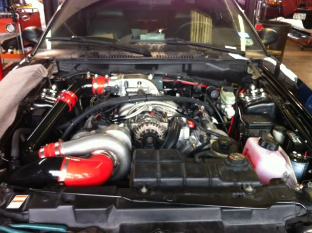

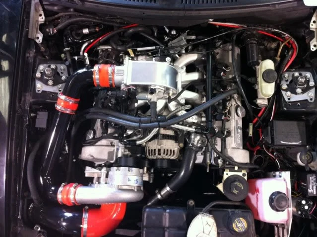

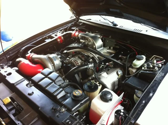

  7. OK fellas I'm back with an update. I finally got this thing together. After driving 300 miles round trip every weekend since August I got her fired up on Saturday. Of course I have a coolant leak from deck of the heads right by the thermo. Of course the build has been a nightmare. Whether it was the wrong parts or **** just breaking or needing to be replaced along the way Im elated that it is finally coming to an end.
    Here are a few pics of the finished powerplant.
    My leak is coming from this. Idk how I missed it when I was putting the intake gasket on. Have it filled with metal epoxy and letting it set for the week. Im pretty sure that the engine builder should not have given it back to me with this pitting. I paid for a complete rebuild of the heads including a port and polish. Also, they redrilled all the threads for the intake bolts but they used standard thread helicoils instead of metric :shrug:
    The place is supposed to be one of the best engine builders in San Antonio but I have not been impressed.
    I did get a quick vid of her idling. Still need to get the fuel pressure dialed in but she sounds MEAN. There is no exhaust at the moment but it was sweet music to my ears.
