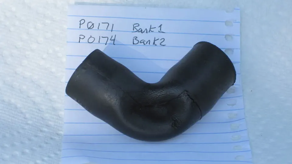

  5. The car is a manual transmission, and I was moving at 55 mph when it died. All the electrical components continued to work after the engine stopped. I just put the code reader on it and no codes were available. So on a hunch, I looked at the rubber tubing at the IAC valve and sure enough I saw the damn thing collapsing with every engine surge and I could hear it hissing. Now I replaced this tubing a little over a year ago, however I could not find an OEM part so I replaced it with a reinforced gas resistant tubing. I'm guessing that the tubing has gone soft already and is not able to withstand the vacuum pressure. When I completely disconnect it and try to start the car, it will not continue to stay running. I have another thread in the 4.6 section with a pic of that part. I believe in maintaining my car cause it's cheaper than having to fix it.
  6. Headed back into town to get a new elbow. I will get 2 and put one in the trunk. probably gonna take an hour or so.

  8. OK back from the store. Replacement tube did not solve the issue. However with it installed, I can now keep the engine running by turning in the throttle position screw so that it idles at about 750. However, the engine is still having trouble. After holding the RPMs at any higher level and then releasing the accelerator it dips to below 500 RPM (or lower) then bounces up to 1100 and will eventually level off.

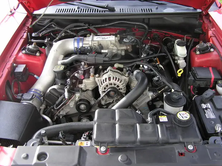

  12. PVC is in good shape, vacuum lines appear to be good from visual inspection. I don't hear any major hissing noises, but there still may be a leak (kind of hard to hear with the engine and fan running).
    Is my IAC the cleanable type? (this picture is not current, but it shows a better view without the cross brace)
  13. accidentally replied instead of editing.
  14. P0506 is a more generic OBD-code for idle speed too low.
    All of the things you mention -- brake loading, A/C clutch load -- and more (e.g. power steering cramp) are used by the PCM to use its idle air control valve to bump the idle a bit to maintain proper speed. I agree with wmburns: it sounds like the IAC isn't functioning. It may not be that the IAC is bad but it's the cheapest and easiest to replace.
    If it's not the IAC itself you might have wiring or PCM issues. Start with the IAC. Note that if you have fiddled with the throttle stop screw and replacing the the IAC fixes the problems you're going to have to re-set the minimum idle air (i.e. the throttle stop screw) setting.
    Jinx likes this.
  15. Yeah, I did not want to mess with the stop screw, but it was the only way to keep the car at idle, until I can get the issue resolved. I'm going to carry the hex key in the console to make adjustments daily, per weather temperature for now. The IAC valve is factory with about 100k on the clock and has possibly been cleaned once already. I really don't remember all the little maintenance things I've done in the past 10yrs with this car.

  16. No IAC is really serviceable no matter what anyone says. I have cleaned hundreds and it may allow them to work for a few more hours but that's it.

    For IAC, you can not use any type of pressure line. They do not expand but they cant keep from collapsing. You need a specific VAC line. Oreillys sells them in the helper section. Doorman makes them.
