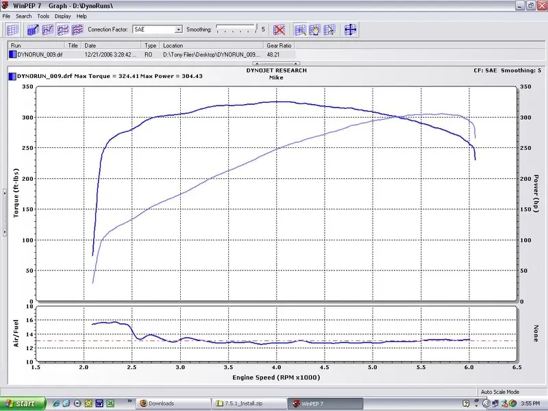

300 RWHP with stock heads and cam

  1. The peak HP/TQ numbers are impressive enough by themselves but what puts the icing on the cake is the torque spread (300+rwtq from 2700-5200rpm).

  6. I made 301/330 with AFR 165's (58cc chambers) free typhoon intake, TFS #1 cam, 73mm C&L, 24's and long tubes.
    I'm currently 600 miles deep on new combo, fti custom cam w upgraded springs, rpm 2 intake, 80mm pro m. I can tell it's got more power, I'm hoping 330 rwhp 301 tq this time lol, no seriously.
