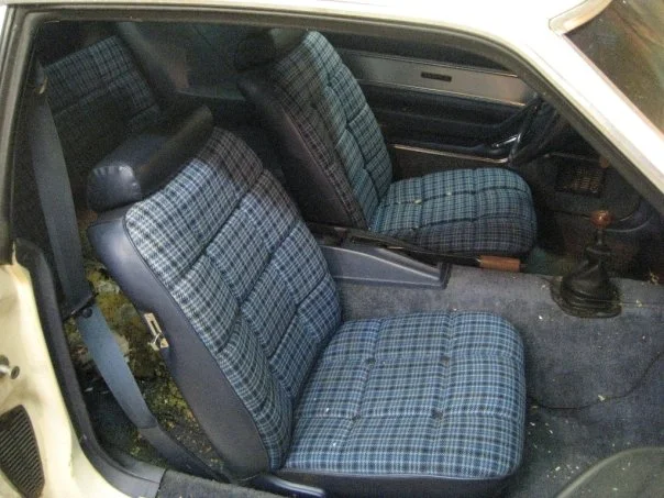

The cars were optioned many different ways. With a short, long or even no console.
