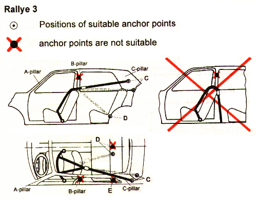

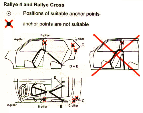

  13. I think having the mounting points on the floor behind the seat would only be dangerous if the rear of the seat is lower than your shoulders ( the stock seats would certainly have that problem). if the back of the seat is higher than your shoulders, then the belts would be compressing the seat, not your back. I have a 2008 mustang with leather seats, and I love them. I might look into seeing if they would fit in my 68.
  14. That behind-rear-seat/wheelhouse-and-trans-tunnel mount has me thinking
    Gonzo,
    Thanks! For a convertible, those look interesting. The behind-the-rear-seats mounts, I mean, for a harness. They straps could be tucked nicely out of the way . . it would help keep from having to do a crossbar high up behind the rear seat where the convertible top folds . . and be a lot safer than 40 year old lap belts. I might end up doing that. It's either that, or custom-make a removable, bolt-in roll cage for those times when I don't trust my fellow drivers or want to hit the drag strip. :rolleyes:
