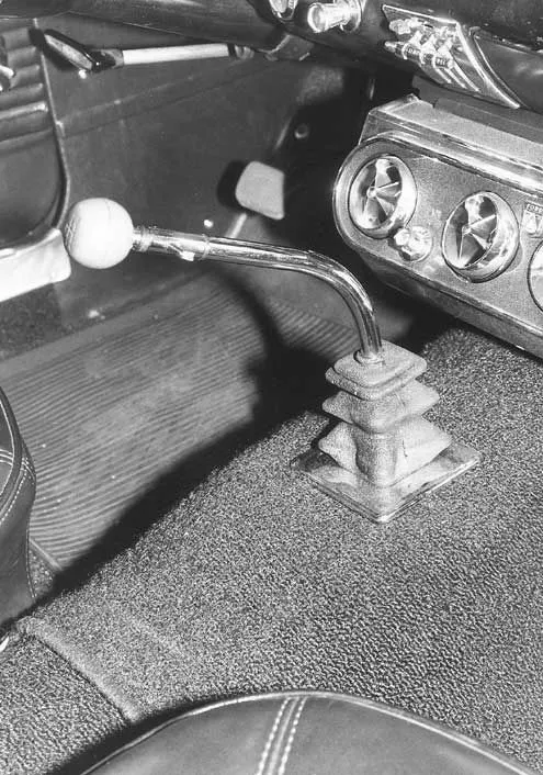

One question about a T5 install though. Will the shifter from the T5 align with the shifter hole in the transmission tunnel on my 67? Or will I have to cut another hole?
