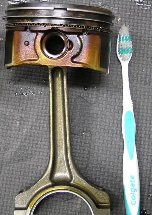

    That's our stock rod...
    FYI, the stock 3v head flows around 240CFM, ported heads can be over 300 CFM (supposedly Livernois has ported a set to 350+ CFM).
    Yeah, 65 ci difference, thats 23% bigger, a **** ton.
    Like I said, I think 400RWHP on a stock short block should be possible with the new intake manifold coming out. 450 RWHP on the stock short block, I wouldn't rule it out but I don't think we will see it on anything other than a purpose built race engine that revs over 7k.
    Who said anything about being scare of compression, we just have 9.8/1 stock. A built short block with 11/1 or higher compression would give a decent jump in power. I think with the 323 ci short blocks coming out, add 11/1 compression and we could see 500 RWHP out of these engines N/A.
    But like I said, without adding cubes, compression or boost (or N2O) 400 is the soft ceiling.
