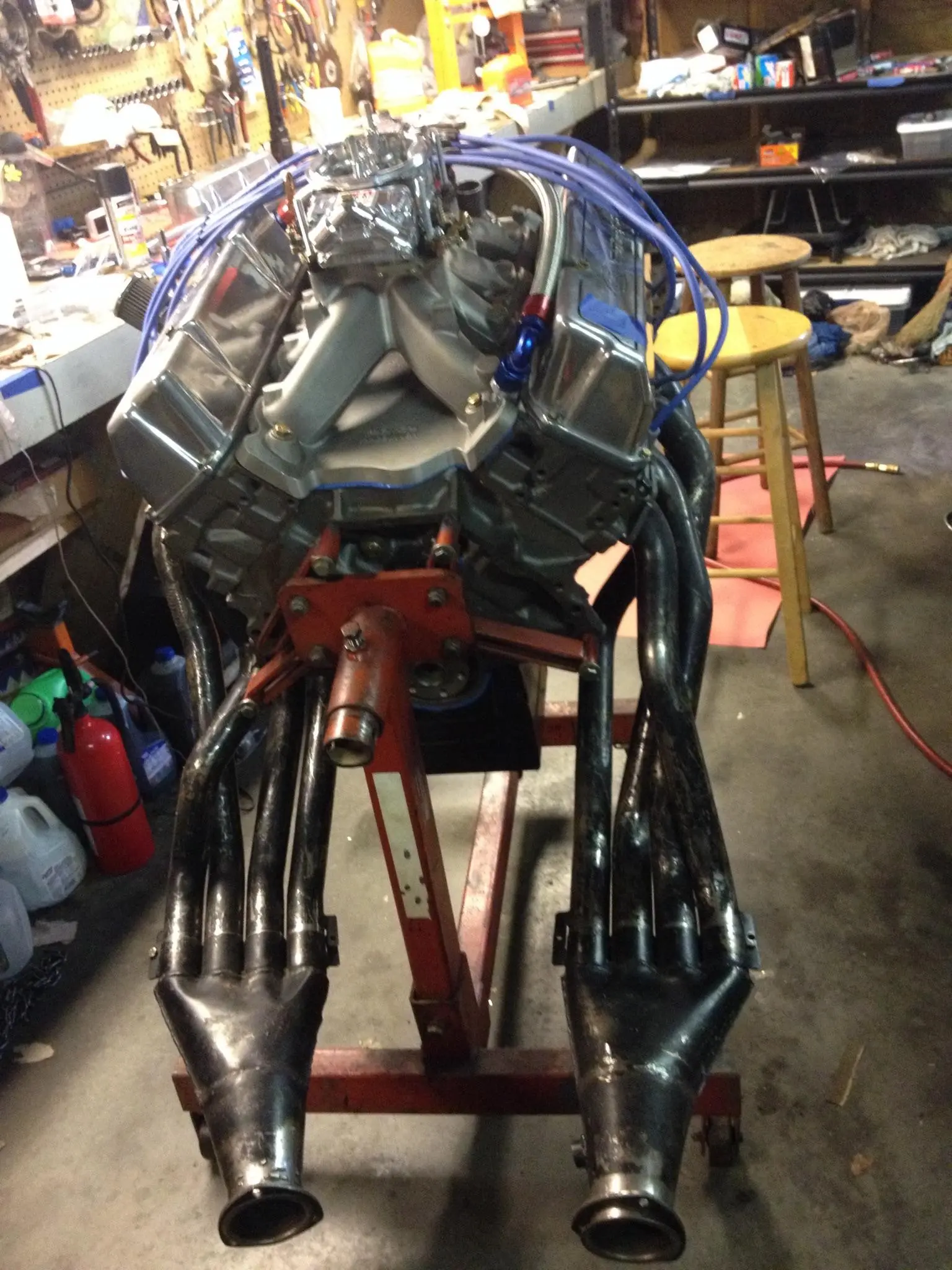

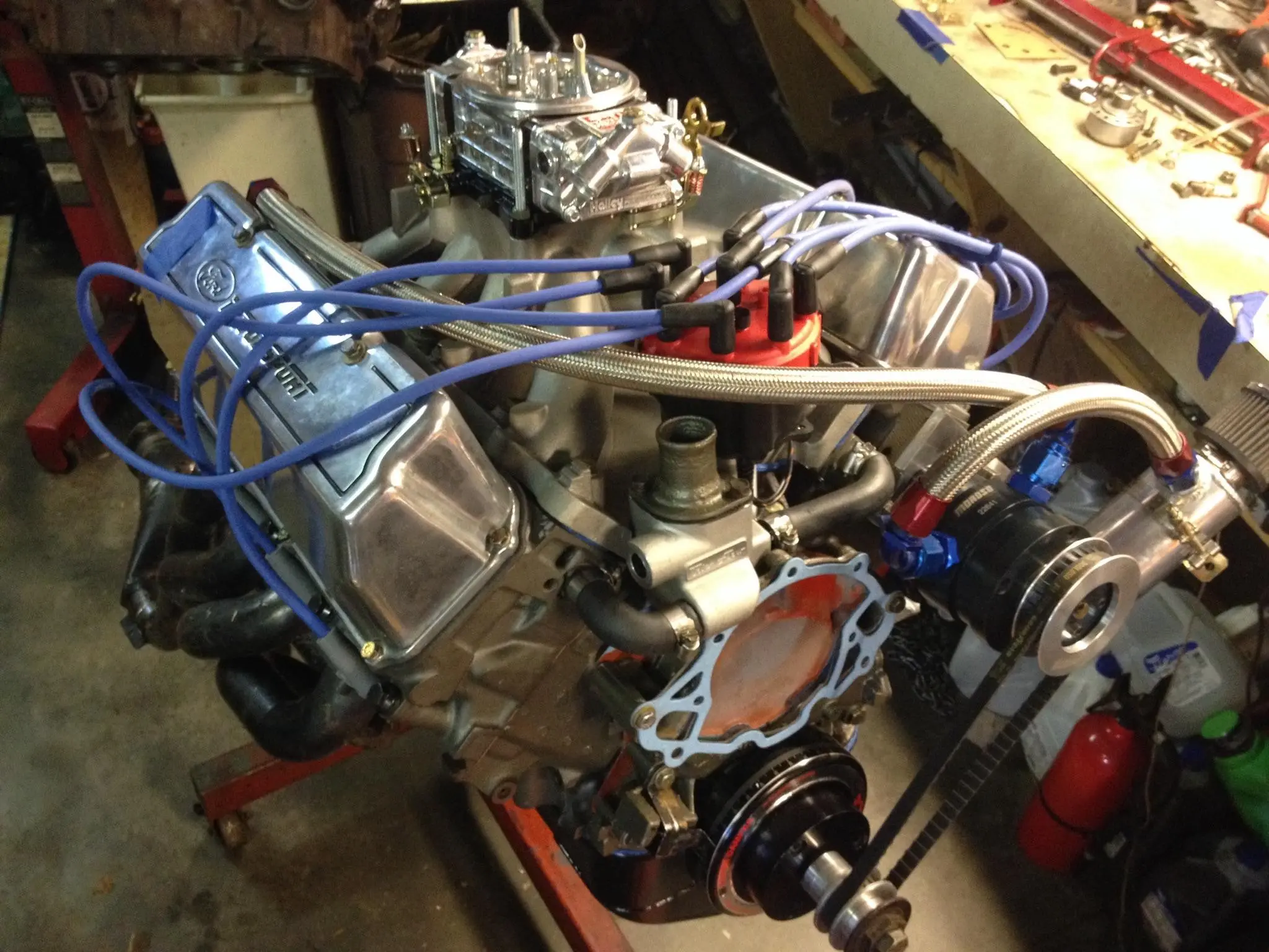

Some of you may remember me mentioning (or maybe not) that my father n law has been building a kinda odd ball engine over the last few years. He is very meticulous and takes forever to get stuff done. I believe this has been a 4 year project. Here are the details:
-351 Roller Block stroked to 408 with light weight ibeams and 4340 crank
-iron 4 barrel heads with extensive porting and reshaping (believed to be old nascar take offs)
-titanium valvs
-custom comp cam spec solid roller (don't remember specs, but it's big)
- 1 7/8 longtubes
-tfs single plane clever intake with port matching
-custom carb, 900 cfm I believe
-13:1 compression
Just for giggles, let's hear a few guesses before I reveal the results....
