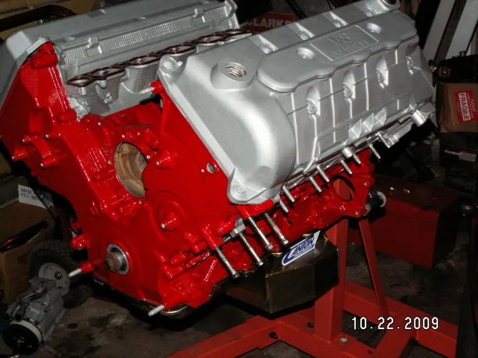

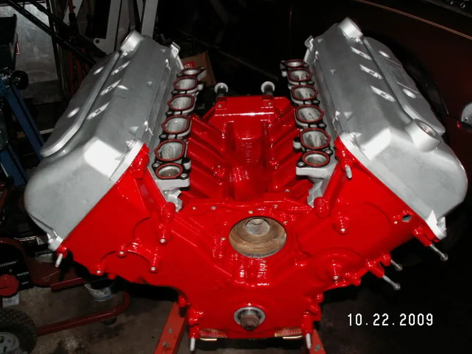

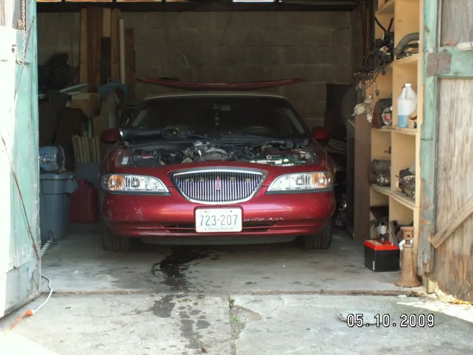

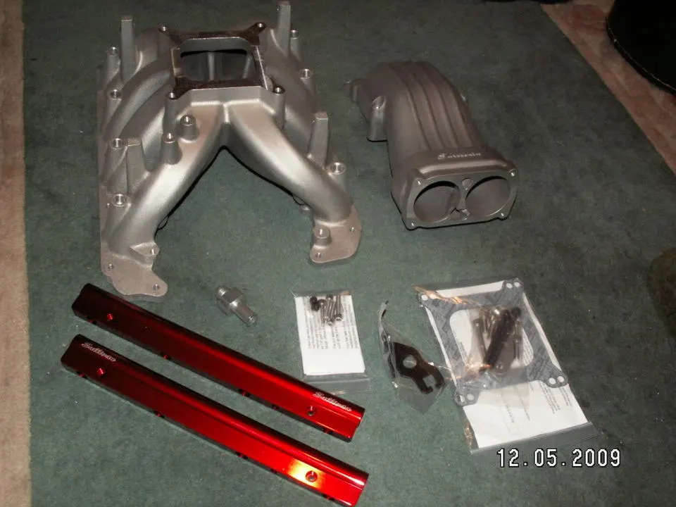

    I'm putting a 5.4 in a Lincoln Mark 8. I'm using a Sullivan intake kit. So ill have to figure out what to do with the old Teksid block and b heads.....:rolleyes:
    I hear the 32v C heads arent the best....the Aviator heads are actually better. But this car will eventually get a Kenne bell so the loss of a Few CFM's doesn't really matter.
    Motor cost me $700 Intake Stuff $1500 Machine shop $1000
    Heres some pics
    The Car
    Motor + Some paint
    Some Sullivan stuff

    who make's the intake kit?
    Sullivan intake kit?

    Yea, holy **** there on drug's > there's no way i'm going to pay that much for a intake set-up > I'll run the stock intake before that happens .
