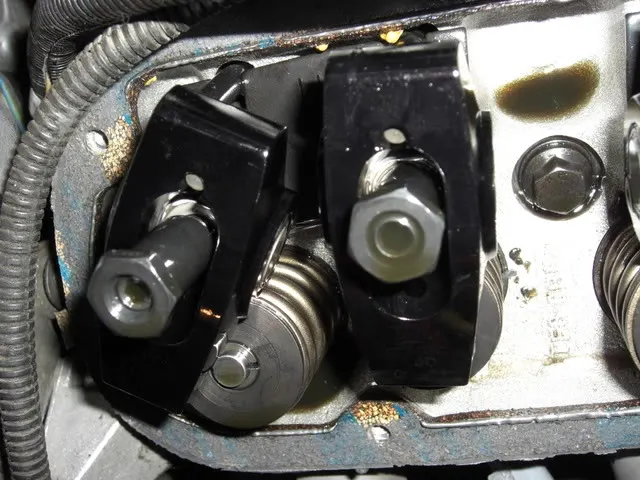

  18. I removed the valve cover and everything looks fine :rlaugh:
    Can I just reset this and put everything back together? Can someone please tell me how to set roller rocker arms (I'm assuming I did not set them up right in the first place) Thanks for the help! :nice:
  19. Probably not. You probably bent the valve and might have damaged the piston. Also I can see debris in the pic (off to the right hand side by the rocker).
    When valves hit pistons it's bad. Mmmkay?
  20. Is the rocker stud broken?
    You really need to pull the lower intake and look at the lifter and cam as well. I willing to bet they're both damaged. As giddyup suggested, I'd pull the head and look at the piston too.
    Trick flow heads/rockers? Trick flow cam too?
    Also, the polylock on that rocker is set in a different position relative to the rocker next to it. Do the other cylinders have a difference in polylock height btw exhaust and intake rockers?
