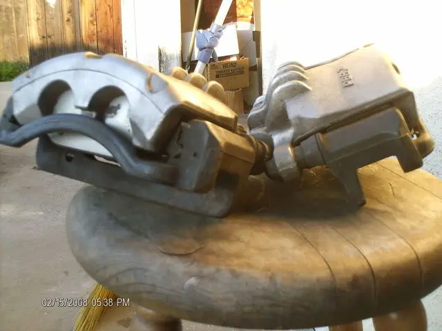

  14. OK so getting serious of going 5 lug, if I have stock 4 lug rear with Strange axles and C clip eliminators. Can I make the SN95 components work with my axle housing and axles (a 5 lug version of my existing axles)?
    for the fronts...I want to be able to run the 15" wheels but want to go 5 lug. I found one guy who has a the hubs and spindles. Another has cobra calipers. Cobra calipers are to big for run 15" welds wheels right?
    Scott
  15. With C-clip eliminators, its hit or miss. I honestly do not know if SN95 compenents can work with them.
    Up front, if you want to stick with 15" wheels, you can't use the cobra brakes. Instead, run the 99-04 GT/V6 PBR caliper instead. It will clear 15"s, is alumium so it's lighter, and has a large clamping surface area.
