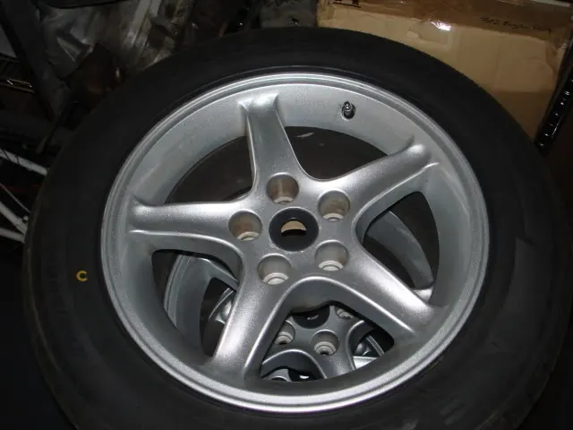

yes you can run these. I ran a set off an 02 bullitt and they look great. With those springs you will probably have a little rub in the front but nothing bad. There is a guy on Corral that makes and sells the .330 spacer for the front spindle. fit perfect. Have fun.
Sweet... I actually came upon a real good deal for some 95 cobra's
400 rims/tires... two tires brand new, two tires with lots of tread left.
The guy needs 17's to fit over the brakes on his 65. So i will be picking these up tonight.
I just need the breeze rear rotors and a couple weatherhead fittings and i'll have everything.
