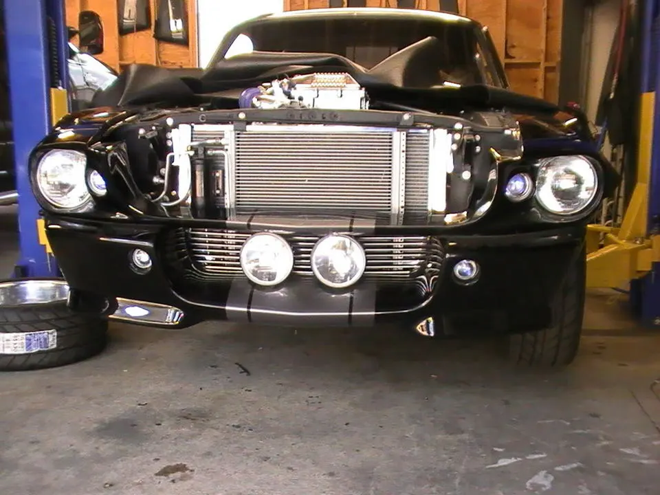

  3. Radiator, SPAL Dual Fan Control, Rear Seat Latches
    The radiator is installed. Upper radiator hose, dual 1710 fans, SPAL PWM dual fan control (one fan comes on at 50%, up to 100% then the other fan comes on at 100%, A/C will turn the initial one fan on at 100%). All the A/C lines have been installed. Front lower grill has been permanently mounted.

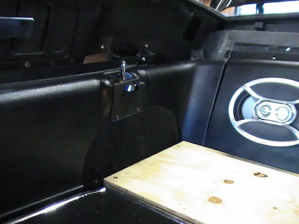

    The rear seat latches have been finished. Since I did the mini tub, getting all the little pieces to match up and work properly took half a days work. But they are done!

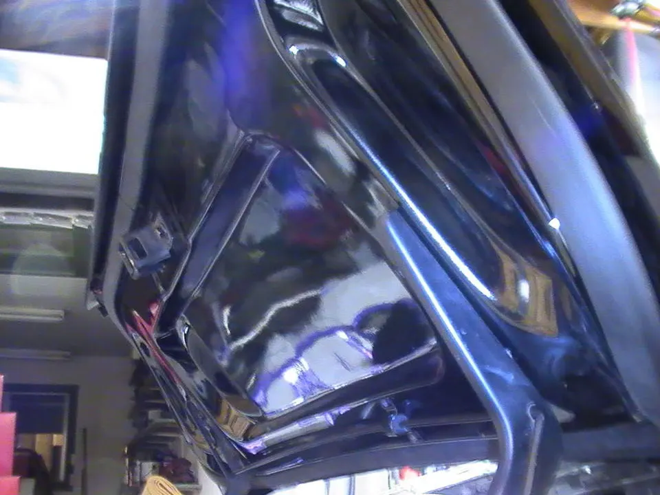

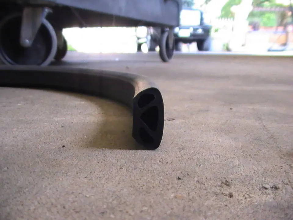

  7. What weatherstrip did you use on the trunk and how did you attach it?

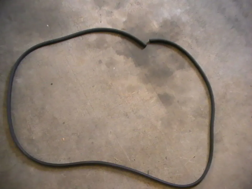

  8. Trunk Weatherstrip
    I used this weatherstrip. I can not tell you the manufacturer, as I got it from UP.
    Satisfied, yes. I thought I was going to have a problem with closing the trunk lid. Quite the contrary. This stuff is not big enough to seal in one place for sure. I used 3M 8008. Excellent stuff.

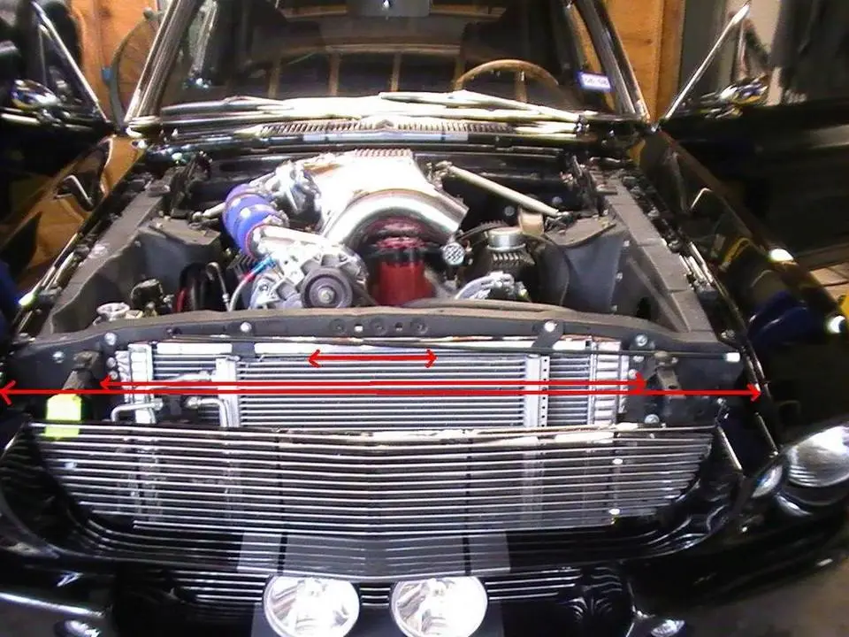

  14. Radiator to Upper Grill Shroud
    Hood still off till I get the EFI/Dyno guy over here. I Changed the plugs because they were fouled.
    Not many new parts are left to put on.
    I am thinking about making an upper shroud for the attachment to the upper grill. Since I moved the radiator forward 1 1/2" , the old hood latch bracket wont clear the condenser. I have to make something. Either something small 8-12" wide, all the way to the hood pin brackets, or something that goes fender to fender and under the top grill slat.

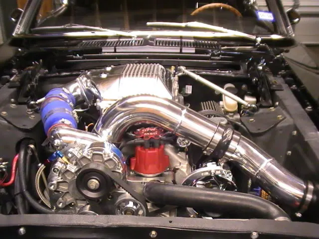

  15. Cold Air Intake
    I built the cold air intake. There is 12" of round air filter underneath that fender. Still got to get those blue hoses off.
    I took it to the gas station (without the hood) and it has to be filled VERY SLOWLY.
    It caused quite a commotion. Many picture takers!

  20. Water Temp Sending Unit & Air Filter Shroud
    I had to install an extra water temp sending unit. If I tapped in to the EFI water temp probe, it may have caused a LOW temp reading by dividing the signal. So I tee'd the manifold, and added the dash gauge water temp sending unit.
    I also built an aluminum water shield (2 sides only) for the under-fender 12" long conical air filter.
