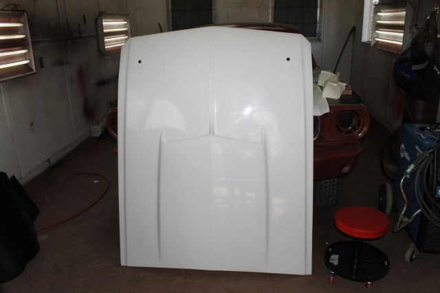

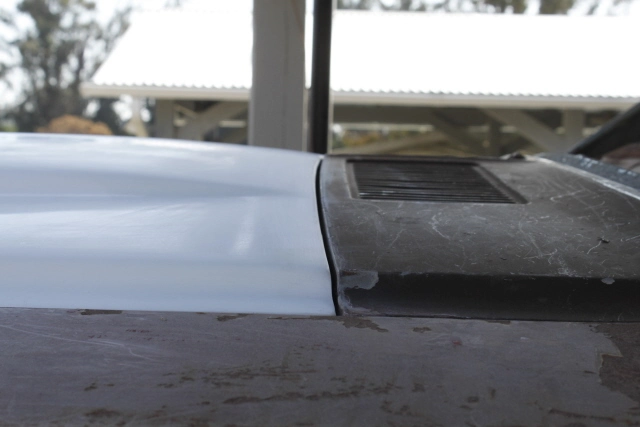

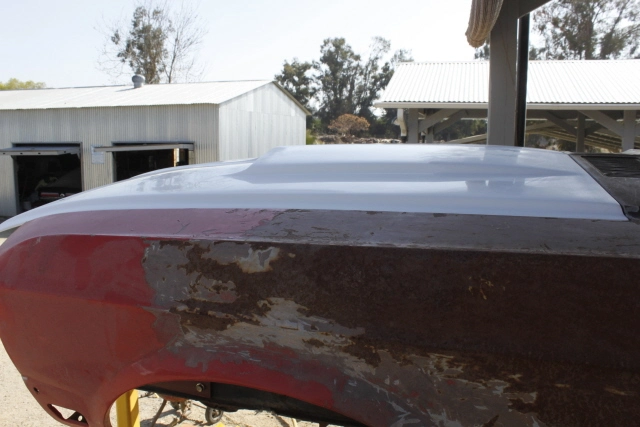

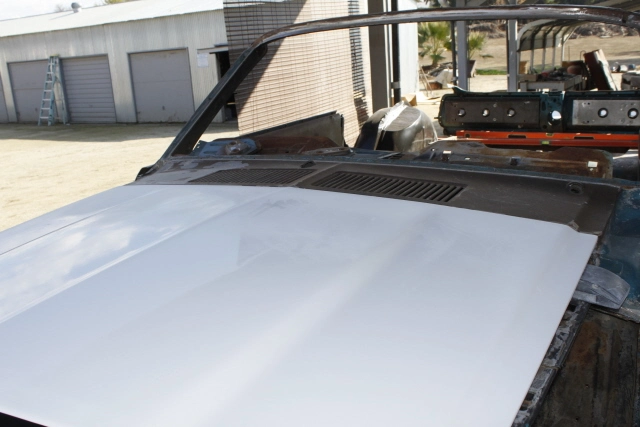

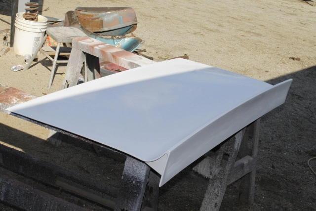

    Picked up my hood and trunk lid today. very nice and heavy pieces. the hood fits up to the cowl really good .
    i still have to get the nose section but i need a new set of front fenders first. I needed the trunk lid to align the quarters . Been raining the last couple of days so i didn't get any thing else done ,hopefully i will get the rear seat area by the week end. _MG_4256.JPG _MG_4257.JPG _MG_4259.JPG _MG_4260.JPG

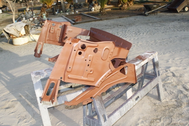

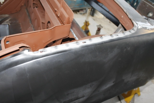

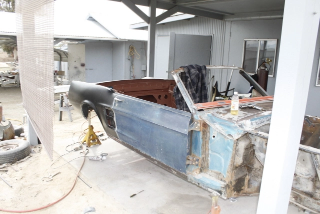

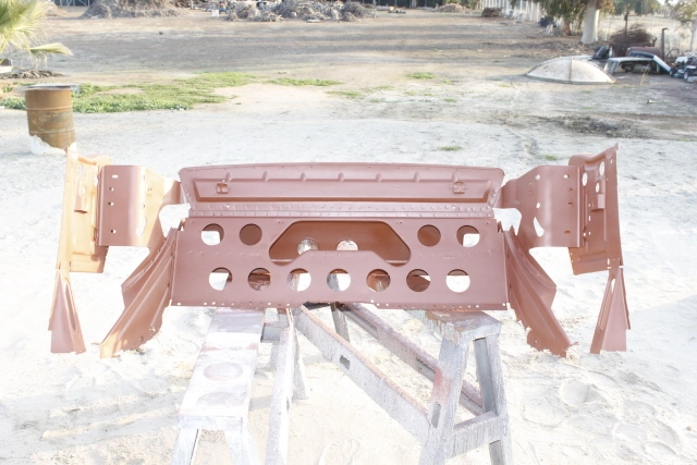

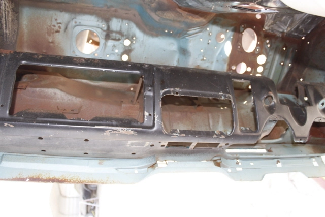

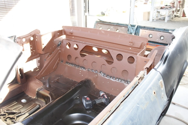

    I trimmed out he back seat area ,so many spot welds :drool:.It took most of the day to drill them all out. It blasted out very clean.I shot two coats of primer inside and out . I want to primer inside the car ,just where the seat divider goes so there will be primer under every thing.
    The lower braces need to be patched along the bottom but every thing else is in good shape. I still have to trim out the rain gutter part that the quarters set on ,and blast it and prime it then i will be ready for quarters. _MG_4261.JPG _MG_4263.JPG _MG_4262.JPG _MG_4264.JPG

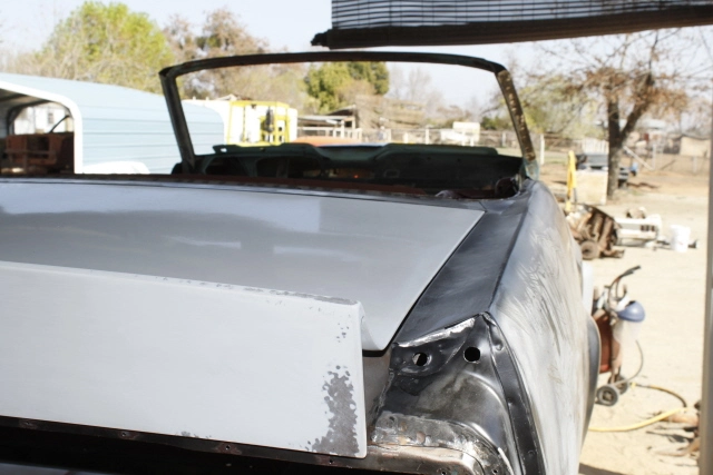

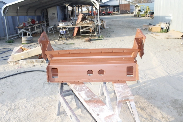

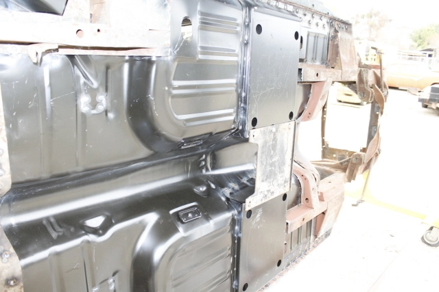

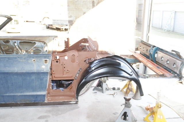

    And the back seat divider is in. Went in real easy . i sat the quarter in place and it lined right up . I have to trim out the rain gutter and sand blast and it will be ready to weld in .I think i will wait until its on the rotisserie before i grind the welds , won't be long now. _MG_4267.JPG _MG_4266.JPG _MG_4265.JPG

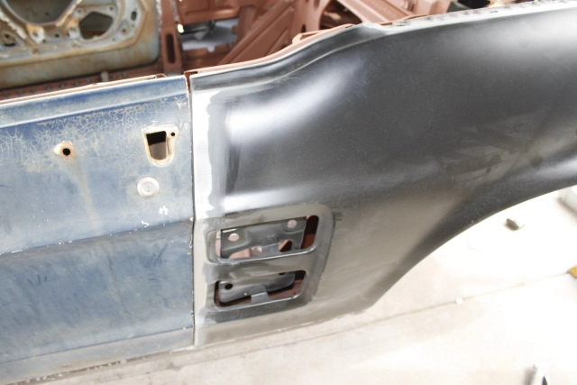

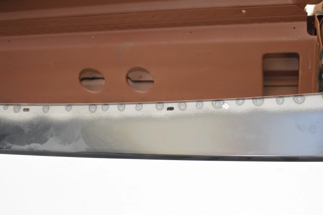

    Just who was it that got the idea to powder coat replacement panels?:fuss:
    The quarters are powder coated ,i can't sand it or sand blast it off .I worked at it most of the morning and i removed more skin from my fingers than coating on the quarters .I finally got the edges cleaned off so i could use my spot welder. The rain gutter and back window strip went in with out any problems .The driver quarter is about half way welded .It fit fairly good except where it met up the the back window panel,i had the quarter on and off at least 5 times just working this area,it is a perfect tight fit now. i lined the quarter and back window strip up with the trunk lid to make sure it stayed square ,it is going to fit very well . _MG_4270.JPG _MG_4269.JPG _MG_4271.JPG _MG_4272.JPG

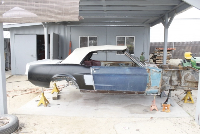

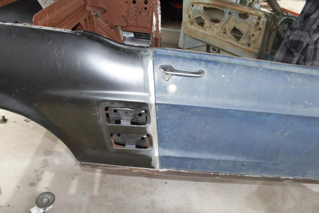

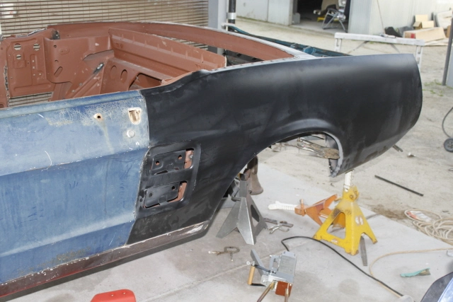

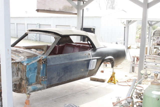

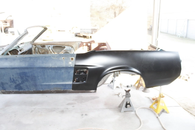

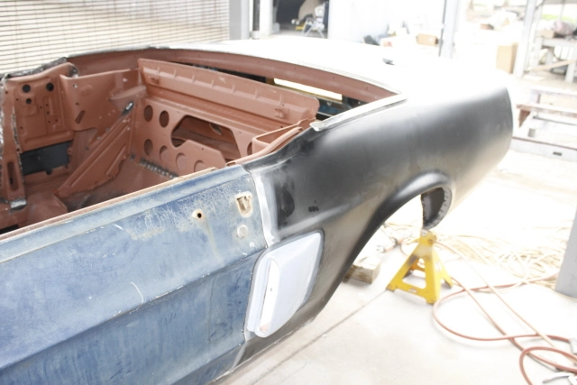

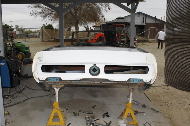

    The body is finished .I had a bit of trouble with the pass. side ,the quarter wasn't the best but it worked out .The door gaps are pretty good ,i left them a little wide from the top down ,about 1/16 wider at the top .Every convert i have had sagged and the doors would touch the jamb at the tops so i preloaded the frame rails to make up for it. When the car is assembled it should close up just right.
    The trunk lid fits great and lines up with the end caps . I let the end caps over hang the quarters at the sides just slightly so i can sand them in for a perfect fit.
    Tomorrow i will fit the side scoops.It is ready to go on the rotisserie but it is supposed to rain so maybe next week. _MG_4273.JPG _MG_4275.JPG _MG_4274.JPG _MG_4276.JPG _MG_4277.JPG

    Looking great. the gap on you tail panel to the qtr extensions looks so much better than mine - my tail panel looks 1/4" shot on each side. I'm not sure why mine is short.

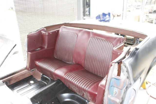

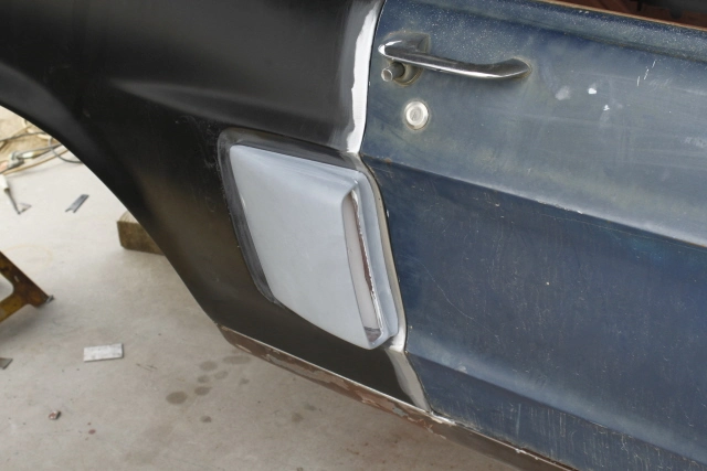

    The side scoops only took a few minutes , i need to fine tune them a little bit by sanding where they rest against the body but they look great right now.

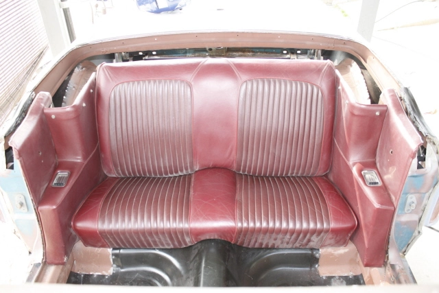

    I put the back seat in just to make sure every thing fit and it does .
    i used the top from my 68 convert ,just had to see what it is going to look like , i am almost ready to take it out for a test spin:rlaugh:. Now i have to break it all down and bolt it on the rotisserie. _MG_4278.JPG _MG_4280.JPG _MG_4282.JPG _MG_4281.JPG _MG_4288.JPG _MG_4286.JPG

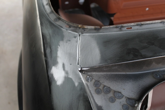

    The 68 panel has about a 3/16 -1/4 inch gap compared to the 67 panel.
    Dynacorn spot welded in the ends in these quarters and got them wrong . I had to drill out the spots and push in the sides and re weld them so i was able to get a real tight fit.

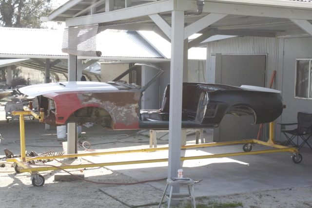

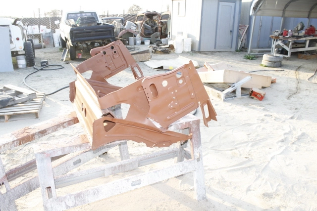

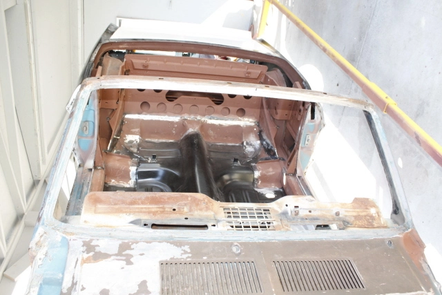

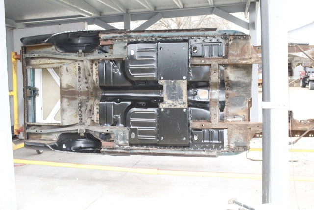

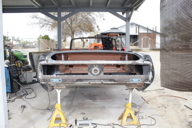

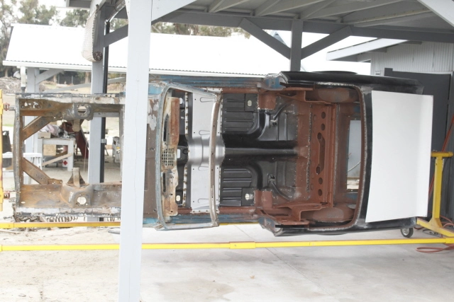

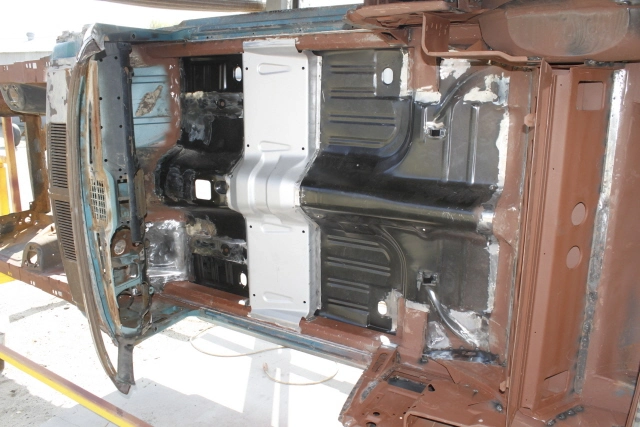

    Bottoms up ! It's on the rotisserie . I finished all the spot welds under side .
    I have to extend the floor supports because i had to cut the ends ,they were to to short and angled on the ends . The rear seat brace still has to be patched and and the hood hinge area ,the hood blew off, and the bottom of the battery apron and grind all the welds and i will be ready to sand blast and epoxy primer. _MG_4289.JPG _MG_4290.JPG _MG_4291.JPG

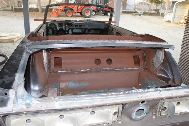

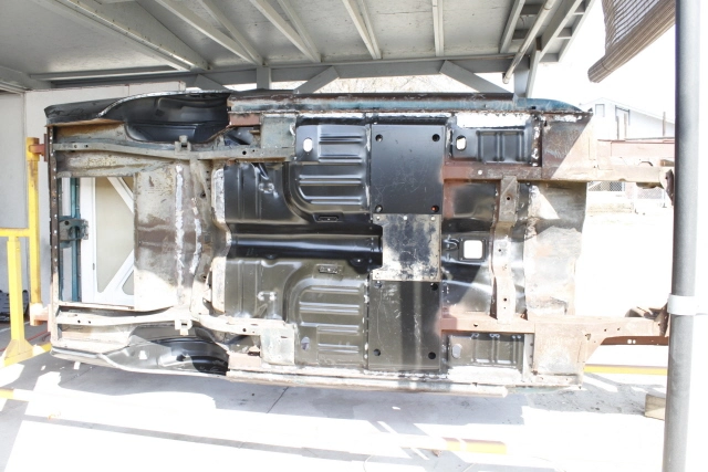

    I finished all the little patches ,there wasn't very many . The seat back side braces were the biggest .I extended the floor supports ,Ground all the welds .I used my spot welder every where i could so the welds look like factory .
    The under side of the cowl is in great shape ,just needs a light blasting . I am actually ready to blast everything and epoxy primer but we have bad weather on the way, and i am a little short on funds so it may be a while. _MG_4308.JPG _MG_4309.JPG _MG_4310.JPG _MG_4311.JPG _MG_4312.JPG

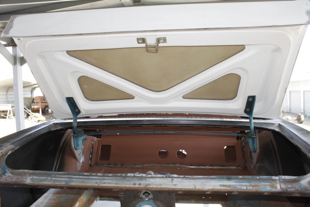

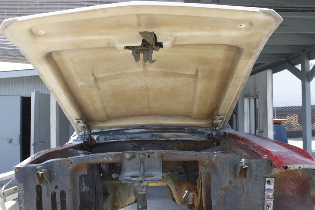

    _MG_4322.JPG I did some adjusting on the trunk lid and got a really nice fit. I put the trunk spring rods in ,on only the first notch,and it could take your nose off if you are not watching when you open it. _MG_4323.JPG

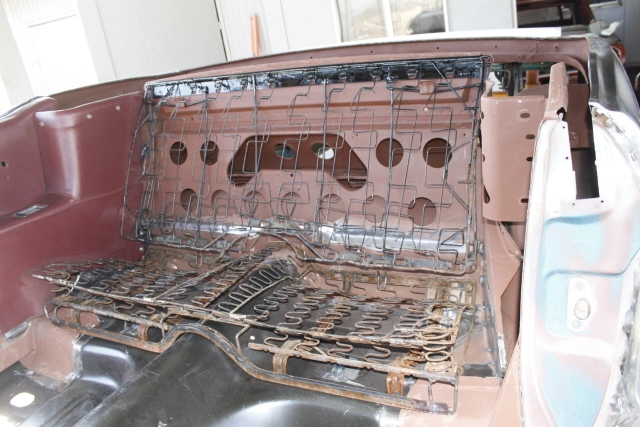

    I was missing the back seat springs so i cut down a set of coupe springs . I should have posted how to do it but i didn't think about it at the time:nonono: When upholstered you can't tell the difference ,and it's fairly easy.

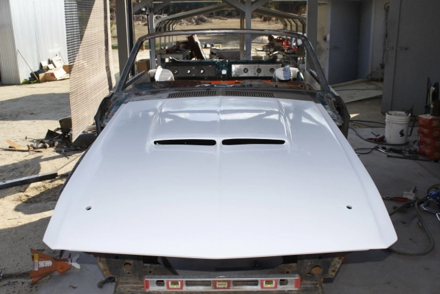

    I oiled my hood hinges and bolted them on then bolted on the hood .the hood to cowl gap is going to be very nice and the hood follows the cowl great. I bolted on an old fender that i keep just for fitting fiberglass,it is straight around the edges just a little beat in the middle.The hood follows the fender very good as well. This hood sounds like steel when it is closed ,can't wait to get the nose section but i still need the new doors and fenders first. _MG_4318.JPG
