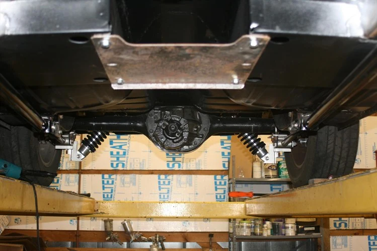

  2. 3/14/2009 - I got the tires mounted on the rims today and back on the car. Fitment looks really good as is.

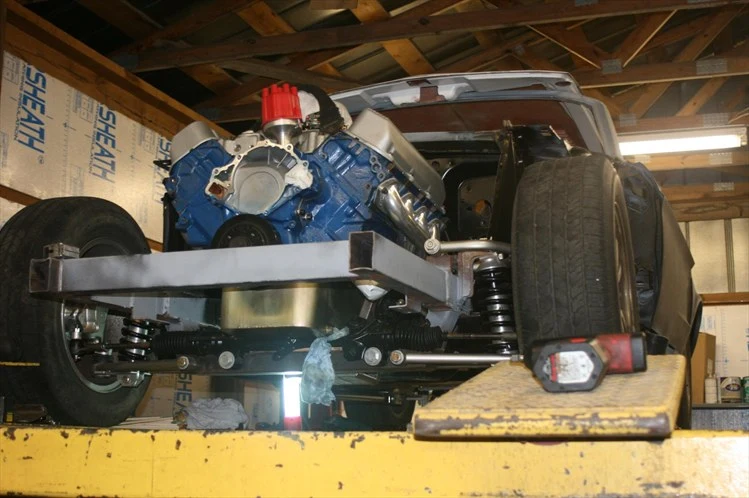

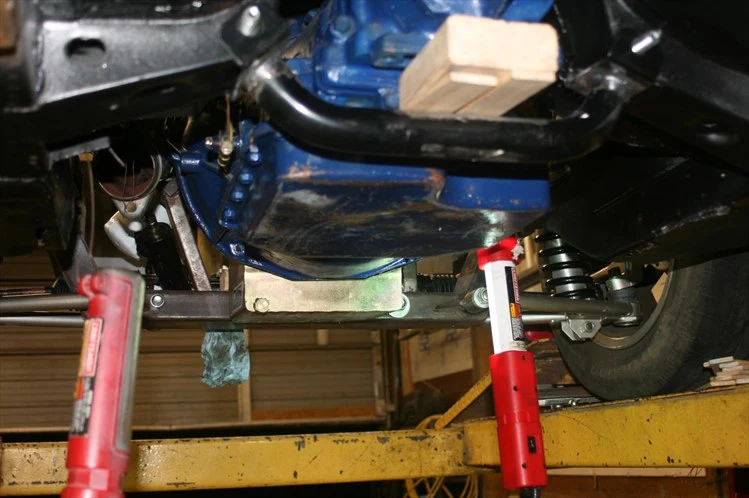

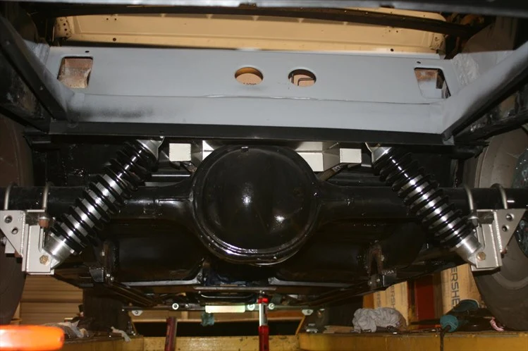

    [​IMG]
    [​IMG]
  15. Rendering Updates:
    Project Updates:

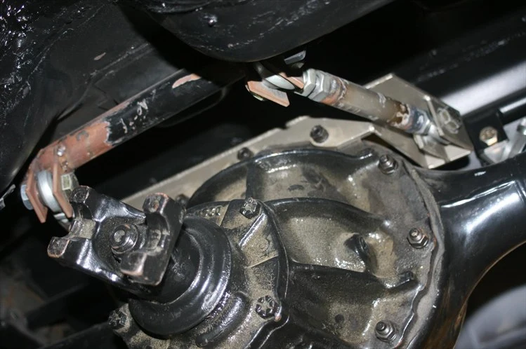

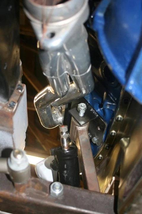

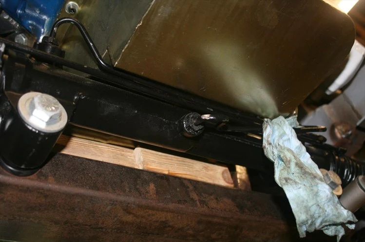

    My neighbor Chris as been helping me fix all the mistake that ### Racing made when they were working on the car and they made a bunch!
    * Mounted the subframe connecters - things were a little off as happened with old cars - Chris got it looking good. He welded the frame up real nice. :)
    * Had to remove the upper brackets on the rear suspenion - the previous guy welded in the front bar about 2" off to the drivers side; making the rear off to that side too. We cut the old brackets and welded in new ones. Also the previous idiot welded the rear sway bars brackets in backwards. We had to cut the old ones out and weld in new ones.
    * Making a new transmission bracket.
    * Getting the engine mounts in place and the steering system completed.

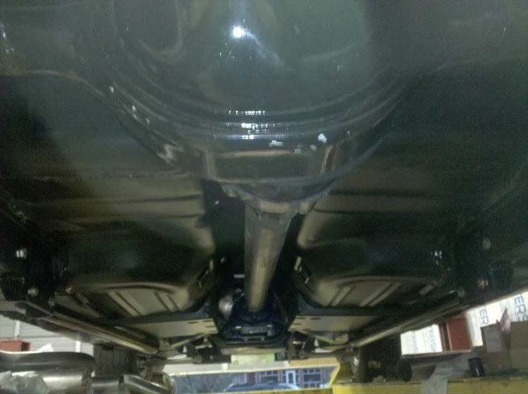

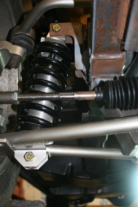

    UPDATE: engine was installed and taken back out for final tweaks and to finish weldinging the MII front-end and the rest of the suspension setup.
    Winter is slowing everything down.

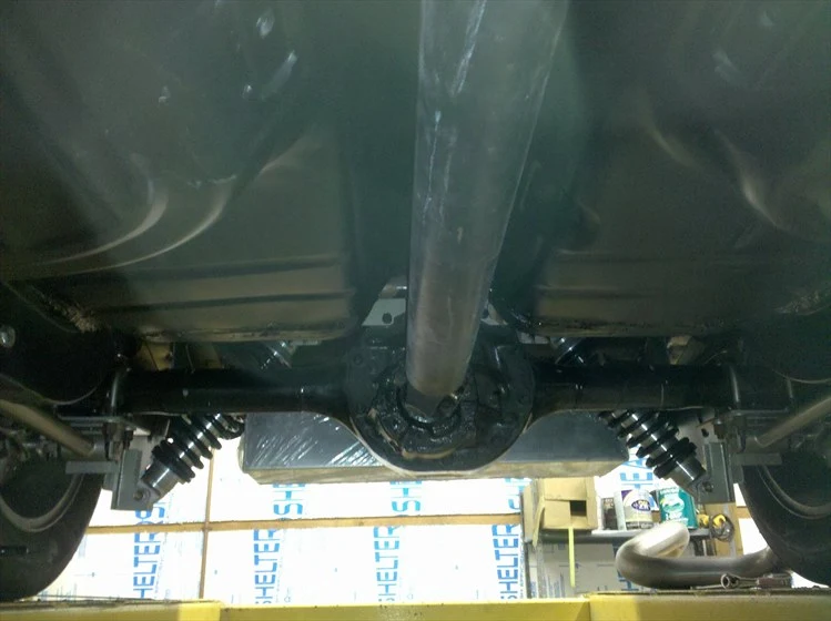

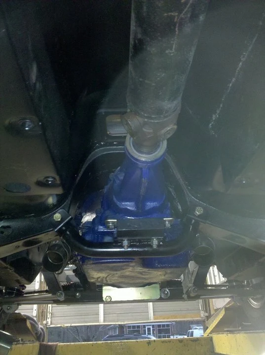

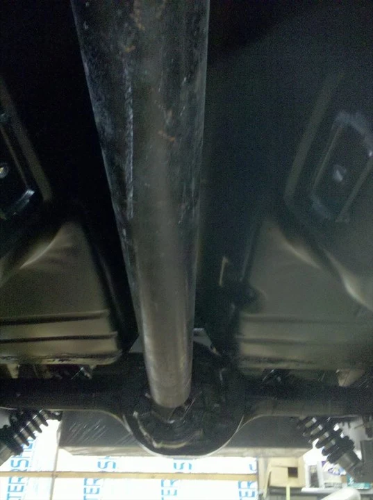

    Order the new drive shaft - this was the original one; about an inch short.
    The exhaust is being finalized.
