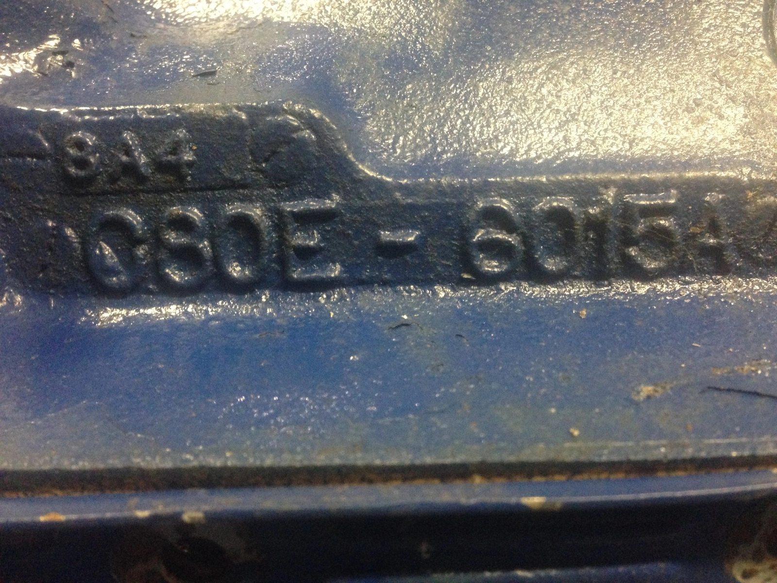

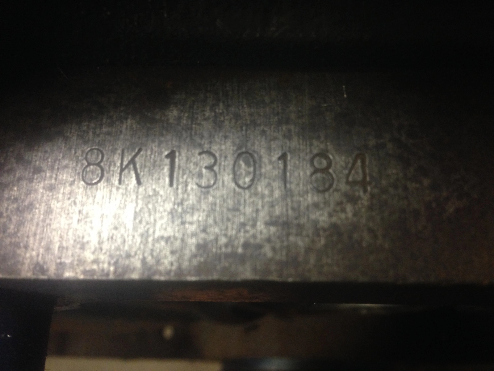

  1. Looking for some insight into this block, it's got a C8OE-6015A casting, with 302 in the lifter valley, a 1/4/68
    date code and a "K" VIN. Any info would be appreciated.
    In 1968 the 302's would have an "F" or a "J" ?????
  2. never heard of a 68 K code .could be a service block. does it have the larger main caps?
  3. That's what's weird. The caps are regular, not the wider ones like on a Mexican block.

  5. The K you see in the partial VIN identifies the assembly plant for the car in which the block was originally installed. K = Kansas City. I found the answer in another forum.
