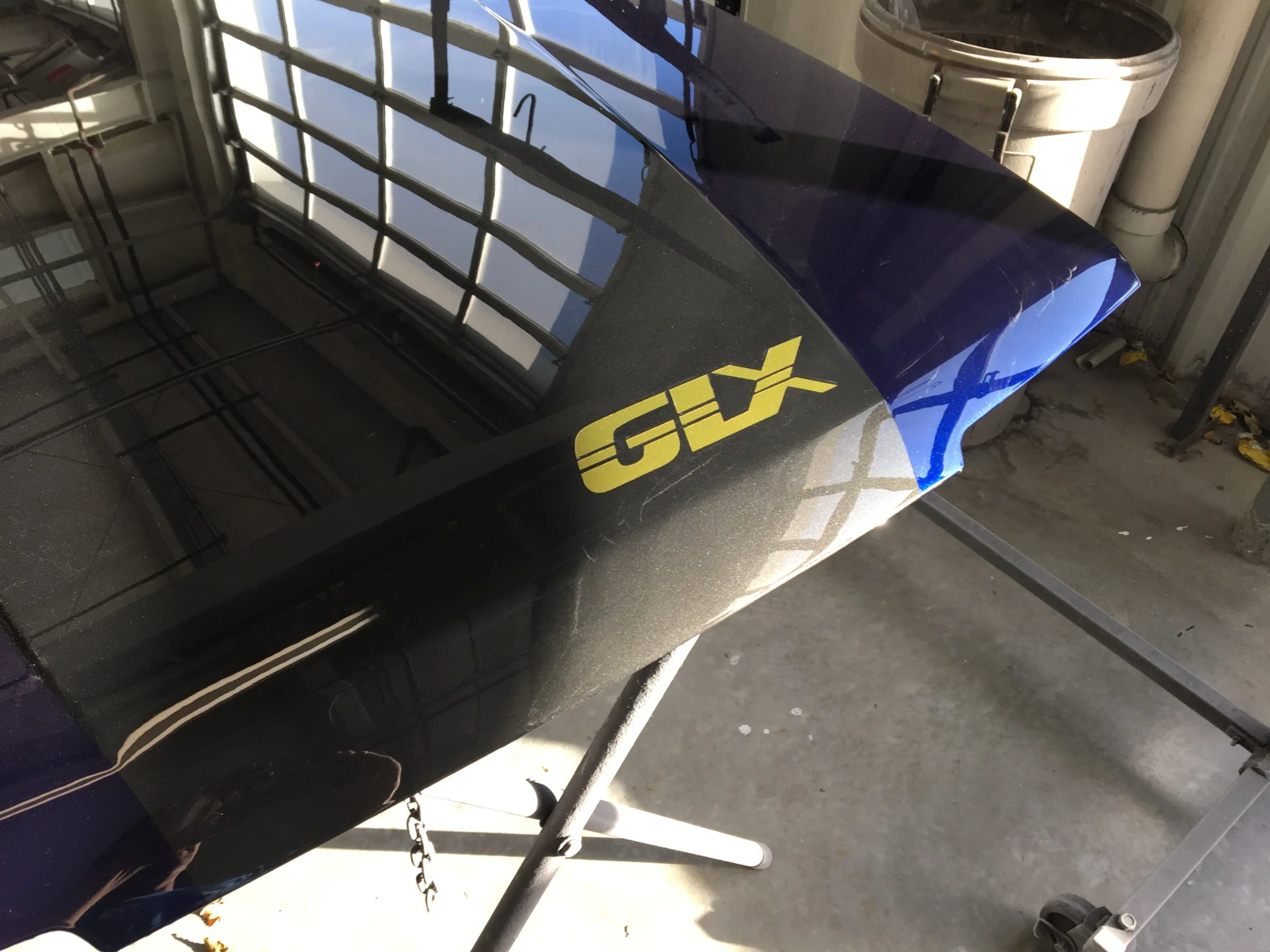

Shiny now.

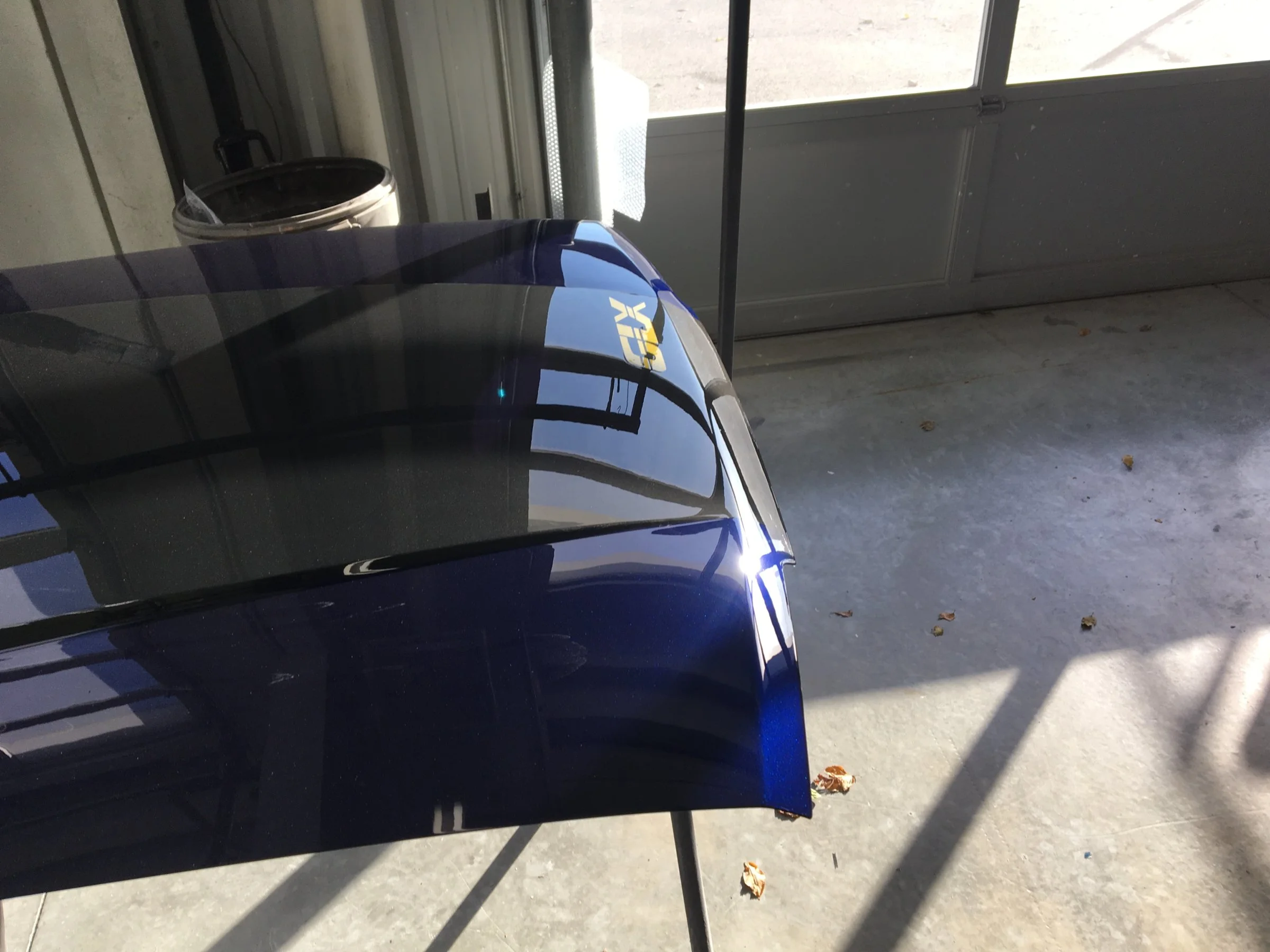

Now I will resand the middle, and spray it with semi-gloss. It might be Monday before I do that.
Reactions: 11 users
Stunning man, looks like you poured oil on it
Thanks man.
Honestly, y'all can get really smooth panels as well. After you've painted it, sand it down again with some 600-800 grit and reclear coat it. It's amazing what that does for a panel. You'll only need one coat more, I used two on this hood (really three over the GLX area) because I want to block the lettering out flat before I spray the semigloss over it.

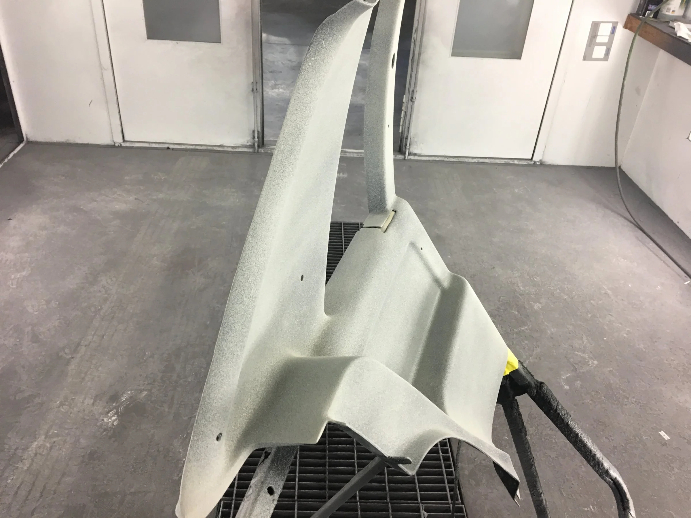

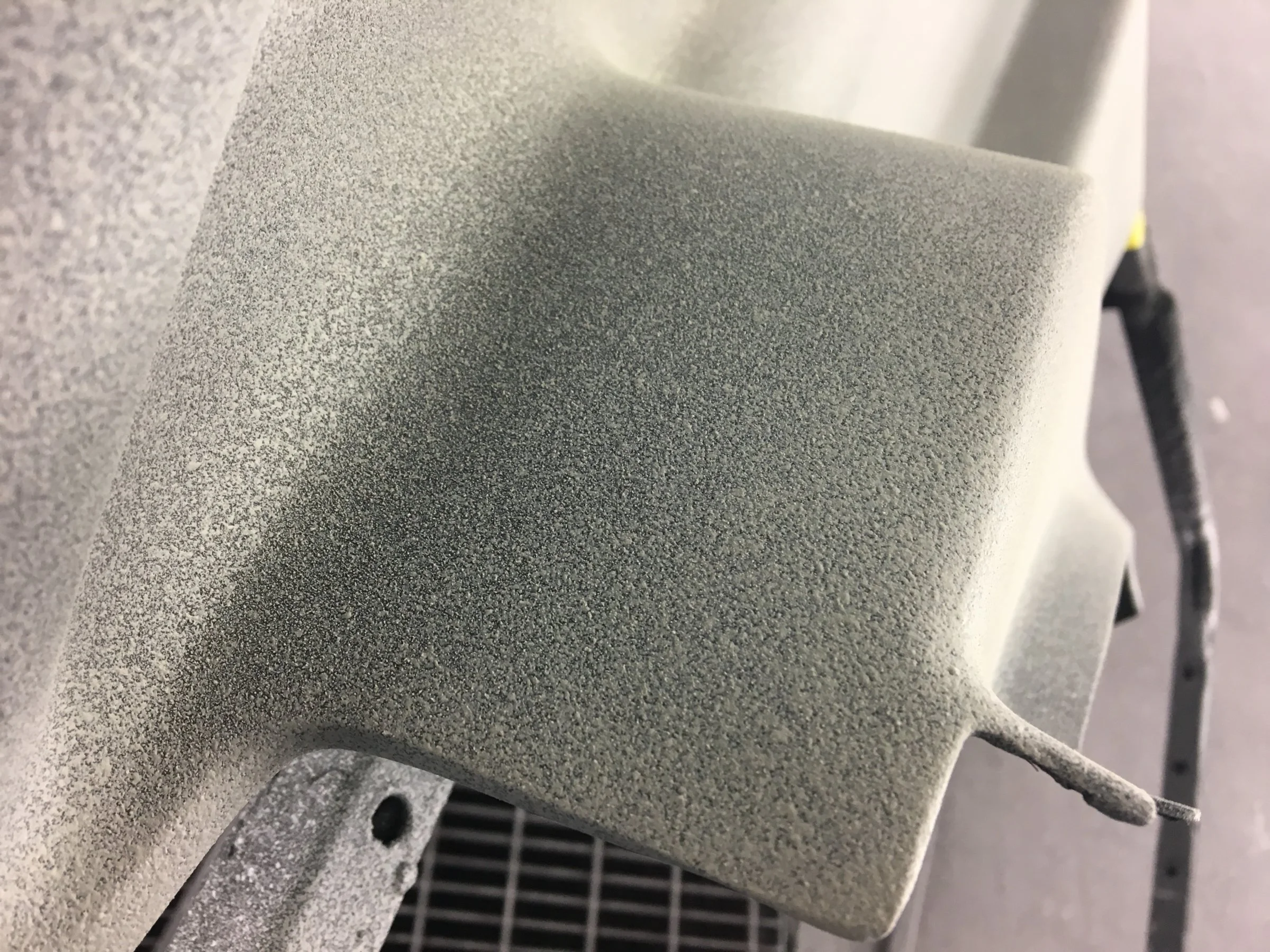

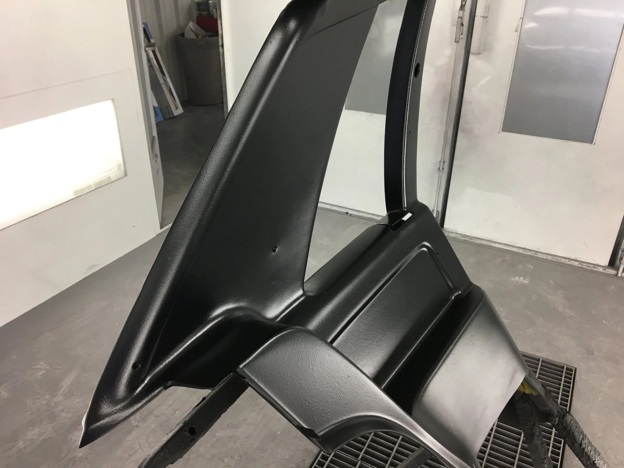

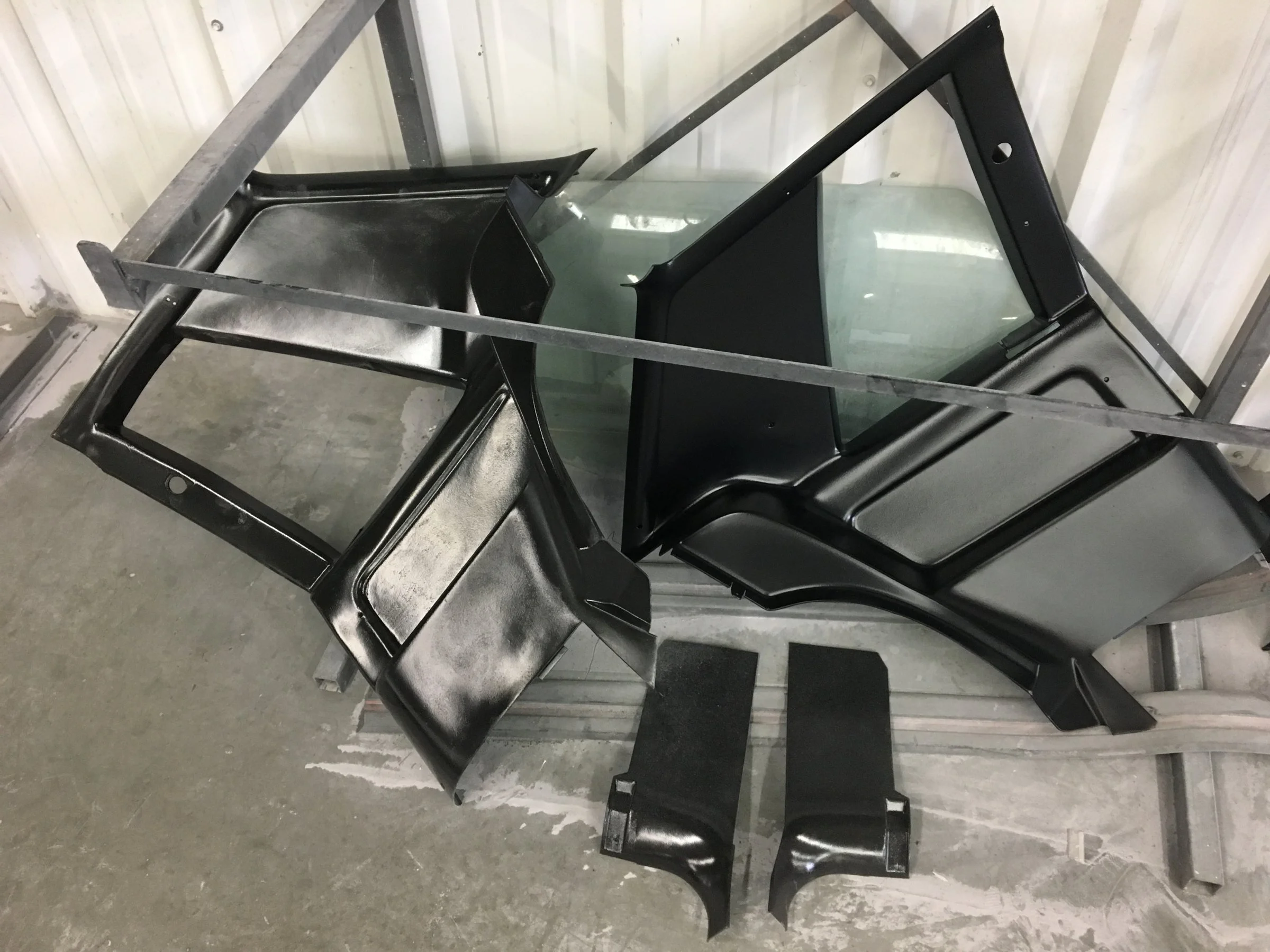

I got the left panel sanded down with 400 and sprayed the chip guard on it. Once that dries I'll sand it down lightly with 400 grit to just take away from the gritty feel, go over it with a red scotchbrite to score the rest of it. Then paint it, should be today sometime.
Here's a close up of the repaired area.

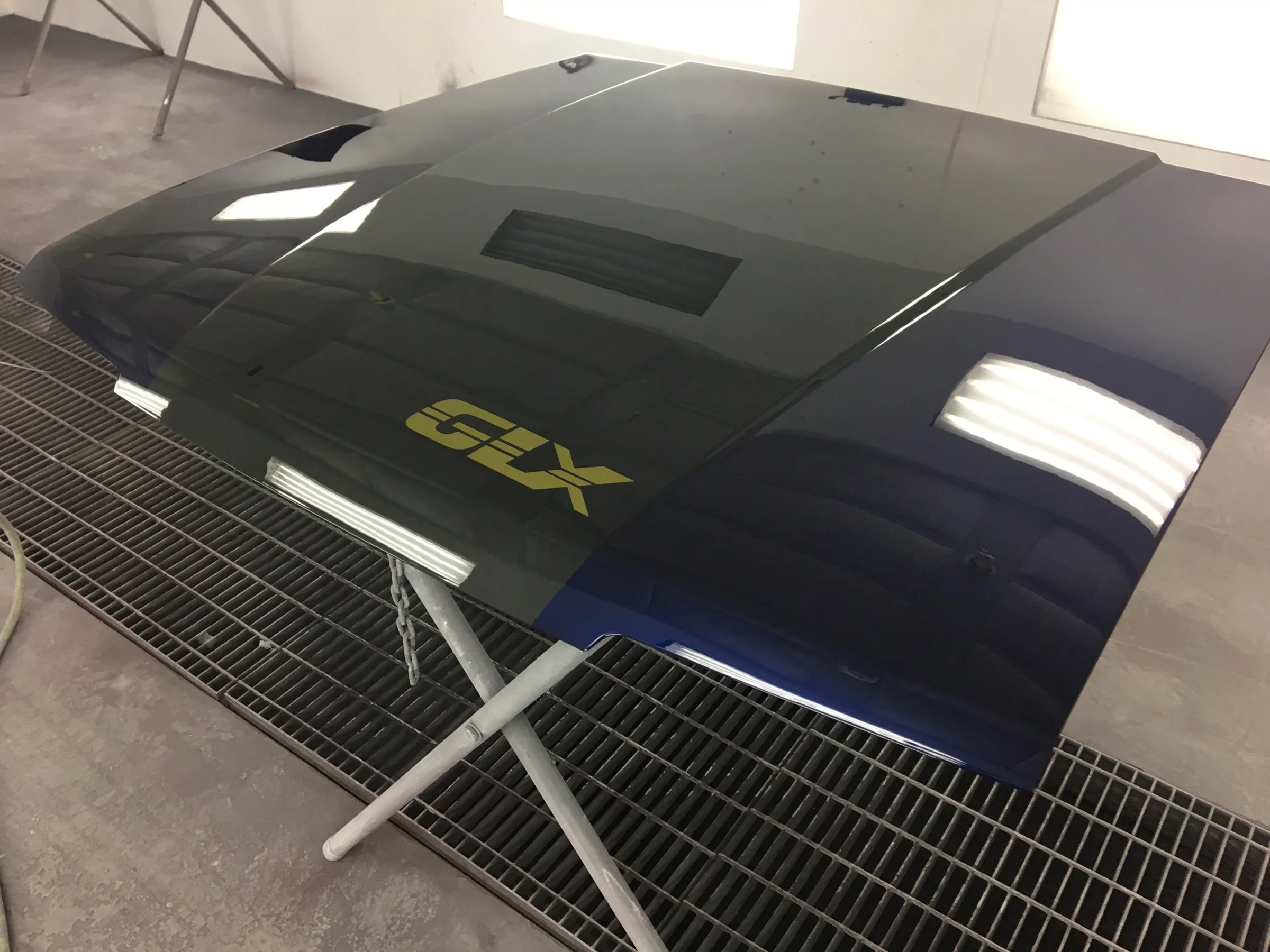

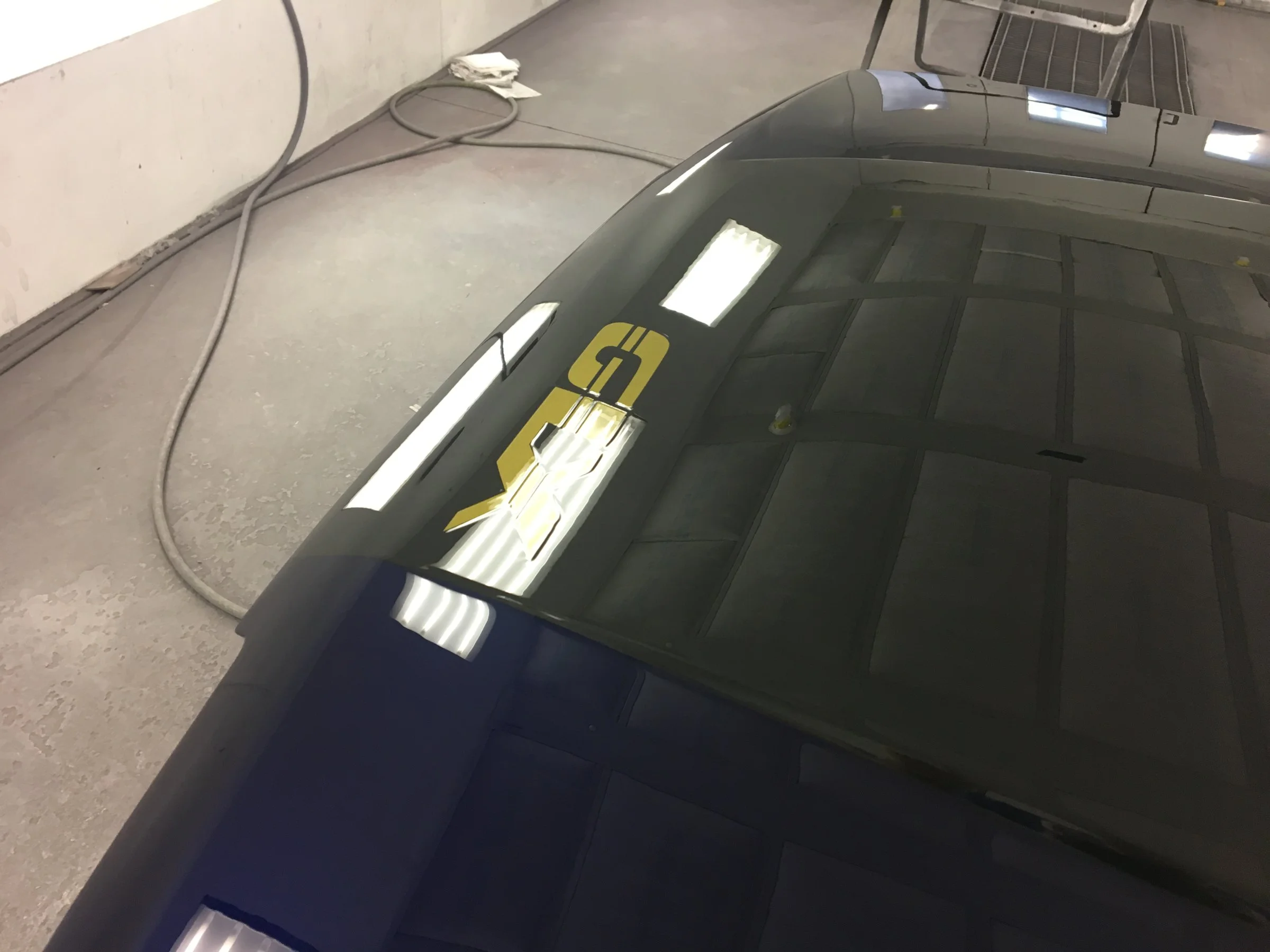

I figured out what I want to use. I sprayed a coat of eggshell matte clear and it had the sheen of the primer. Way too shiny. So I adjusted the mix from four parts matte clear and one part regular clear to eight parts to one. I call it half an eggshell.
