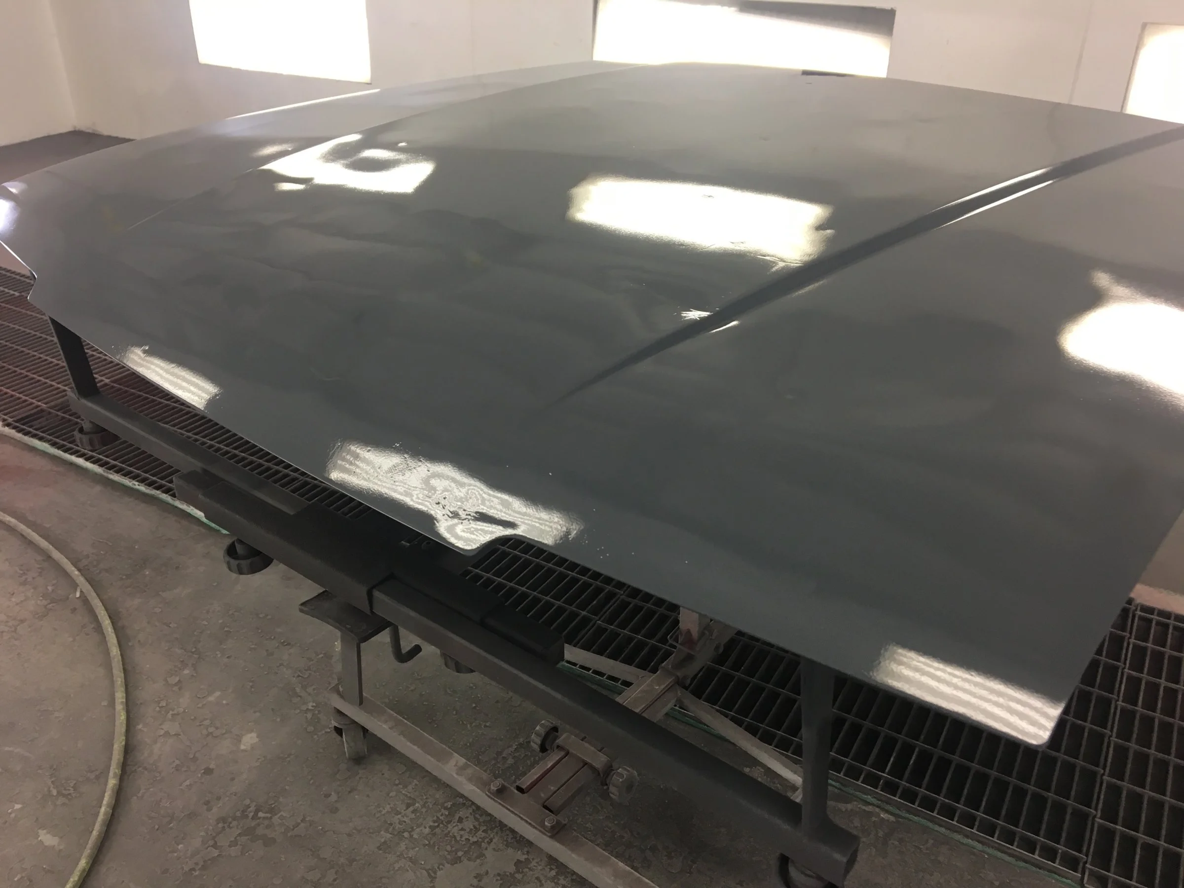

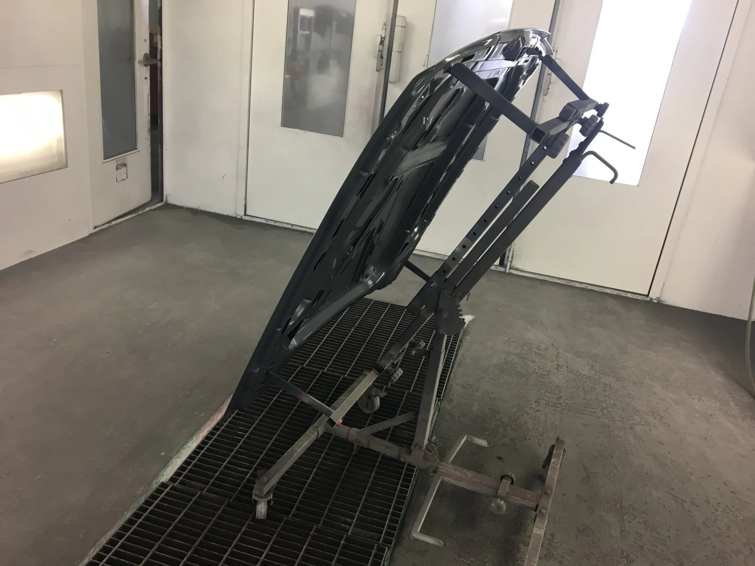

Well, I got the bastard etched and primered . It looks better in the picture than in real life.
BTW, a picture of the neat stand that allows me to spray the jambs and topside at the same time.
Does "it looks better in the pictures than in real life" mean that I shouldn't be able to see the acne on the front of the hood?

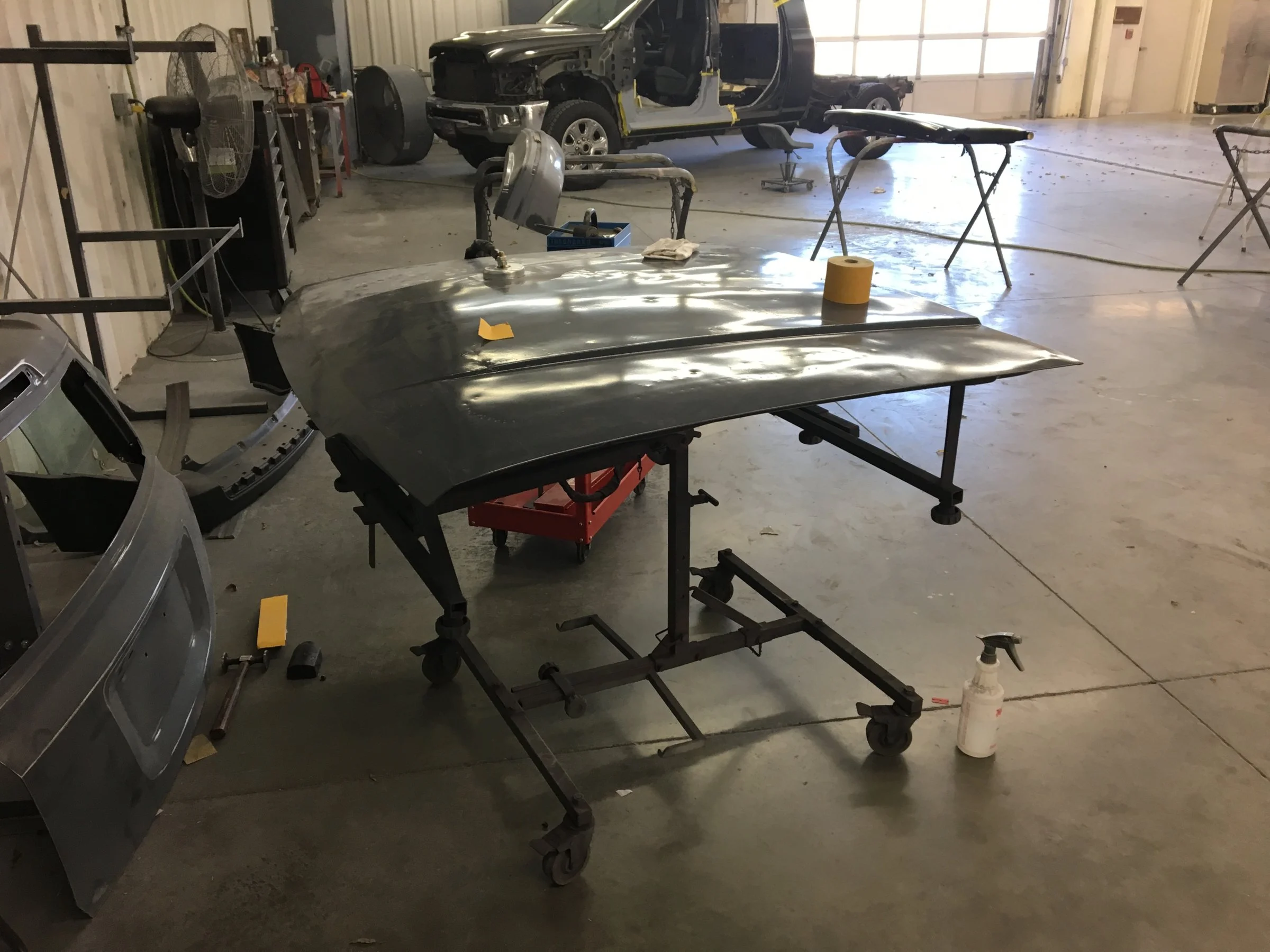

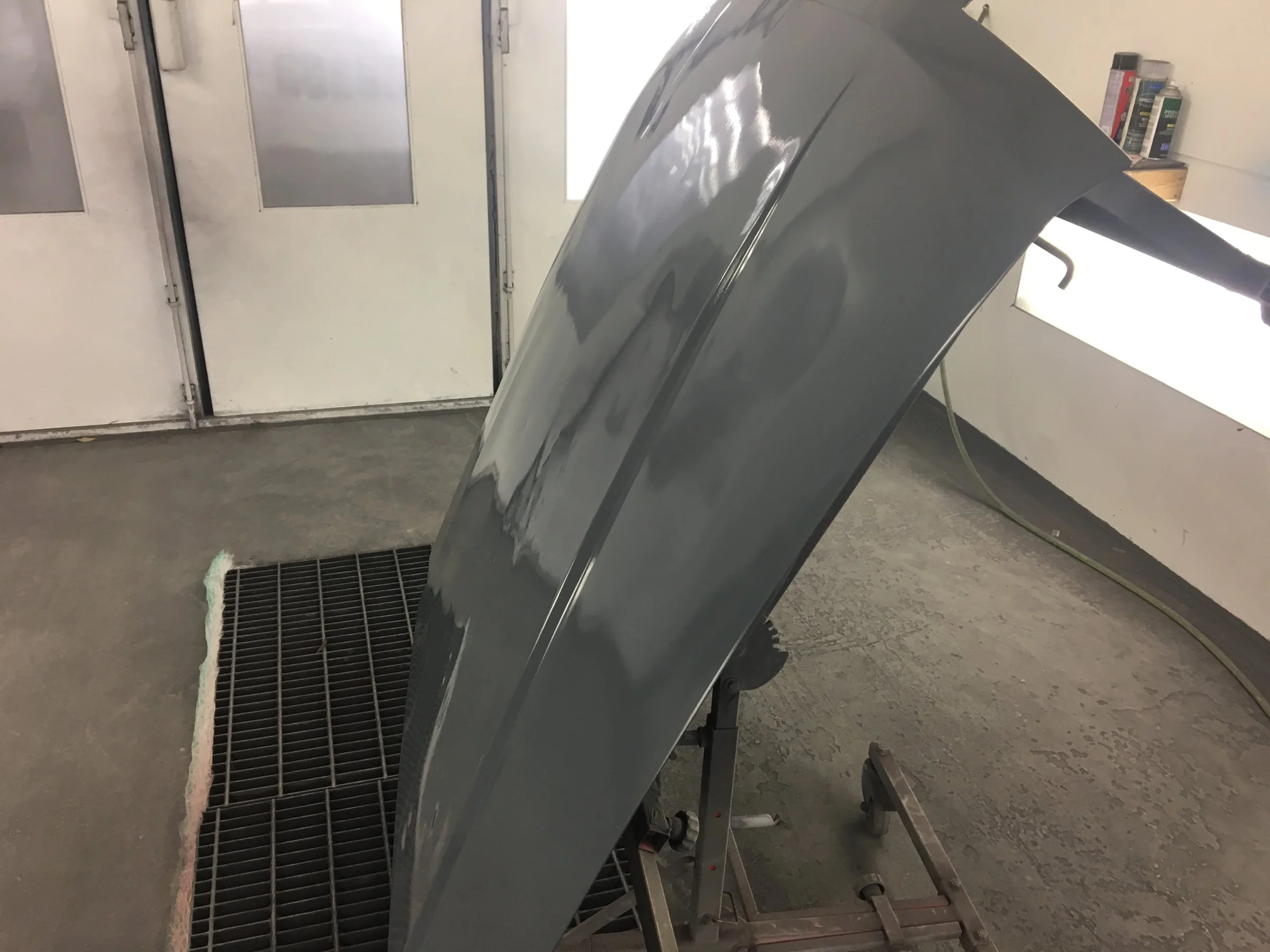

I've been working on the hood as i can, work picked back up.
Here's a picture in different light of it so you can see how bad it is. I'm getting the warping out using a shrinking hammer, pick hammer, various dollies and a couple electrical shock methods. I've about got the right side fairly straight and tight.
I have just about finished prepping the bumper too. No pictures though (that's it in the background). It'll probably be tuesday before i paint it, monday will be a busy customer vehicle day. You won't believe the difference, it looks soooo much better, really like a new bumper. I can't wait to see it painted!
