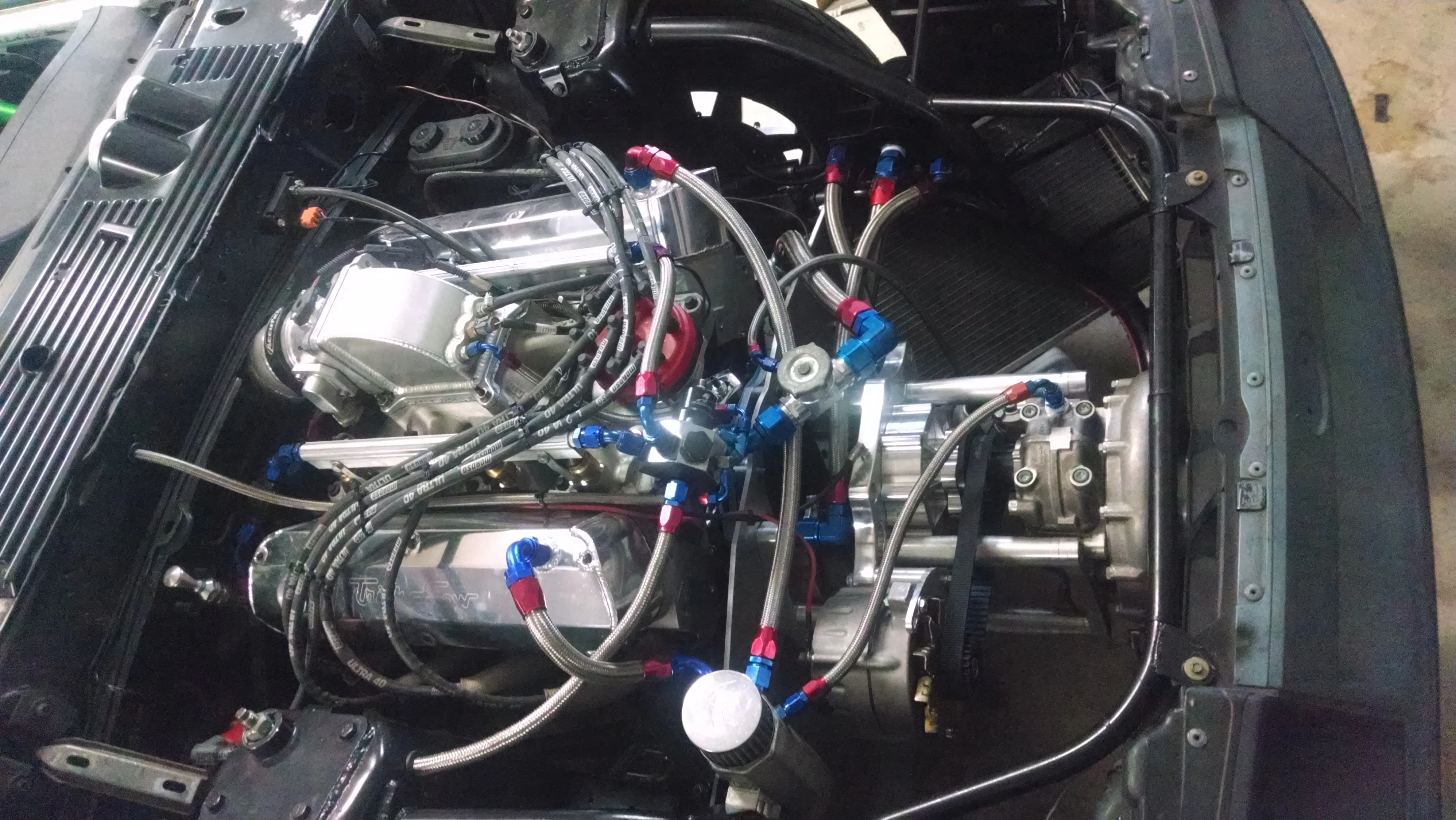

    Its hard to go by just the pulley size on my alternator. The alt is driven by the blower hub on the output side of the gear drive. It has a 1.88 step up gear set in the drive right now and uses a cog belt to drive the alternator.

    The gear drive for the supercharger has a set of gears inside of it that spin the supercharger faster than the crankshaft spins. In my case 1.88 times faster than engine rpm (1.88 step up ratio). As you can see below the belt for the alternator is driven from the supercharger input shaft. Its a little confusing when you try to determine pulley size because you need to factor into the equation blower input shaft rpms instead of engine rpms.
