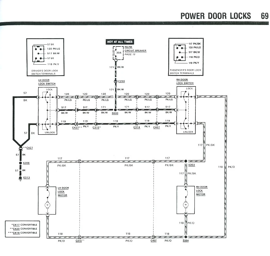

Hey guys
Just installed new lock actuators. locks were not working before install. I had removed one in the past because it had siezed up.
The locks are still not working. I have power to the switch and and switches are working correctly. I seem to have a open circut between the two switches that feed out to RH actuator and ends at LH actuator. I also ran jumper wires between switches to test my theory and the worked.
Any info on routing of the wiring or any problamatic connections. thanks
