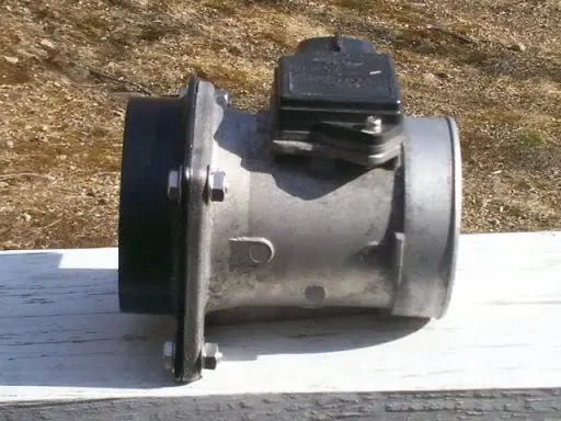

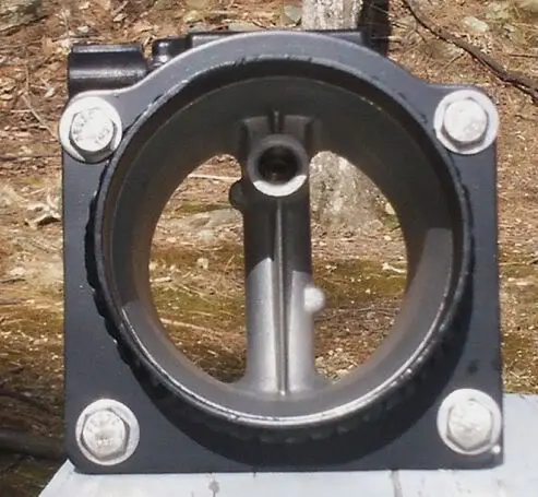

  13. Thought I would post some pics of the ebay adapter so people could get a good look. This is the v6 adapter, which is the right one for adapting this meter to a 5.0 fox.
    Adapter:
    Side View attached to MAF:
    Front view attached to MAF:
    I thinking of putting a little RTV between the two when I install it just for good measure. I'm waiting to find a stock rubber air hose to cut up so I don't have to alter mine.
  14. Looks good. Thanks for the pics!
    Is that the adapter from Kurz Kustoms? How much was it wit S&H?
    About the seal, since it's before the MAF sample tube, the MAF "should" still sample the correct air flow. But, a leak it would effect the turbulence - that effects sampling accuracy and air flow resistance. Instead of RTV, I'd suggest getting some gasket material from the parts store and use the adapter as a template.
